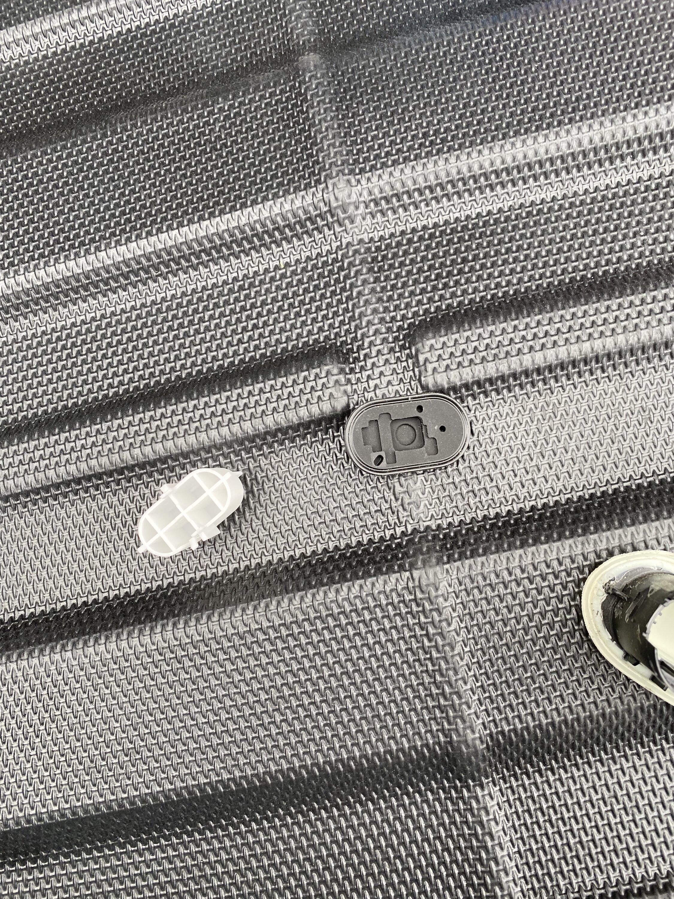

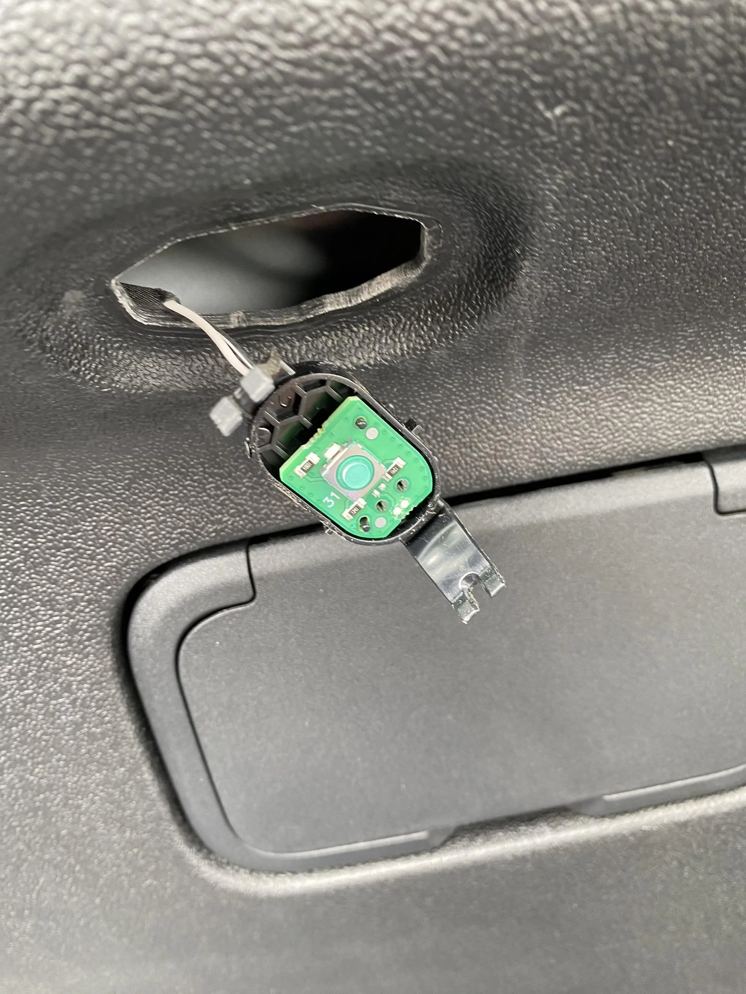

If you pry the switch out, you can pull out the white plastic piece. Then reinstall the switch.
Thanks! I’m assuming no negative effects from this procedure. I’ll give it a try ?
Apatel323
May 6, 2023
91
No issues. The white plastic piece can be reinstalled in the future. When pulling out the switch, be careful the wiring harness doesn’t detach inside the bed panel.

From the pix it looks like you take the cover off the switch to remove the white piece. Is that piece the actuating button? When removing the switch, are there any retaining tabs that could break and one should be mindful of?
