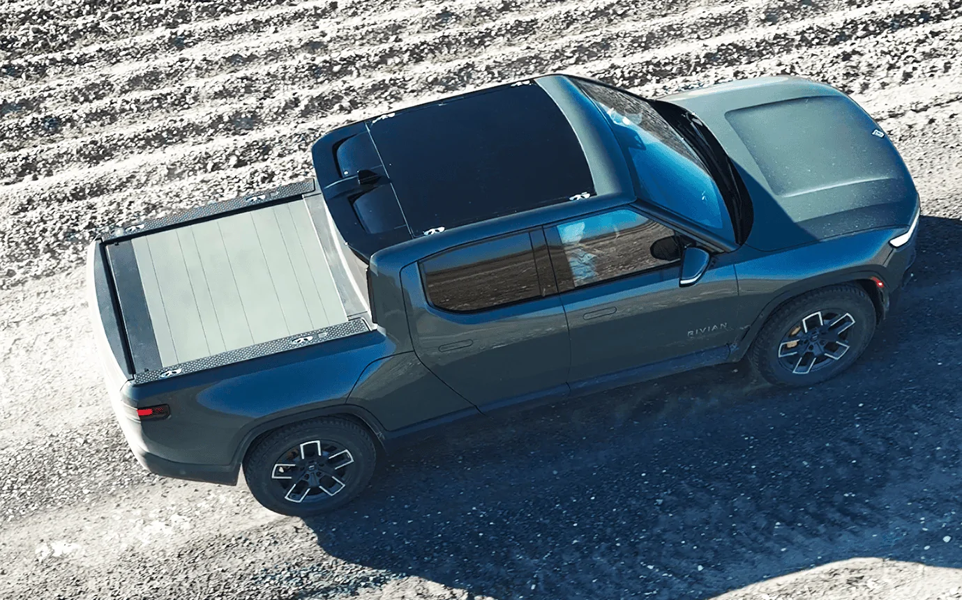

Here's mine. It's just an old piece of wood paneling we had out in the shop that happened to be the right size. To slide the panel into the rails, I took a hacksaw to the plastic end-tabs at the tailgate and cut out a rectangle section. This also lets me slide in the end panel of the original tonneau. I had a can of camo-green paint that is a close match to Launch Green that I used to paint the dark wood-colored panel. The black panel at the back is the original end panel of the Rivian tonneau and acts a good support for the wood panel piece. Going into winter, I had to do something to seal up the bed.
