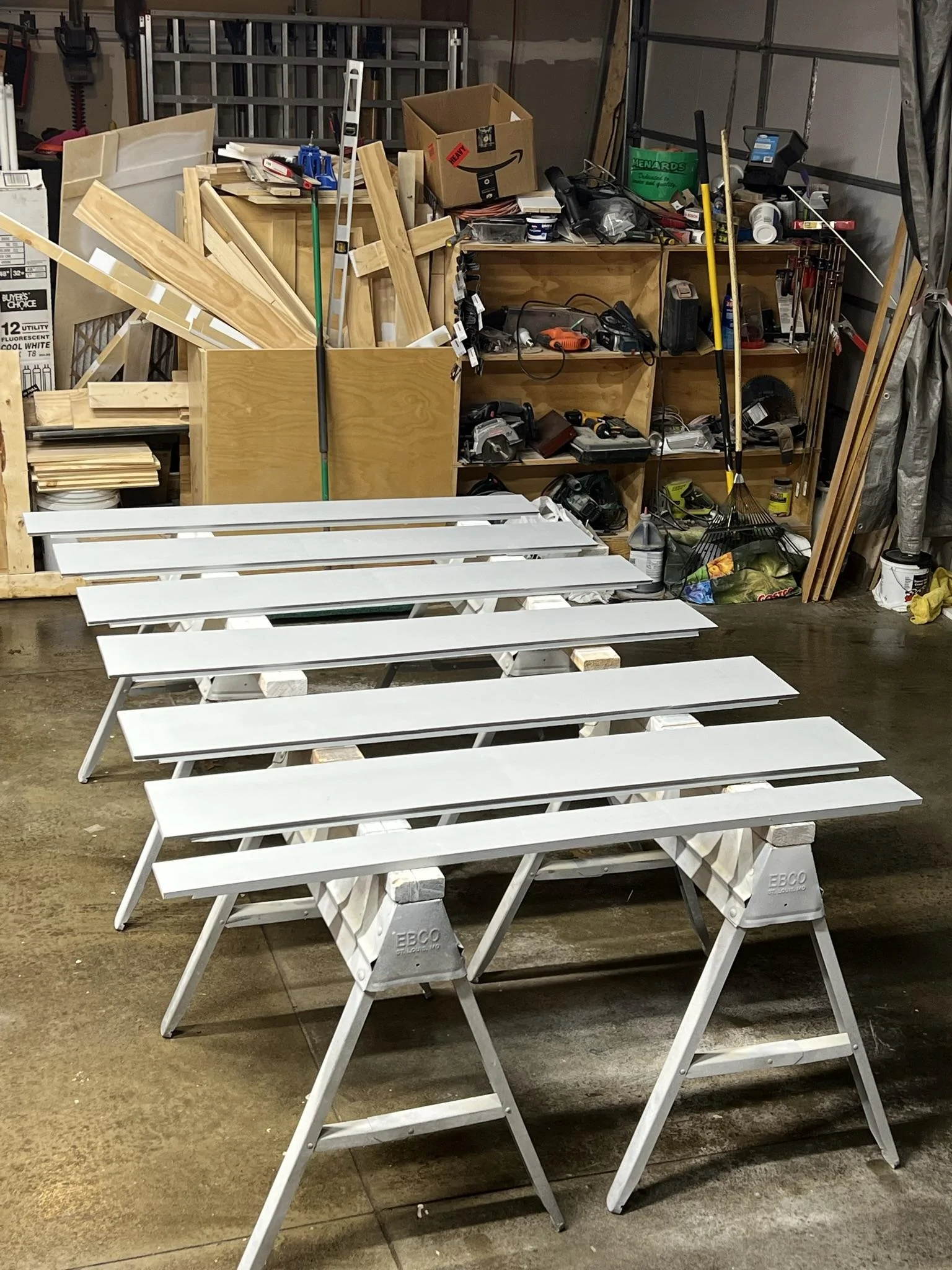

Yeah, I looked for 5x8 ply, 1/2 thick, but there was none locally and I didn't want to have to wait if I ordered it.
Finally got the painting done. Since I had to heat the garage, I wanted to make sure I could get it all done in one day.
Turned out pretty well.
I may need to do just this before my manual tonneau arrives!

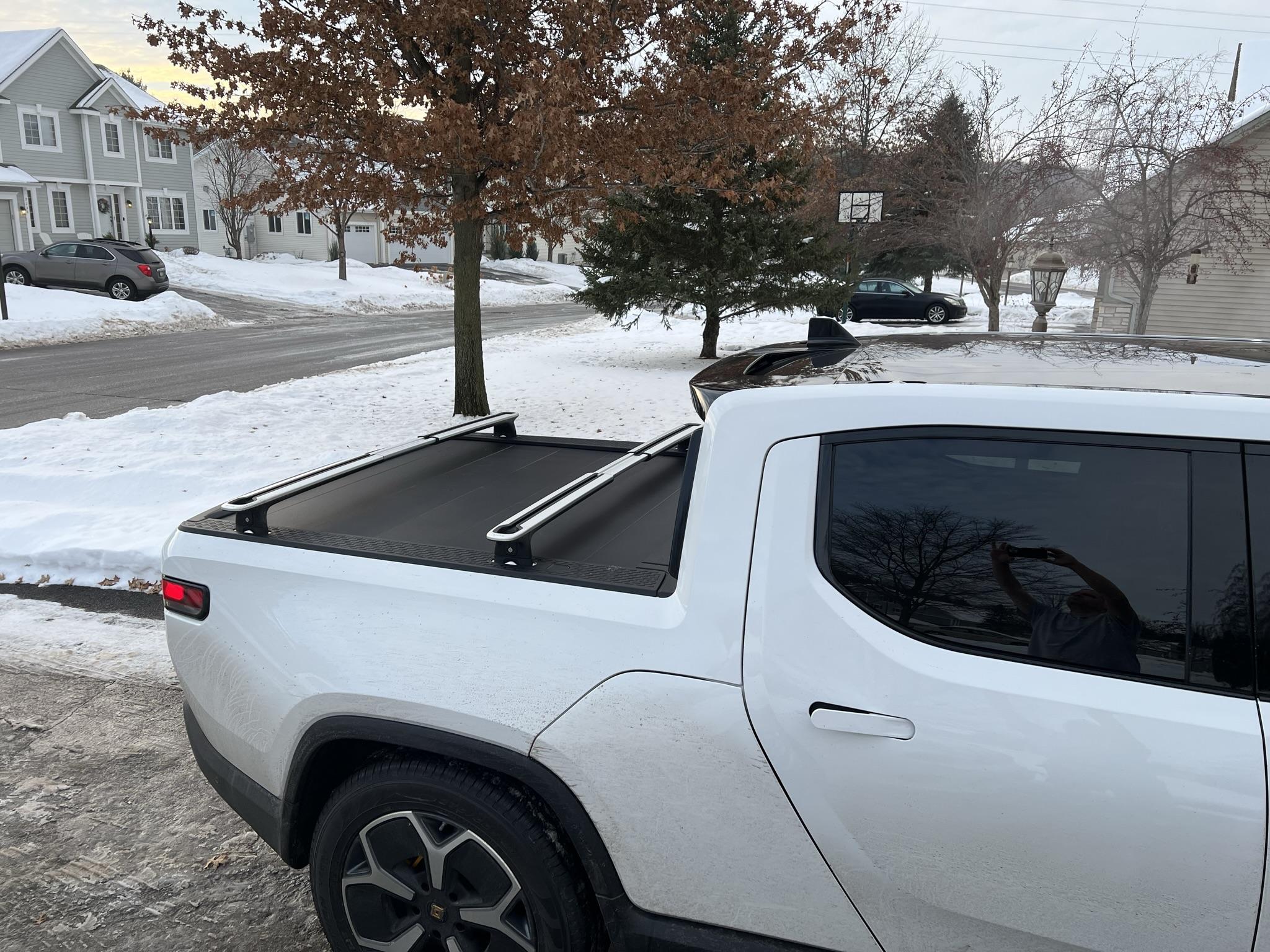

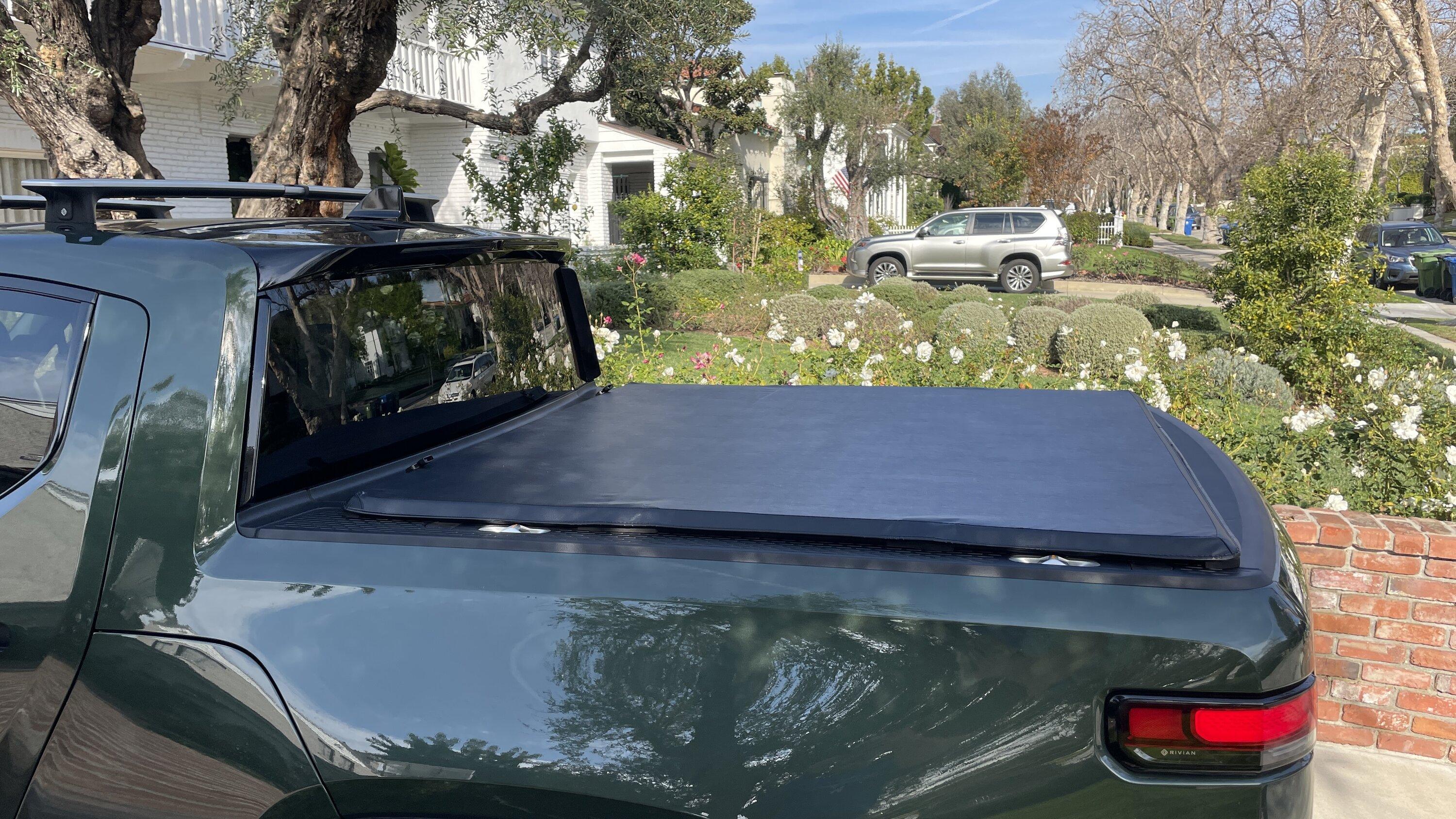

received the Maverick tonneau today from Amazon - same one as mentioned above. Used some m6 wing nuts and bought two $1.99 straps fromHarbor Freight. Ideally it would be nice if it was an inch or two longer- I feel like some water might get in.

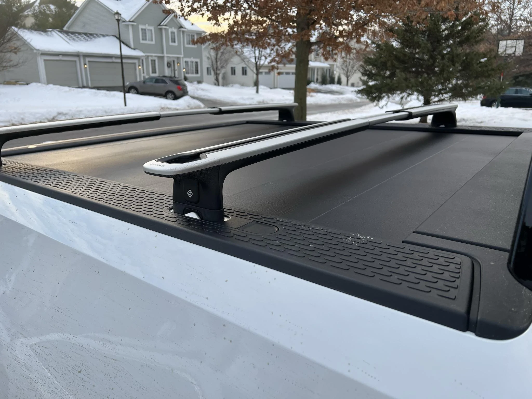

I agree, looks like a great solution. Will the factory cross bars fit with the cover on? Thanks
sjohanson
Steve
Dec 15, 2022
Atlanta Georgia

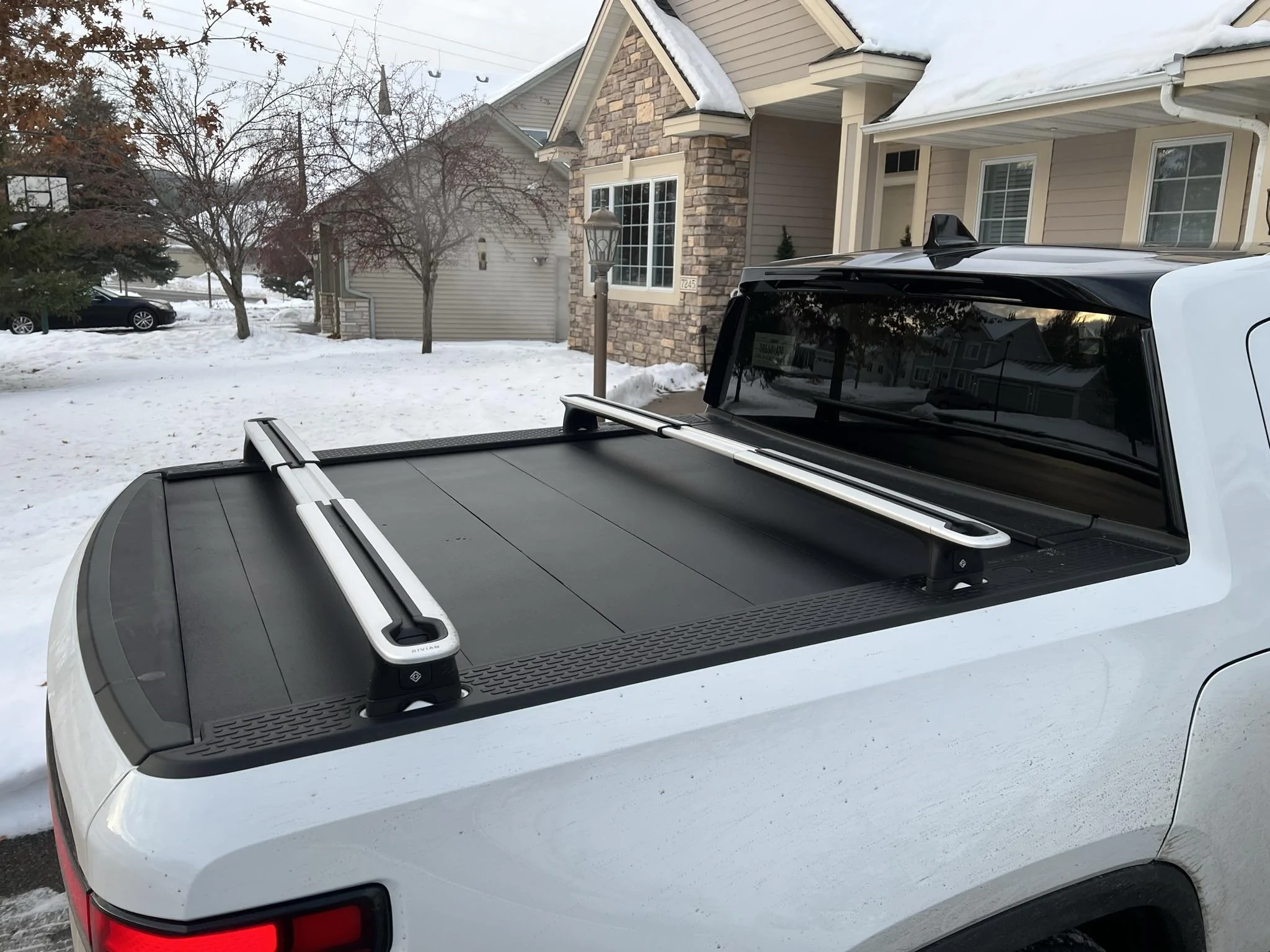

the factory crossbars will be tight but I think they will fit! I need to slide the whole cover over to the left a bit.

Thanks for the quick reply. I am very familiar with these trifold covers. They will move around and do flutter a bit at high speed. I could only ever hear it when the back window was open on my Ram. Not an issue here without an opening back window.
So far mine has worked really well, no movement, pretty much watertight from rain and very solid at freeway speeds.
Great news. I have used a trifold for years on a Ram truck. It was pretty watertight and only fluttered a bit at speed. I had a rear opening window and it was only noticeable when the window was open. Not a problem here.
Nice job!

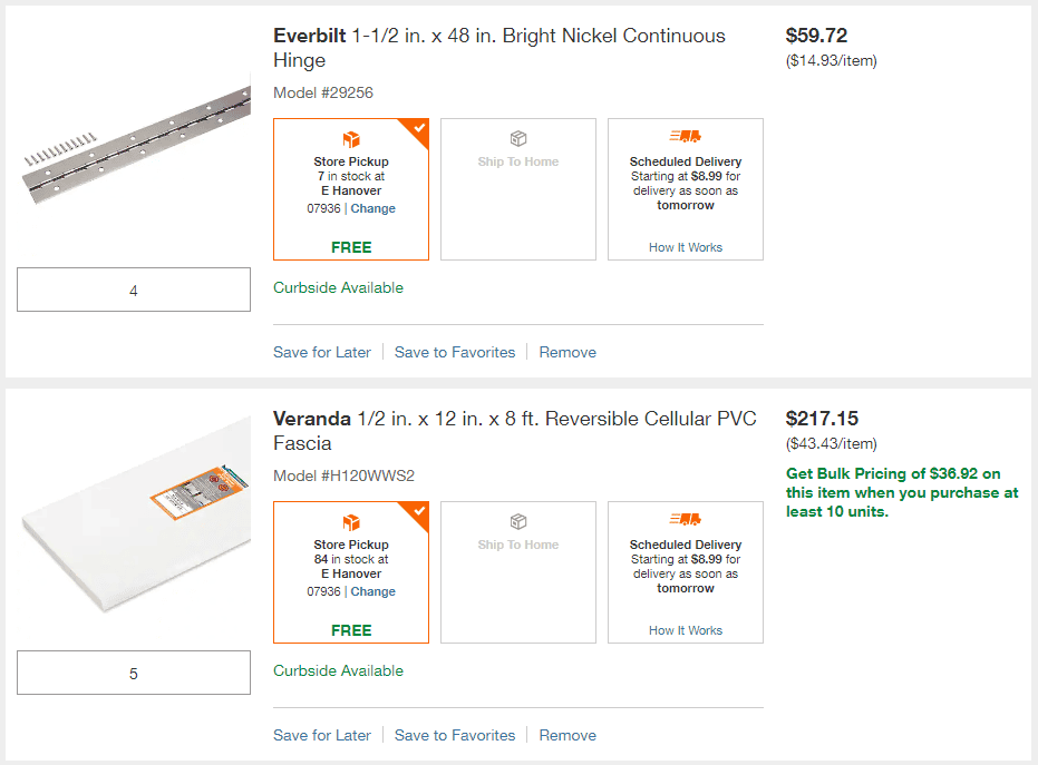

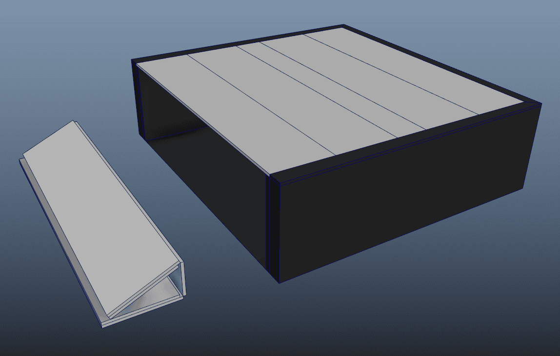

My plan for a temporary manual cover will be to use Veranda Cellular PVC Fascia boards, 1/2" x 12" and 48" continuous hinges. Here's the design, which folds up for gear tunnel storage. My truck is white, so no need to paint.

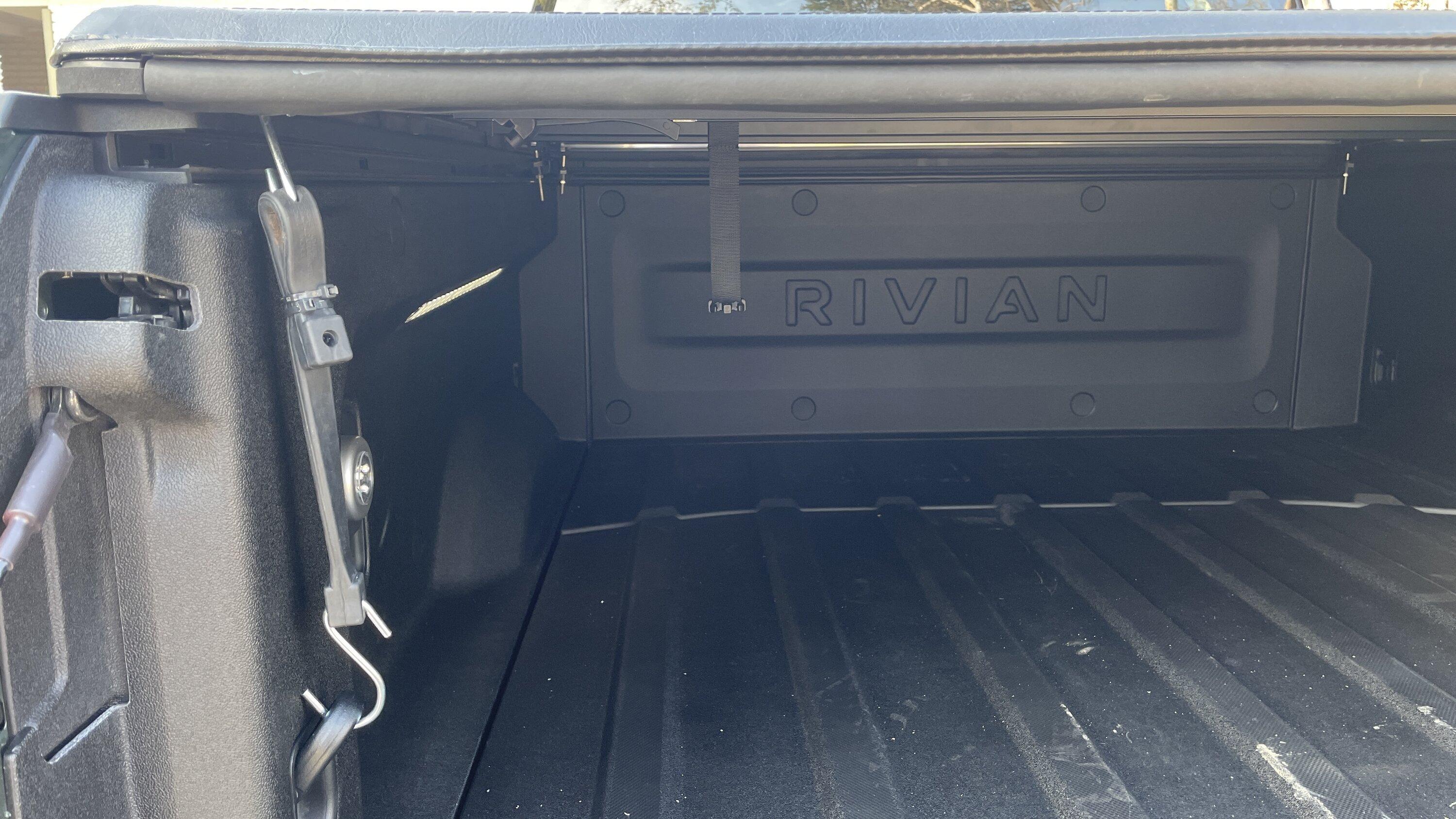

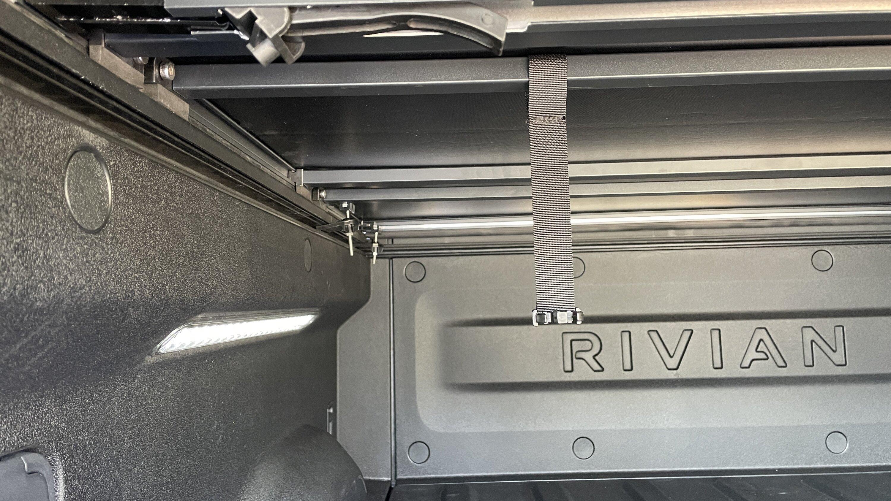

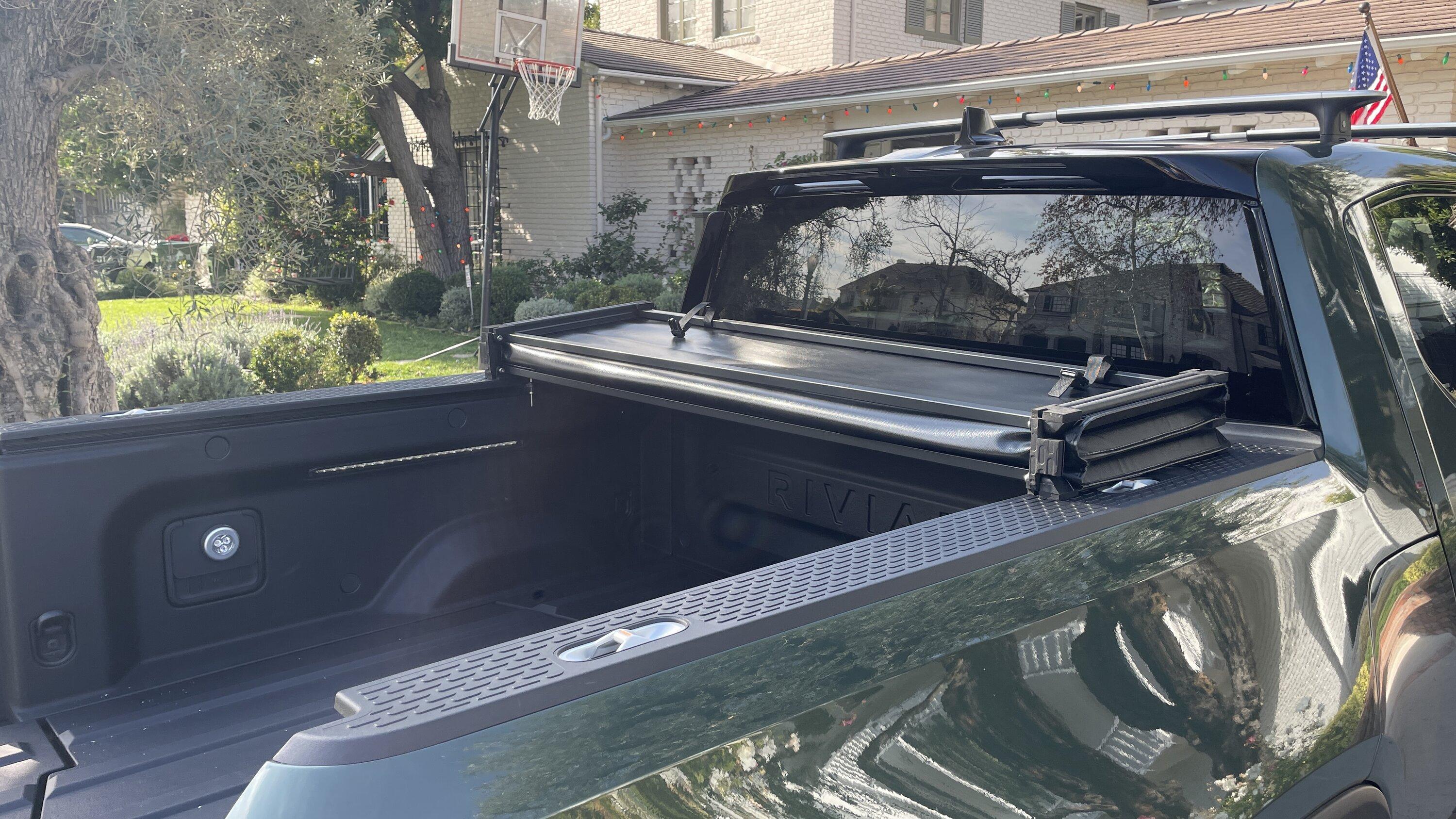

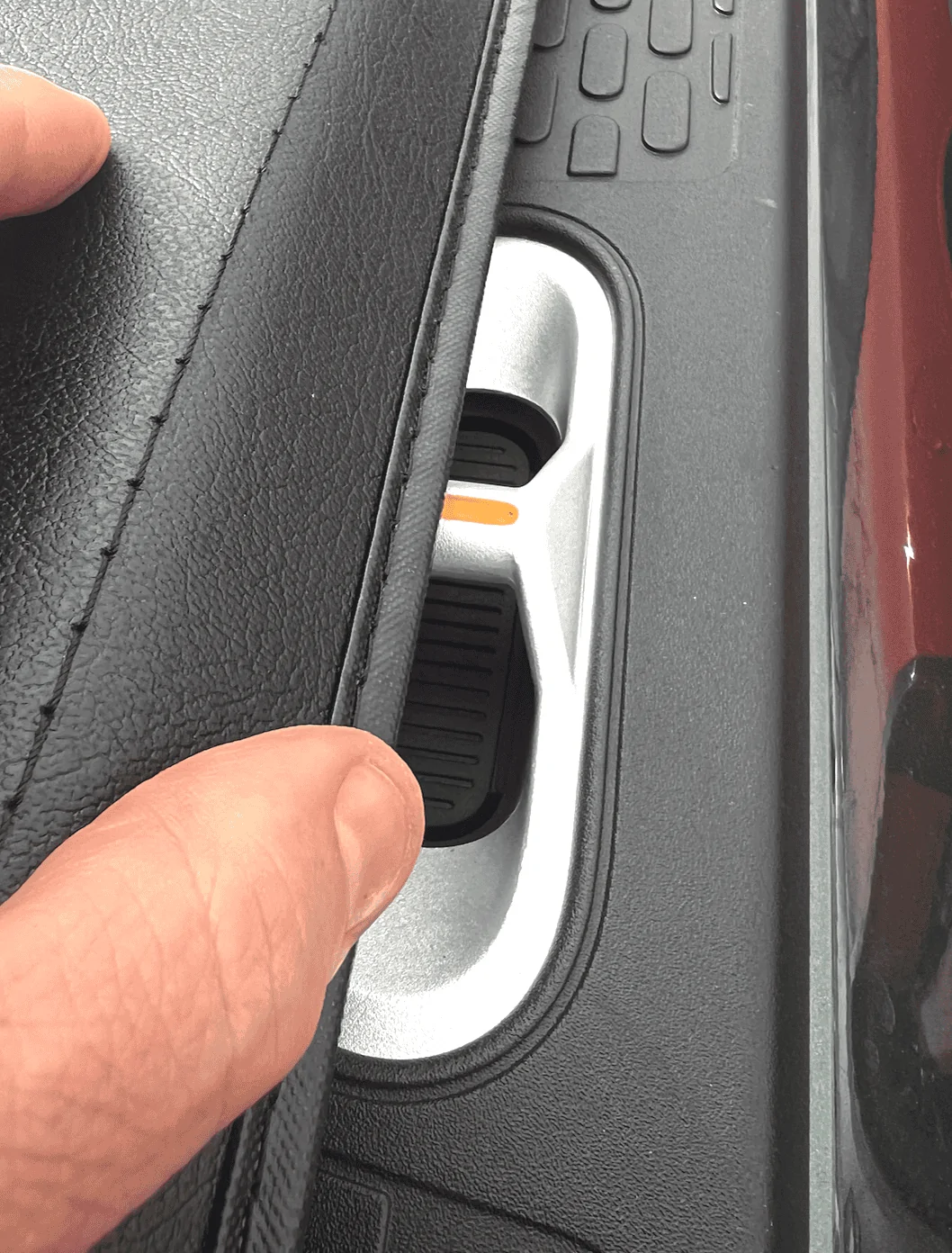

Hi, just got my R1T and it had no cover at all. Here is what I did:
Bought a 228 dollar Ford Maverick cover off Amazon, https://www.amazon.com/dp/B0B3MGFX2Z?psc=1&ref=ppx_yo2ov_dt_b_product_details. You need to modify install a bit,
You use the cover "tunnel" to mount/slide the brackets into and screw down the cover.
Replace the included wing screws (they are too wide for Rivian side plastic mold) with M6 nuts.
I flipped the included brackets upside down to get tighter grip
The back locking bolts won't work because they hit the plastic side of the Rivian bed, so I bought two heavy duty Bungy cords that locks the back. works like a charm.
