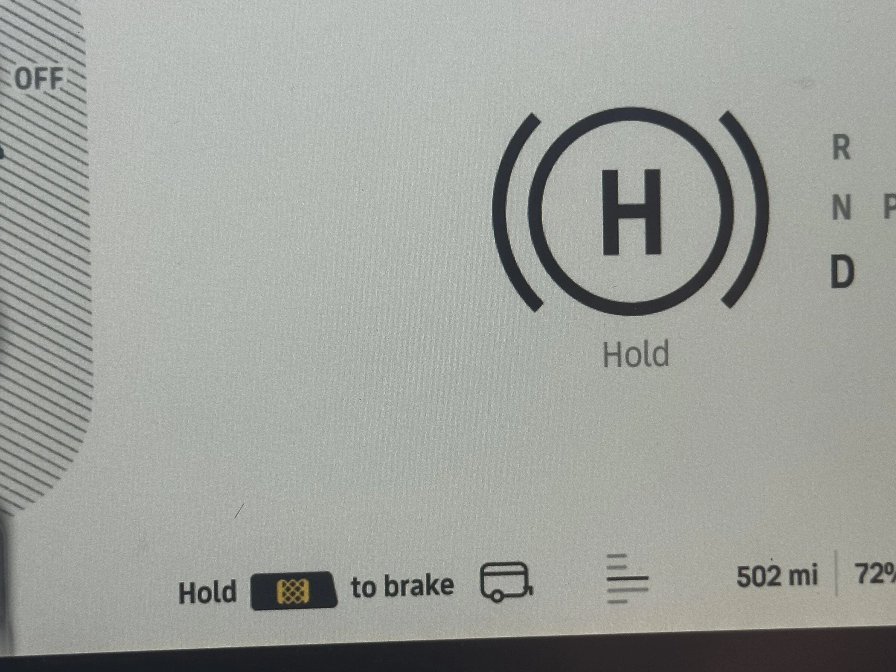

Does anyone else get Bizaar Range estimates while Towing?
Rivian R1T R1S Does "Towing Mode" reduce range unnecessarily? IMG-0319
