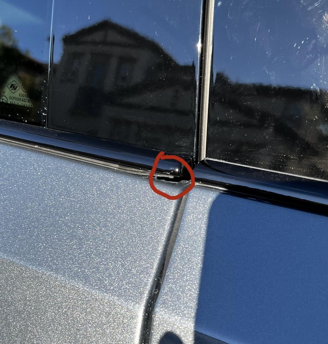

On my R1S I noticed this hole in back right passenger door underneath the weather stripping that started to lift. It seems to me this could be a water intrusion point.
Rivian R1T R1S Draining the *&@(#!*& doors IMG_4075

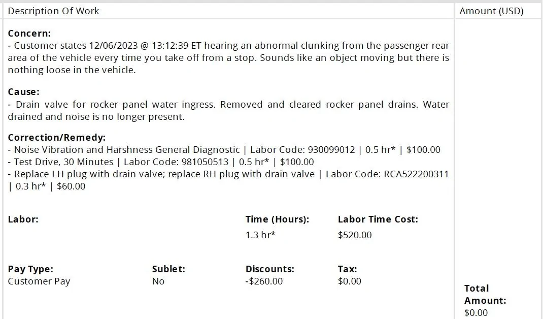

This is what service did for mine, this week:
"Clunking" is their word. I told them I heard a dull thud, or bass drum type of sound.
Rivian R1T R1S Draining the *&@(#!*& doors Rivian
