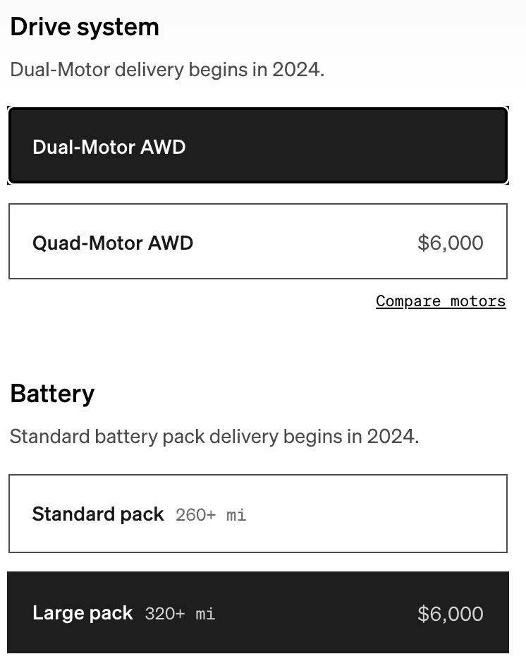

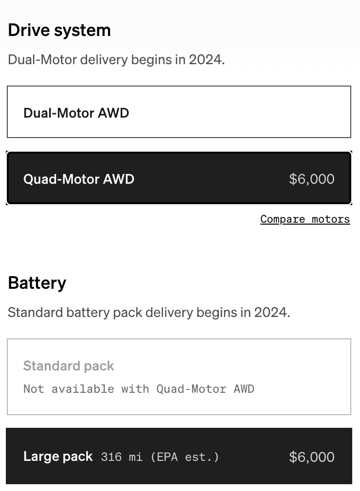

Anyone know anything about potential range increase from dual motor setup v quad motor?
Yes. For an R1S with large battery pack, dual motor will get you at least an extra 4 miles of estimated range.
