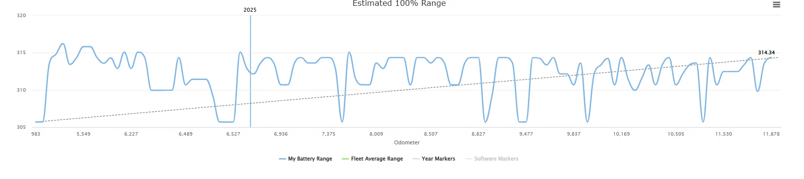

Back to either the December or January update they started doing something goofy with the reported battery capacity as evidenced by ElectraFi data on the battery graph. That change resulted in some weirdness on reporting phantom drain. It's possible this update reverted that change, but I don't have enough data yet to be able to tell. That said, I haven't seen any major change in efficiency that I can't attribute to dramatically warmer weather and using HVAC with temperature control turned off.
Where abouts can I find similar data in ElectraFi? We can see if it tracks with yours.

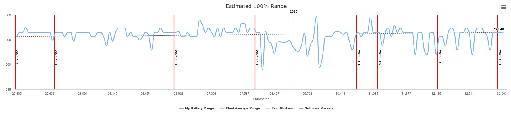

Under Charges and then Battery Report. It doesn't track battery capacity directly, but you can see that on the top bar with all the other current status items and if you watch it enough you'll see it dip and rise seemingly at random, but seems to be correlated at least somewhat on outside temperature or possibly battery temperature. IIRC, I've seen as low as 125 kWh, but prior to the update at the end of December 2024 (2024.47.1) it was always within a small range 130-131 kWh.
Interesting. I don't have software markers in mine.
