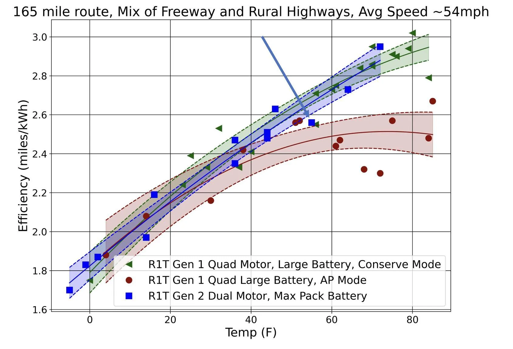

Did the efficiency increase with the most recent update? Based on my testing I think the answer is clearly no. My most recent trip is denoted with the blue arrow. It's actually a little bit worse but the wind was a bit high. Will continue to monitor but I would be very surprised with it had increased.
Rivian R1T R1S Efficiency boost from 2025.10 update? Anyone else seeing this? Screenshot 2025-04-18 at 9.41.34 AM

This feels really weather related. Have a look at this data from yesterdays commute on my truck. 37.8% efficiency increase from my morning drive in to my afternoon drive home. Nearly the same deltaT you had 43degF in the AM, 63degF in the PM. Sure feels like a temperature related change from here.
Here's what my truck shows from data collected on ElectraFi regarding temperature vs efficiency. Right at a 10% swing in measured efficiency difference when comparing the 45deg to the 61deg segments. Not nearly as dramatic as our recent commute data would support.
Any data on your battery temps? Motor Temps? Tire Pressures? Assuming the same route to/from the office as well. Any thoughts on average speed/traffic issues that might have contributed?
I've found efficiency is more closely tied to motor temperature and tire pressure than battery temp. I've seen over 2.0mi/kWh with motor temps over 100degF, and tire pressures over 50psi, while battery temps were still under 50degF. For instance, driving in snow mode for the first 10mi or so will warm both motors, then switching to all purpose on my dual will drop the rear motors and get the highest efficiency. This seems to be much more important than battery temps in my experience.
I've also let the tire pressure drop into the mid 40's, and efficiency drops quick. I try to run around 50psi in mine and that seems to be around where the "sweet spot" is. Any more and the ride is garbage with no real increase, any less and the efficiency drops significantly. Mine will swing 3-4psi in the winter between sitting in the driveway and 20mi of interstate driving. Maybe you're right on the cusp here?!?!
Anecdotally (and I've only had the truck since Sept 30th), I've seen well over 2.0mi/kWh for long durations a number of times. Again, typically on road trips once the motors/bearings/etc are good and warm. Made 3 road trips now, 2 to KY and 1 to PA. I'll go back and consolidate the trips and see if my data backs up what I 'feel' like the truck is doing. My gut is telling me that 2.0mi/kWh isn't absurdly out of line with a warm truck with good pressures. You're 1.5-1.8 numbers "feel" like the cold weather numbers I was seeing in the dead of winter this year.
I would have to go back and dig through a ton of data, but I'm wondering if that 50degF range is the "tipping point" to drop us in to lower efficiency numbers. That is to say the 20deg swing from 40 to 60 is of greater importance than the 20 deg swing from 60 to 80, or from 10-30?!?!
Just a thought on motor temp observation above. I know my dual motor truck has oil bathed motors (not sure about your quad), and that would support the above theory. Viscosity isn't linear with temperature, and it thins much quicker in the "lower temps" than it does at higher temps. Pulled the below chart from Engineering Toolbox that corroborates that thought.
Love this kind of discussion. Thoughts?!?!
Your average speed on the first run was 58mph. 50mph on the second. That will account for more of it.
