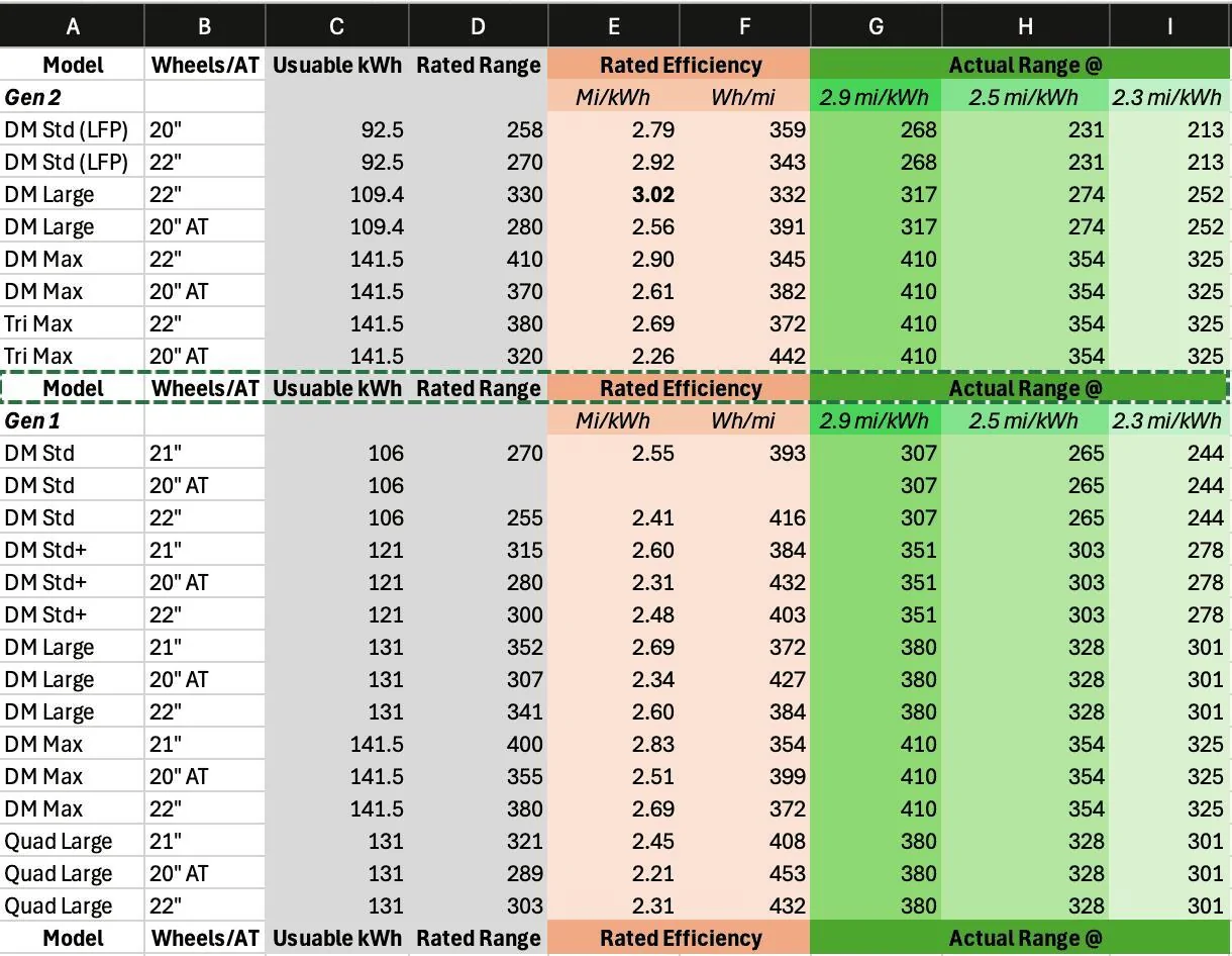

Reference chart I made for efficiency of Gen 1 and 2. All Gen 2 EPA range numbers are very optimistic, the large pack most egregiously so:
I think Trimax with 22" is rated at 370, not 380?

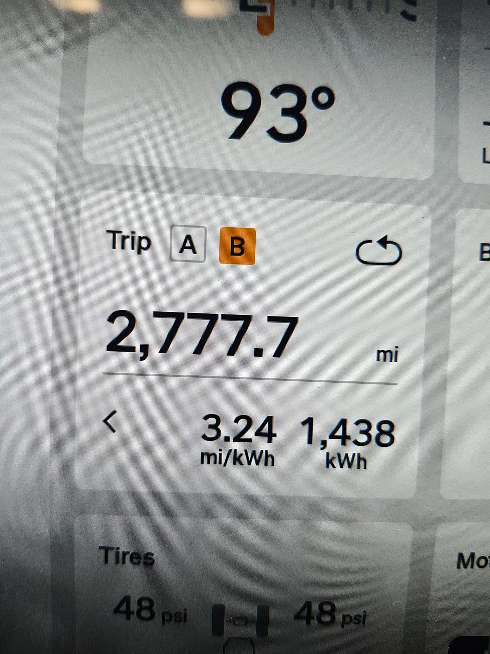

Yes, how it's driven. My performance dual motor large pack R1T.
What am I missing? How does this vehicle calculated m/kWh? Seems to me, if you drive 2777 miles and consume 1438 kWh, your actual m/kWh is more like 1.9, not 3.24.
7,414
12,704
It is all in driving style. If you are going arounrd 50 to 60 mph in ideal condition, you can get very close to it.
A lot of truth in this statement. When I was in MA a few months ago driving around on the back roads in the 35-50 mph range I was getting close to 2.7 m/kWh in my G1 quad. Can’t get close to that in SoCal where all the road are open with speed limits north of 50.
Well energy goes to more than just the motors and yes I do t see anyway you are actually averaging 3.24 unless you drive very slow and steady.
