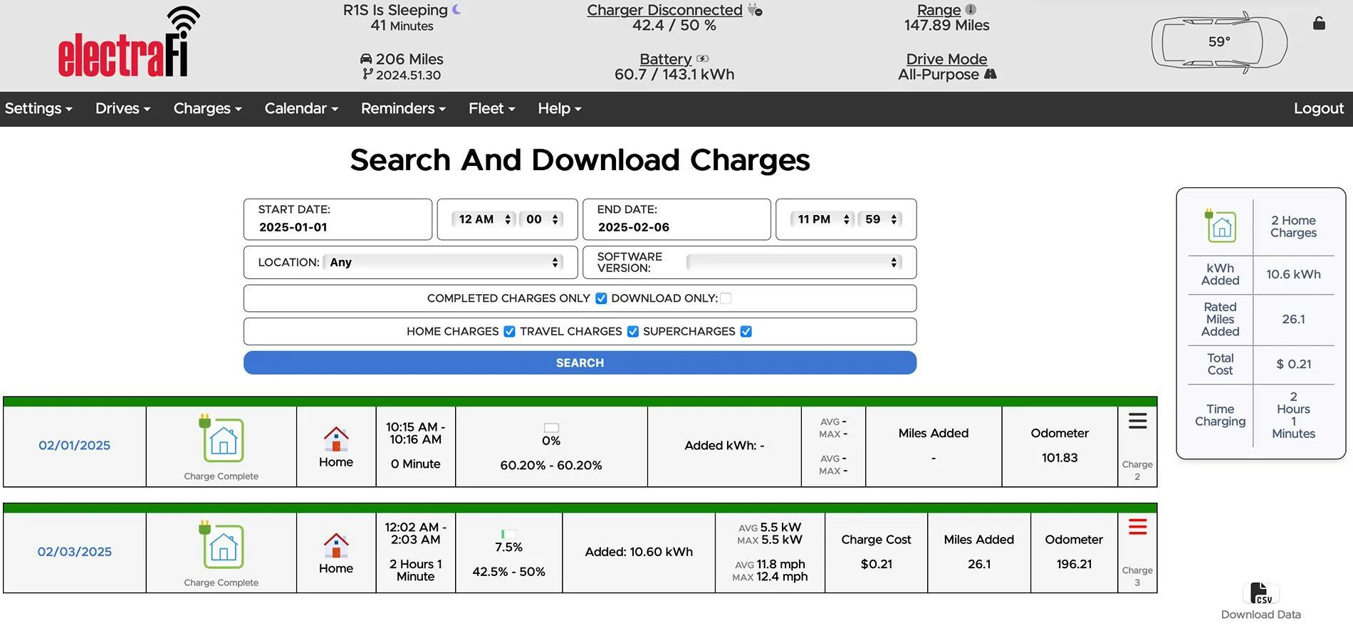

Thanks. Makes sense. The SC was a 9 minute session and the home session was 2 hours. What doesn't make sense is I plugged it in briefly at home to make sure L2 charging worked. This was about a 20 second charge and Teslafi logged it.
Rivian R1T R1S Electrafi (Teslafi) now available for Rivian Screenshot 2025-02-05 at 9.14.46 PM

That is odd. I'd try another fast charging session. I've used it for years with Teslas and 4 months with my Rivian and I don't ever recall having it miss a charging session. Sometimes it is so annoying when it captures one where I just plugged the truck in and it started charging while I was trying to set the schedule for another time.
