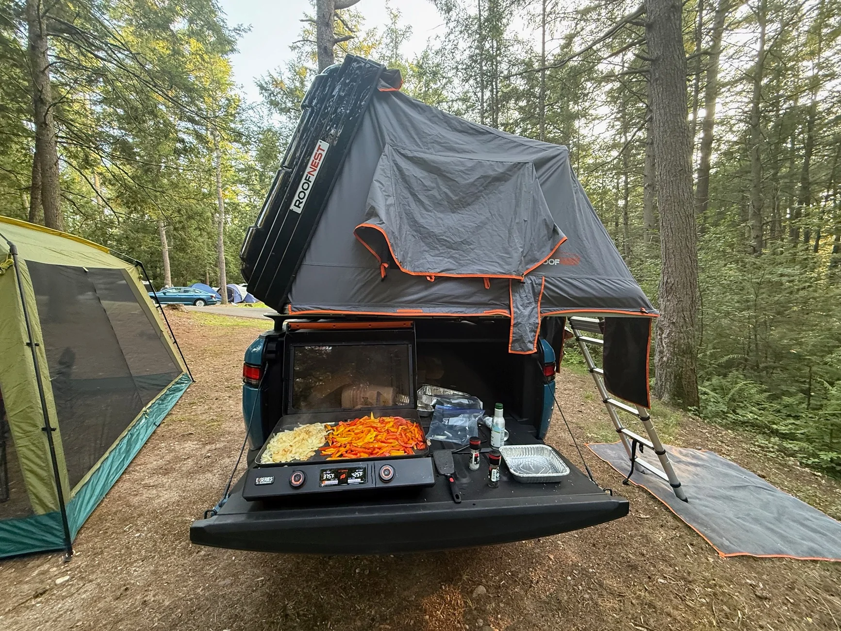

The gridle worked great. Great for onions and peppers for sausages and pancakes for a big crowd (15). Increased the temps at a reasonable pace with no problems.The meter wouldn't fit in the outlet, so I'll return it. Or at least I could not figure out how to remove the outlet cover without breaking it. Would need a meter that is 'upside down' compared to the other.

The gridle worked great. Great for onions and peppers for sausages and pancakes for a big crowd (15). Increased the temps at a reasonable pace with no problems.The meter would fit in the outlet, so I'll return it. Or at least I could not figure out how to remove the outlet cover without breaking it. Would need a meter that is 'upside down' compared to the other.
Thanks for sharing - looks perfect! I had a similarly full griddle when doing patty melts at a tailgate last fall...Toasting rye and keeping my browned onions warm on the left side at 325 while doing the smash burgers at 450 on the right. It worked really well. I still owe @COdogman a patty melt...
