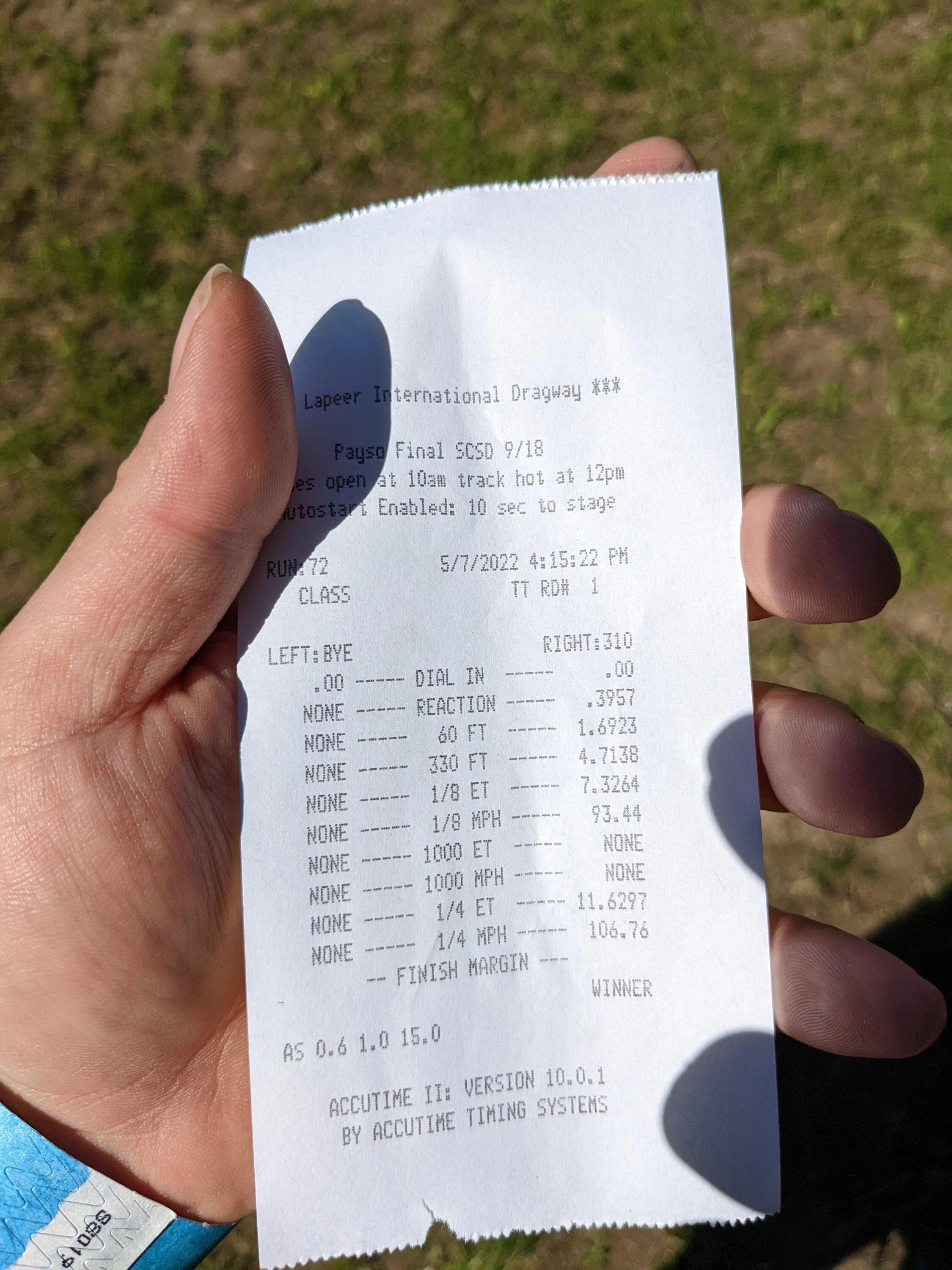

147
13,522
27,291
I have nothing to compare for 0-60 times. Sixty foot times for the ICE’s were slightly worse to slightly better from a R1T estimated Sixty Foot time of 1.8 seconds. Turbo’s launched smoothly and slower but made it up on the big end.
Rivian R1T R1S Electronic Nannies limiting Acceleration PXL_20220507_201607025
Not my fastest pass, but best 60 foot time.
SeaGeo
Brice
Jan 12, 2021
5,673
10,212
Xc60 T8
147
13,522
27,291
Is the 60 ft time adjusted for reaction time? I'm assuming so...
Timer starts after you've left the beam, same as the other distances.
