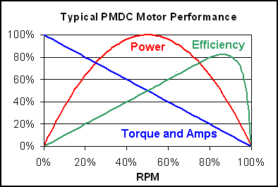

That's also a function of a permanent magnet DC Motor. Granted, we don't know much about the motor hardware or how the software is controlling the power to the motor. But we know it is a permanent magnet DC motor so some basic principles must apply. As the curves below show, torque decreases as RPM increases.
Not sure what that set of curves is supposed to represent but it isn't a PMSM motor in a BEV. In that application torque is constant at the maximum allowable level (breakpoint slip) from 0 rpm up to 60 mph (the "torque limited region" giving best 0 - 60 acceleration) and then declines linearly with speed above that (the "power limited region") holding the power at the motor's maximum rating above that.
"But we know it is a permanent magnet DC motor so some basic principles must apply."
"As the curves below show, torque decreases as RPM increases."
-- Correction - AC motor
As I stated, It is a representation of the basic principles of a PM motor. I didn't state it was a representation of a PM motor controlled by a programmable inverter in a BEV.
My point is that the OP "complained" about drop off in power at higher speed. That's a fundamental feature of a PM motor, that's what the graph is illustrating in a basic PM motor.
I also stated we don't know "how the software is controlling the power to the motor" which is what really defines the motor's performance characteristics in a PWM application.
