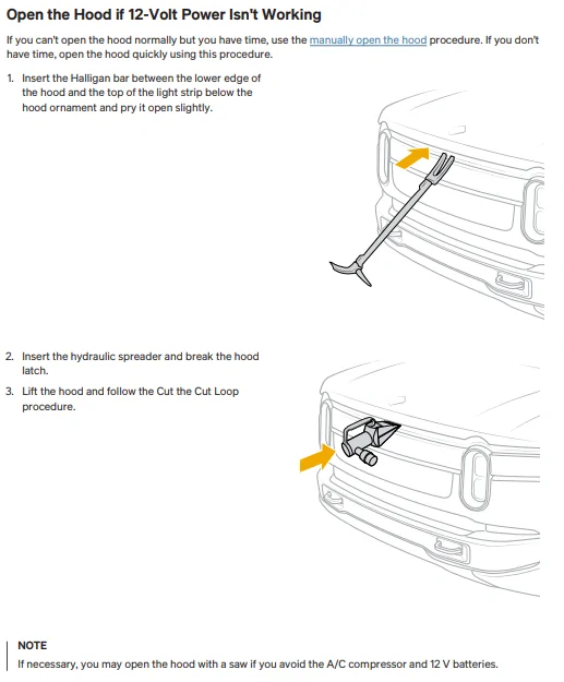

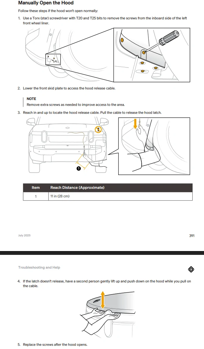

This is the process for manually opening the hood to disconnect the 12v:
Rivian R1T R1S Escalating service request?  Advice Please!! Screen Shot 2025-08-21 at 13.40.56 PM
