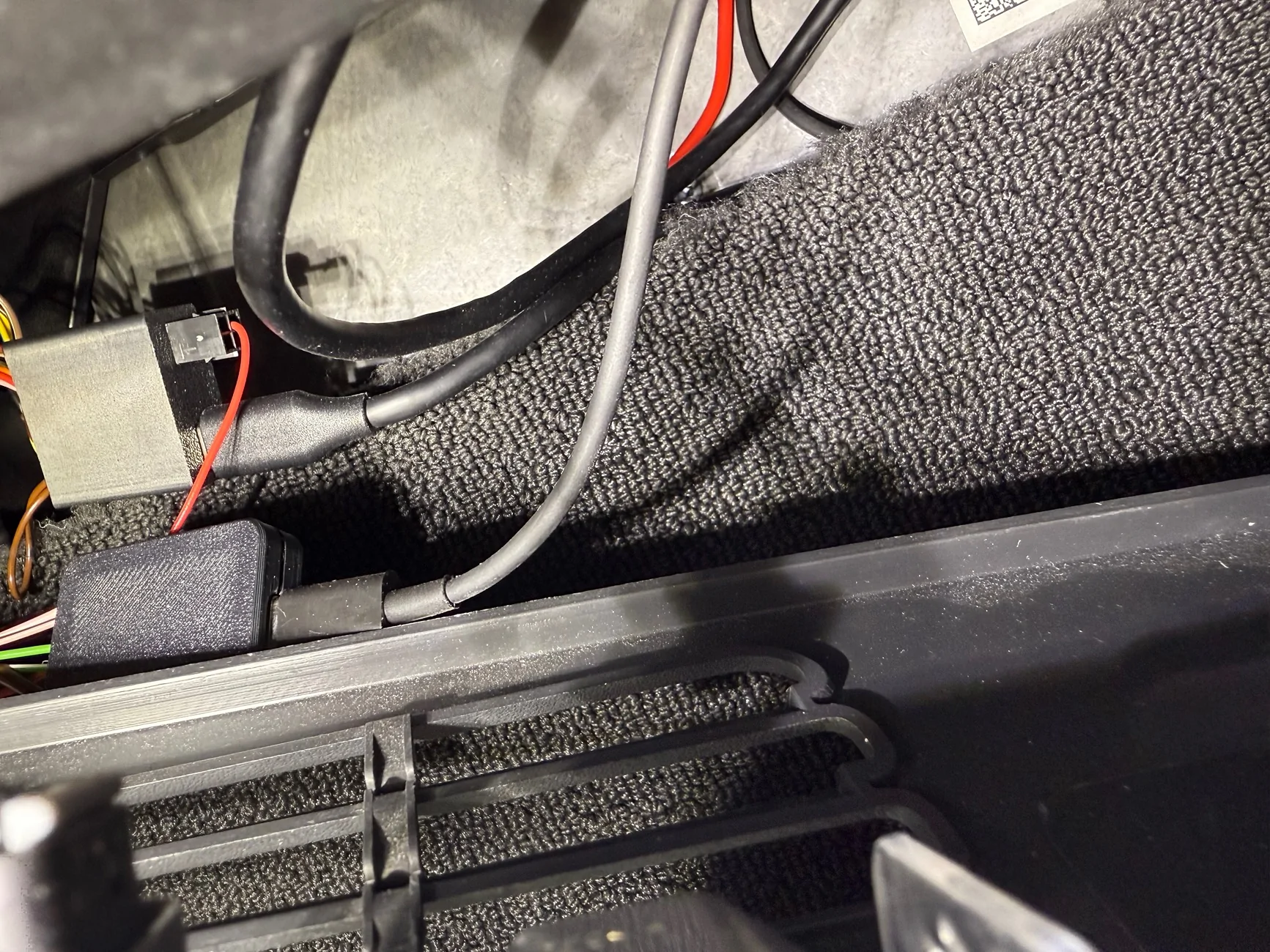

This is the picture I took this morning. It looked correct on your end
It's looking like MTB's issue might be a bad harness. We're looking into it.

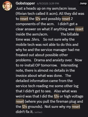

I wouldn't even try to explain it. Just tell them you're having sensor errors. One of our other users who was having this issue had a mobile tech come out and do some sort of 12v reset and cleared everything right up.

HV/12v reset last night. Truck behaving entirely normally. Will try to re-install each of these products with some time separating each again soon.

Glad to hear the HV/12v reset did the trick! Let us know how it goes.
