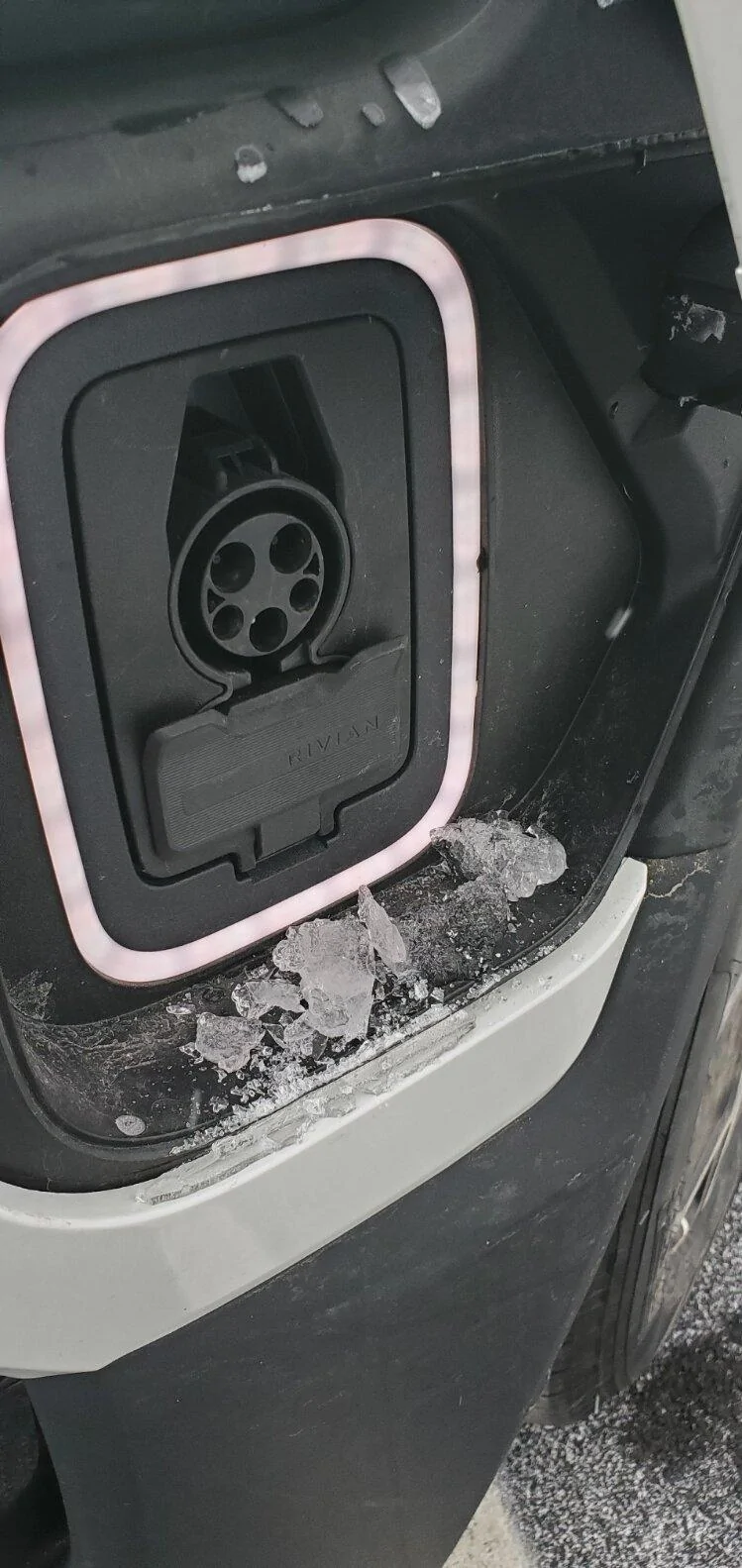

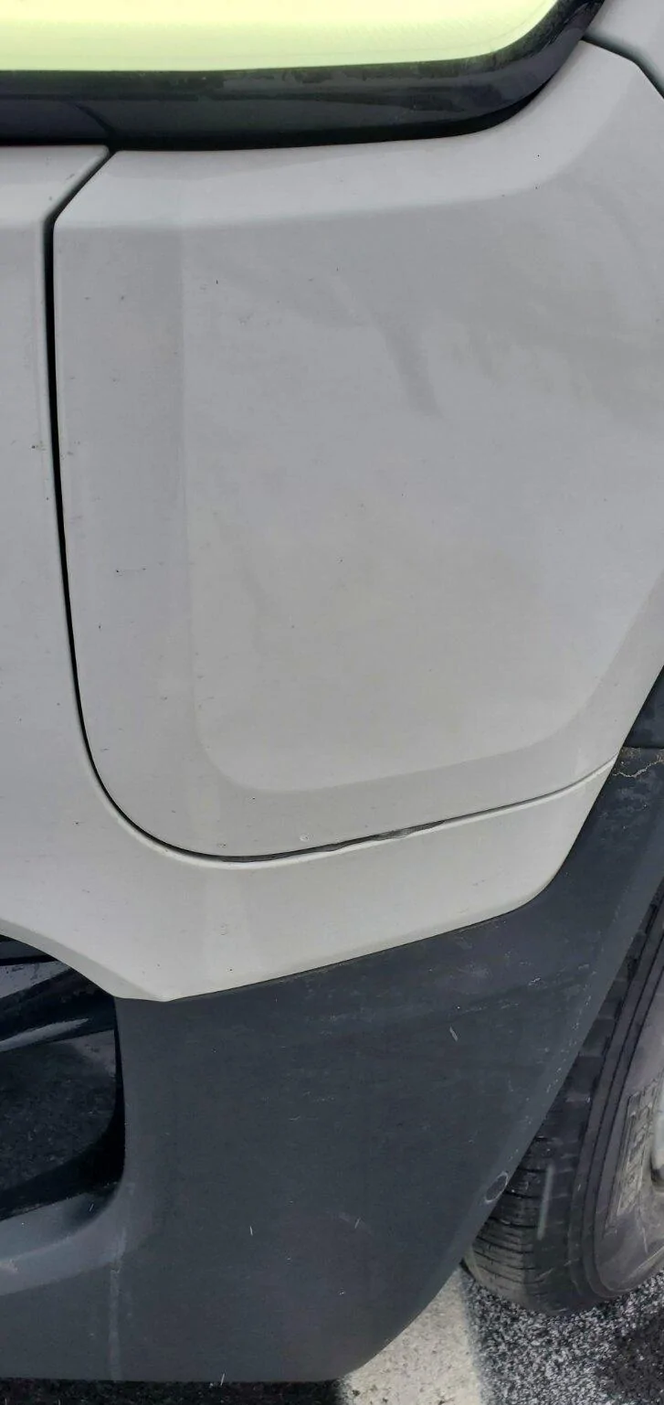

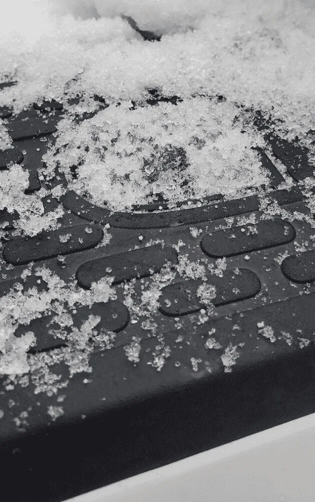

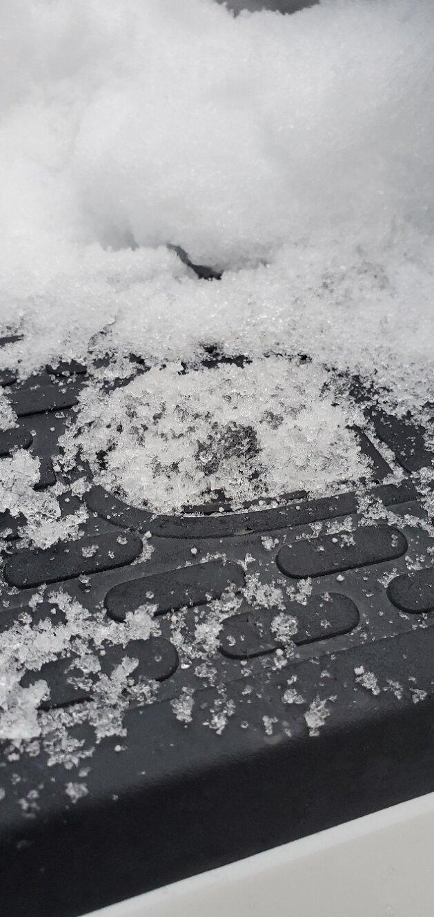

My charge port was frozen this morning. When I banged to break up the ice, I found the build-up was inside. The cover does not seal well enough. And whose bright idea was it to put the buttons to open tailgate and gear tunnel on the top flat surface where ice must be pounded off and sometime pressure from ice will instigate opening. How much ice testing was done? We get ice buildup every few days.

For opening the tailgate and gear tunnel, you can still use the interior screens, although not nearly as seamless as using the buttons on the bed. And I am not sure where else the could put the buttons, it seems the most natural place. They couldn't place the buttons in the bed because the tonneau could be closed. I do find the ice buildup inside the charger door unsettling.

The charger door ice is unacceptable.

I haven't noticed the ice actually affecting operation at all, but we haven't gotten more than a few mm of ice, and that was last season. If it doesn't close all the way it doesn't seem to hurt anything.

Agreed, a piss-poor design. Like many design choices on the Rivian, this looks like it was imagined by someone with no real-world experience building motor vehicles that live in the outdoor world.
For the umpteenth time... this didn't show up in the famous "Alaska Testing" Rivian was bragging about?
A quick "fix" would be an option to disable the physical switch in the bed and only allow tonneau operation via the cabin UI or phone app.

That's good to hear. Just seems like a bad spot for water, ice to form.

I was under the impression the charger door was closed, and when he opened it there was ice. How much ice could be a problem.
