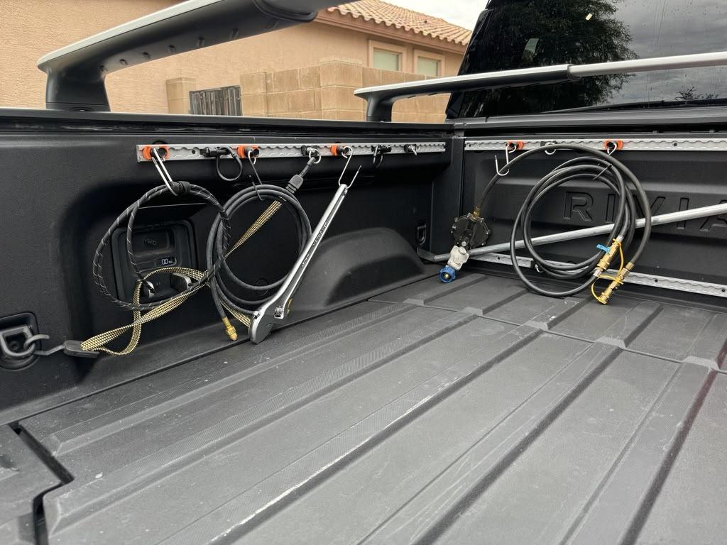

I bolted a couple of channels of t track to it and added some loops and a wheel chock to it. Works pretty well and just used the existing m6 bolt locations.

That’s nice but for me I load and unload materials enough that I plan to keep the bed fairly empty of everyday carry type items and also don’t want to add any mounting accessory there that would eat up the depth. I do enjoy a set of bed drawers though so might go that route when I have the topper on if I can keep them such that a spare would still be accessible with some minimal effort

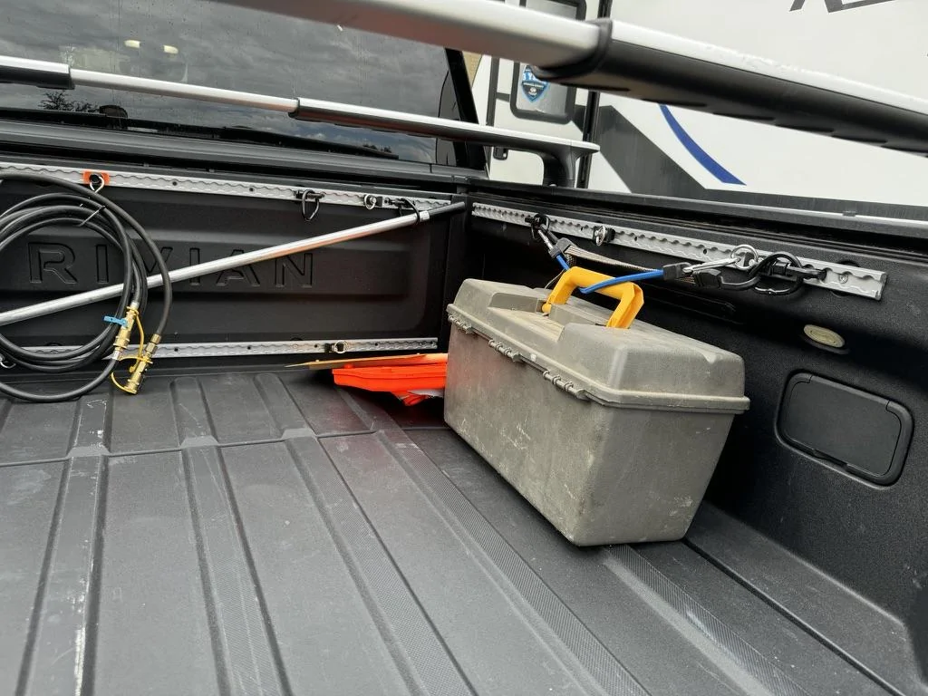

I have taken it out. Not sure how removing it could solve anything. But here's what I use for cargo. Cheap and very effective, very flexible.
