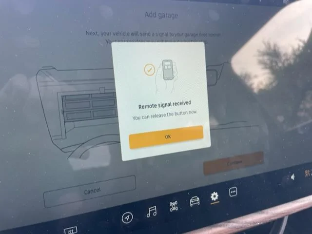

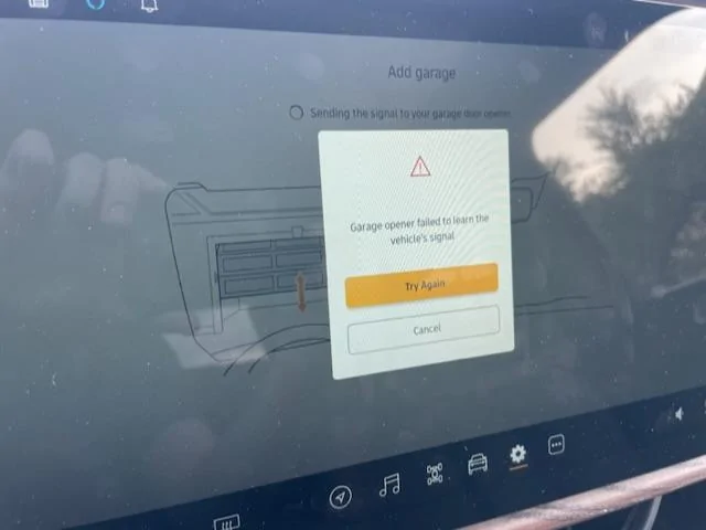

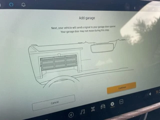

I can get it to read my 318mhz gate transmitter but it fails at the next step.

I am still holding out hope for increased functionality with future updates. My Tesla could not be programmed for our neighborhood gate for several years, and it eventually became programmable and worked. The Rivian will not program the same gate. I called support after it failed as the screen directs, and they noted the frequency and put in a ticket. So hopefully Rivian will likewise add additional frequencies in the pipeline for some future update.

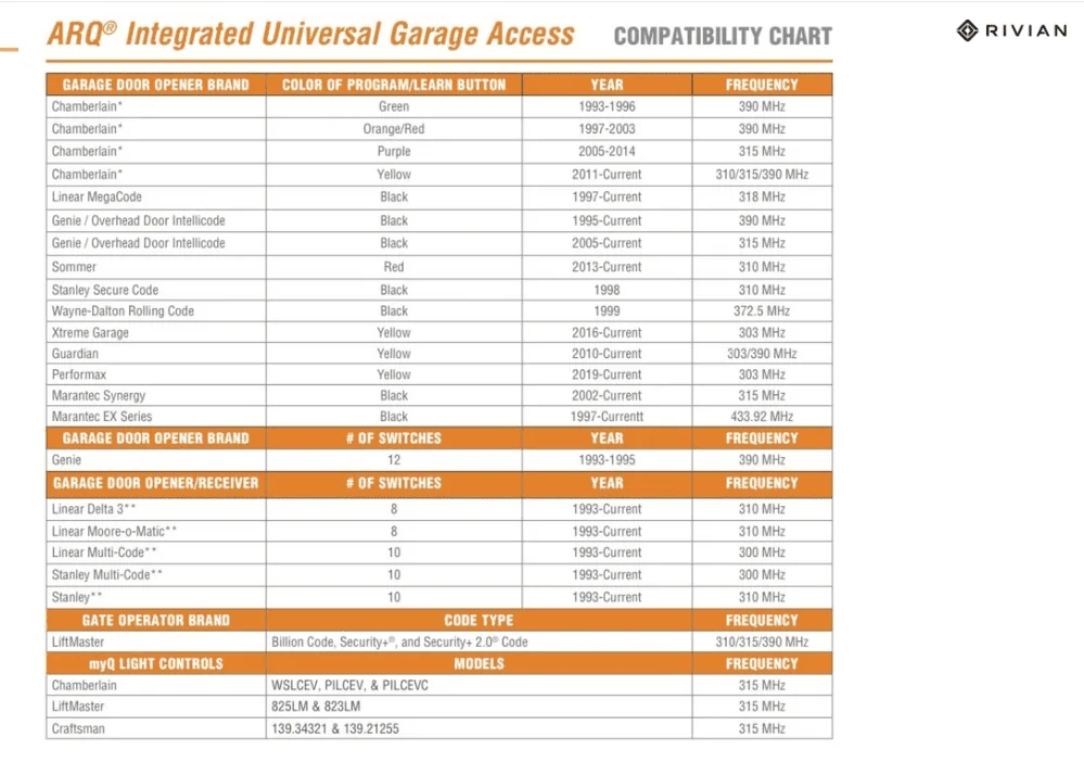

By looking at the charts they can support 433.92MHz. Need that for my Ghost control gates
