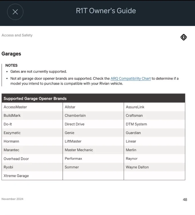

I looked at this closely when I took delivery a year ago and saw that Rivian was supporting garage doors in the 300 MHz range but not in the 200 MHz range yet. I can't recall exactly what my gate is, but it was around 296 MHz. I looked up which transmitter/receiver that Rivian had selected, and it seemed to support both frequency ranges, so support should just be a limitation of software thankfully, so there is still hope. I called Rivian support and gave them the brand and frequency of my gate. I check it after updates hoping it is something they get to. I had the same issue with my first Tesla. Took them a while to incorporate my gate to be programmable.

Just posting here that my Linear Access Pro gate is “not currently supported” after spending 6+ hours over three calls with Rivian support. Had zero issues with my Tesla and several Ford Explorers. Annoying especially if it is just a software issue.

I also have an unsupported Linear 318 mhz door that works on every other car I've ever tried. I'm still not sure if it's a hardware or software limitation. I have been through the submit a service claim with no resolution process.
