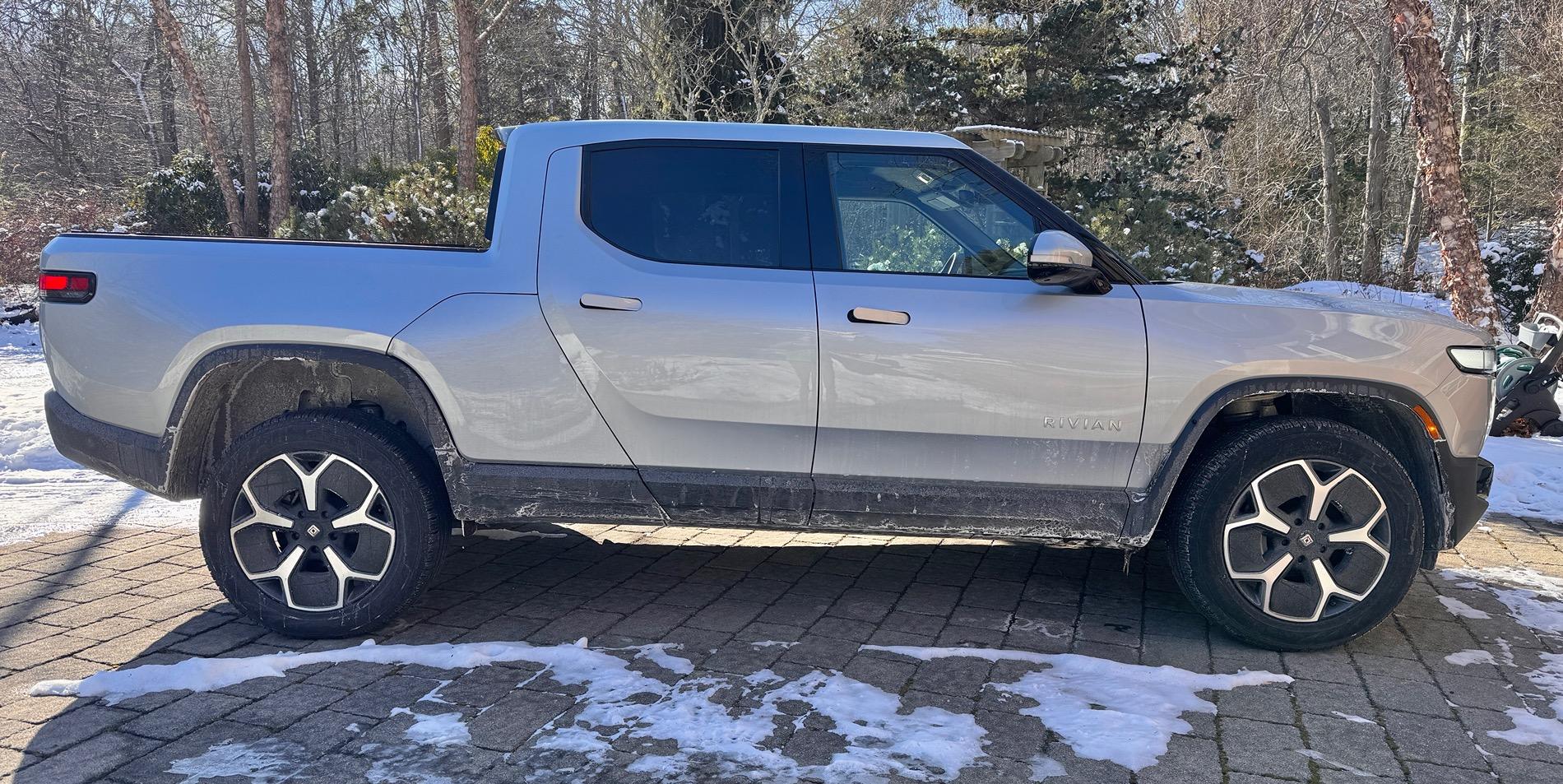

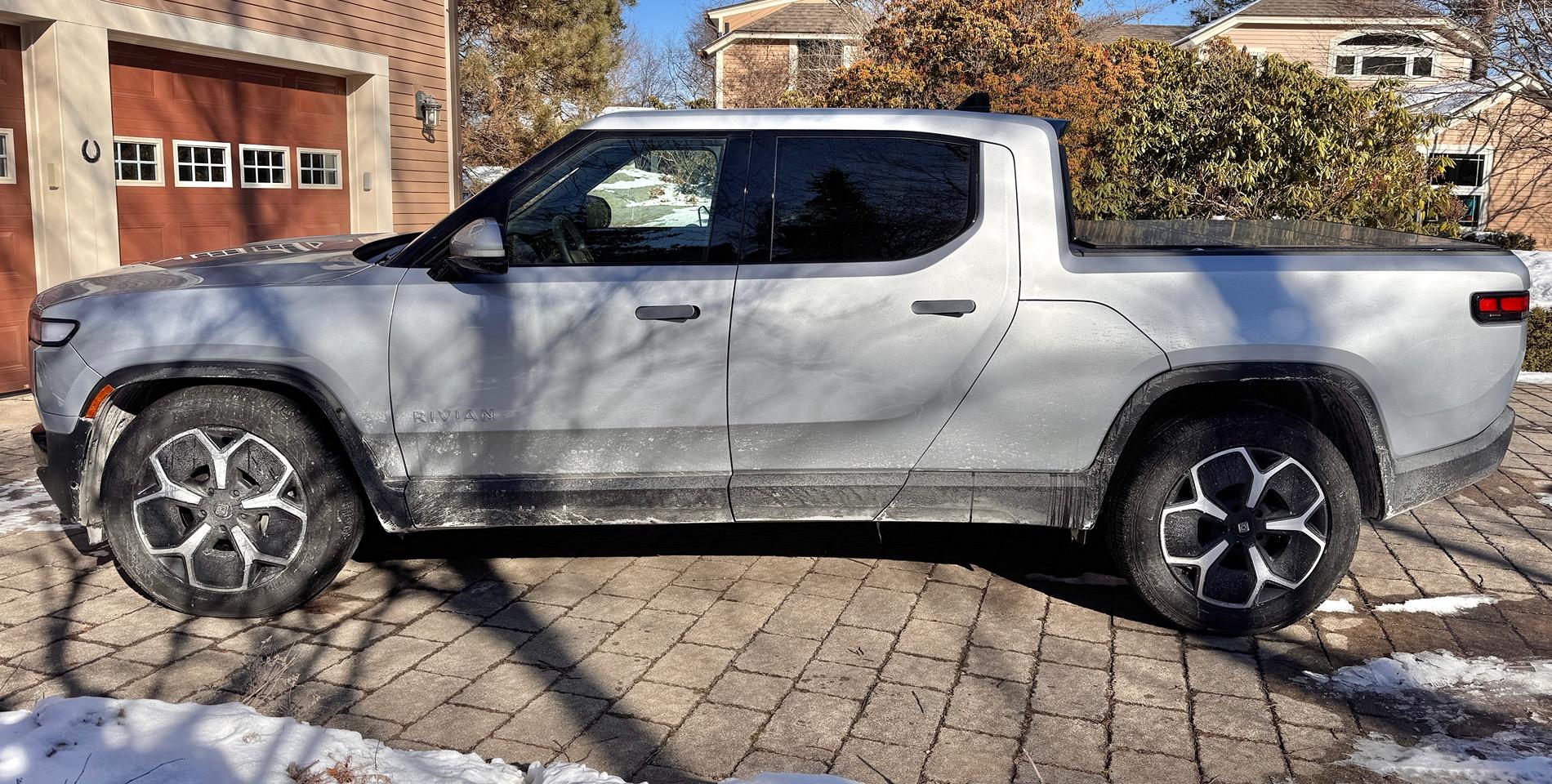

Glad to hear you are resolved. I have another 4 weeks until my appointment. As you can see in the pictures, the RR is stuck at max height and LF is at its lowest. Unable to change suspension or drive settings and no cruise, lane departure, emergency braking, auto high beam, parking sensors. I hope it is as simple a fix as you had.

Thanks, that is a bad deal! I suspect that the solution for you will be different. As the problem with mine was with one of the zone controllers that is new for Gen 2. The control systems on gen 1 are entirely different. So likely not the same issue, but hopefully similarly easy to fix ?
Since none of your safety systems are working as a result of the ride height imbalance, I would highly recommend pushing on Rivian to get your appointment sooner. You shouldn't be made to wait with safety issues

Finally had my appointment last week and got the truck back yesterday. They determined the low voltage harness to the RR height sensor was corroded. The same as michiganpinball. Repaired and all systems are functional again. The ride improvement vs having the suspension locked is night and day.
I asked about likelihood to see similar at other corners. They suggested it is not common. Of note, more common is mouse wire damage. It seems mice like the warmth the battery gives off and then to chew on wires.
