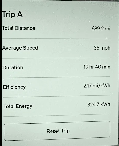

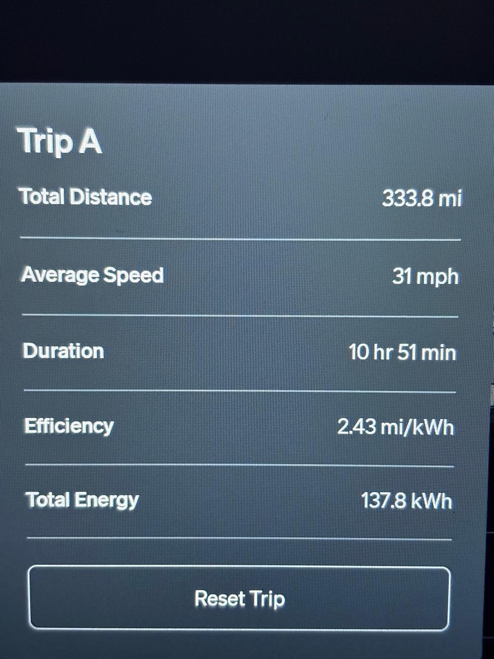

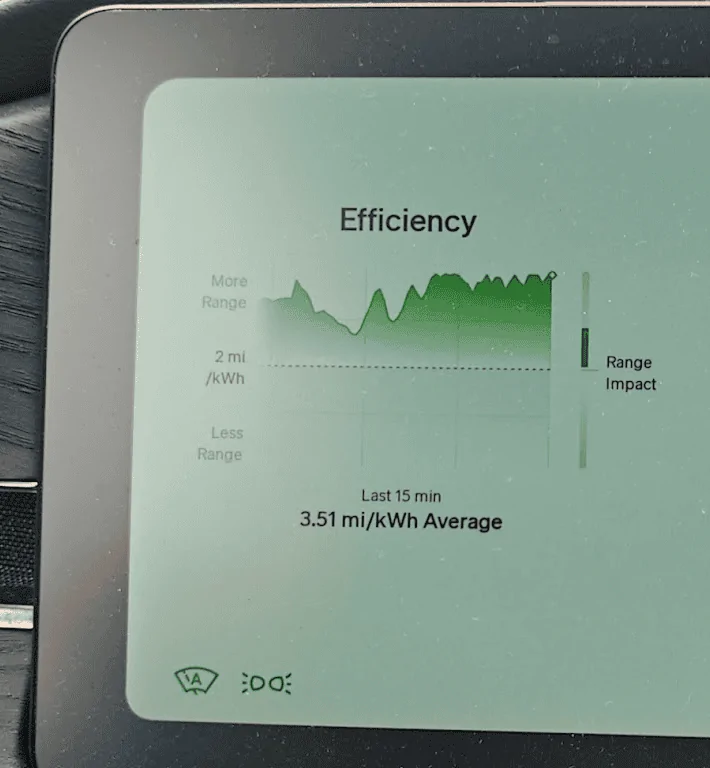

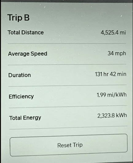

2024 Standard+ (software locked G1 Large) Performance Dual on 22's at almost 5k miles.
Most of the lifetime average
Rivian R1T R1S Gen 2 Standard  > Large battery pack. 1724164530555-b0
The last 700 miles
Rivian R1T R1S Gen 2 Standard  > Large battery pack. 1724164572008-tq
Recent around town 15 minute snap shot / not typical
Rivian R1T R1S Gen 2 Standard  > Large battery pack. 1724164630409-tu
