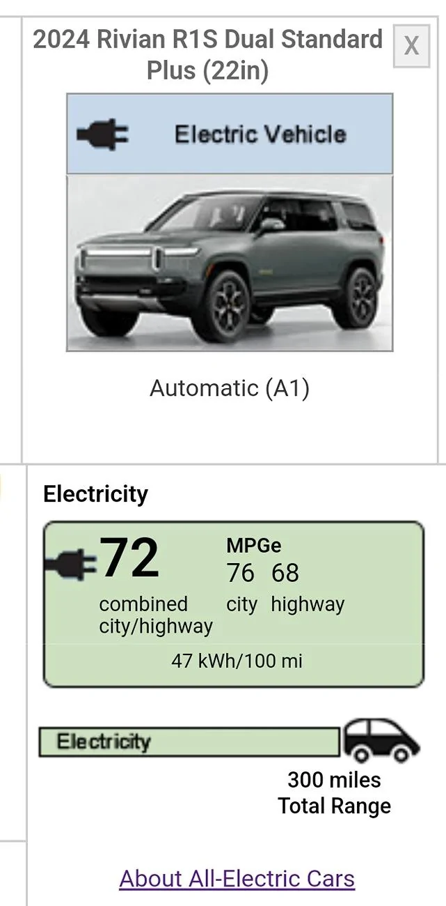

Gen 1 2024 EPA was about 2.48 mi/kwh combined on the 22s. (Not LFP)
Interesting... That's a noticeable discrepancy between EPA efficiency and calculated efficiency with Rivian's claimed battery size and range.
But yeah. In any case, claiming 3mi/kwh on gen 2 is outlandish imho

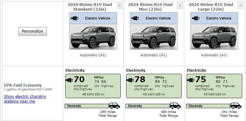

The 2025 aren't listed on the epa site yet. But the Gen 1 is a little inconsistent
Standard (Software locked Large) is at 2.40 (106kwh)
Standard Plus (software locked large) is 2.48 (121 kwh)
Large is 2.6 (131kwh)
Max is at 2.7 (141kwh)
You would think all the larges, regardless of capacity would be the same - since you're lugging around the same weight. And you'd assume the max would be lower, since it's heavier.
