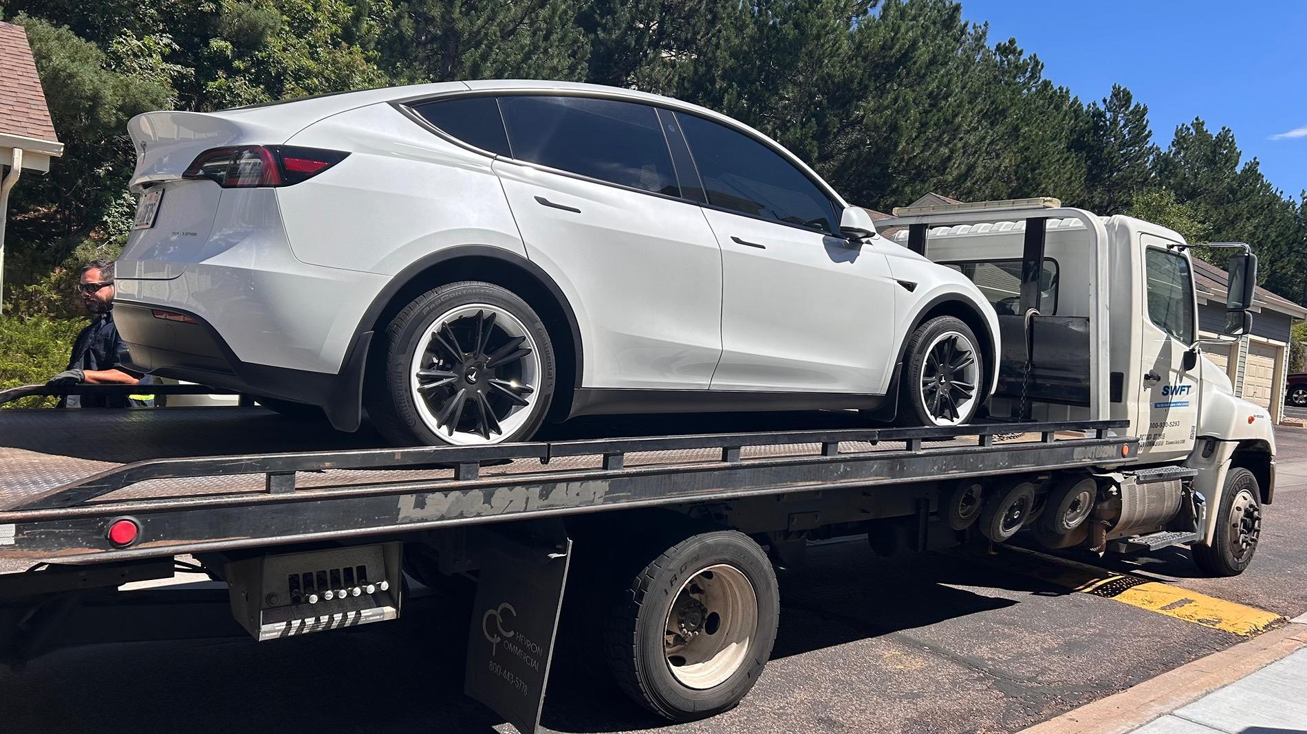

After update, Apple Music no longer worked. Soft reset didn’t fix, hard reset did. Next day, no longer working again. Radio works, Tune in works, Audible doesn’t work. Only 1 profile. This is my first issue with media. I really feel the software team is junior varsity. I do appreciate the forward motion in software and look forward to fixes coming soon.
Sounds like a failed OTA update, happened to my Model Y. At least it didn't brick the truck like it did to the Y.
