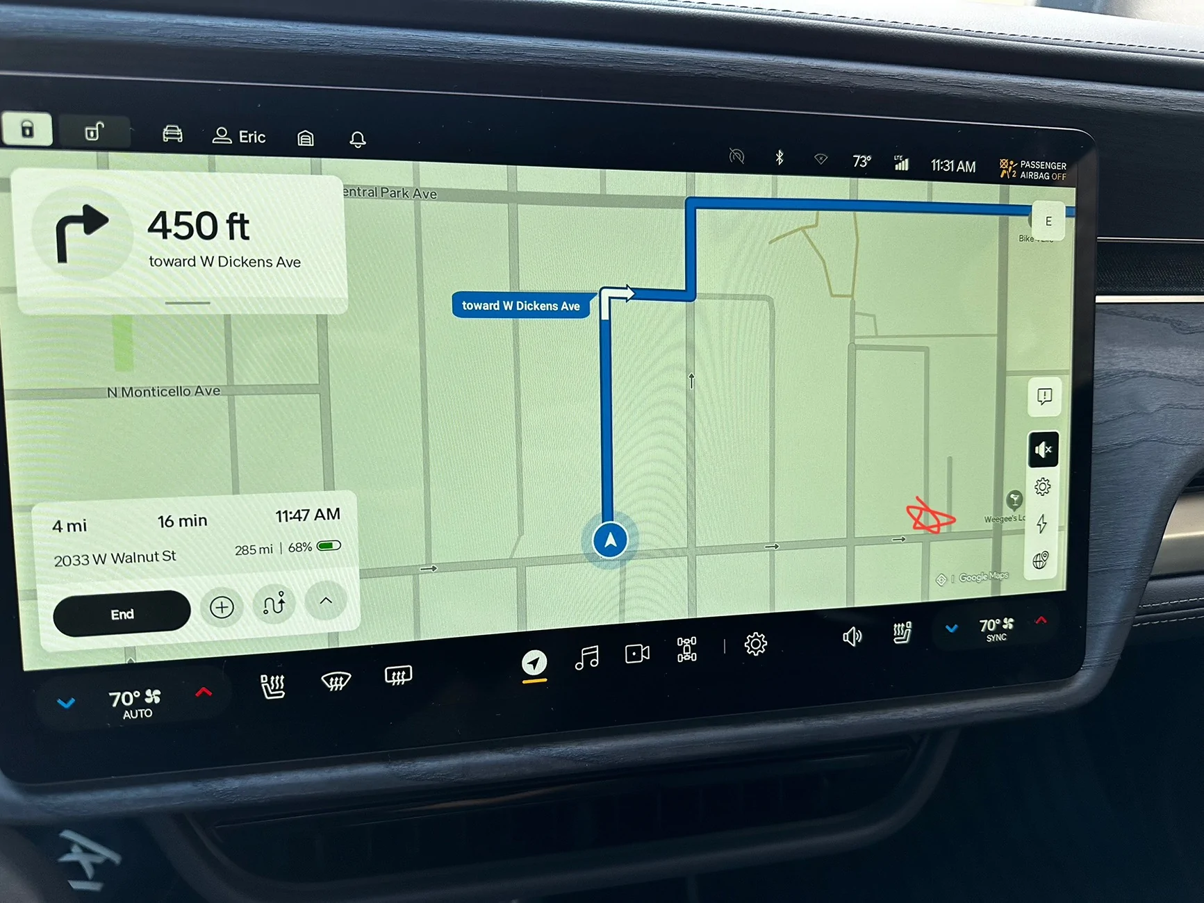

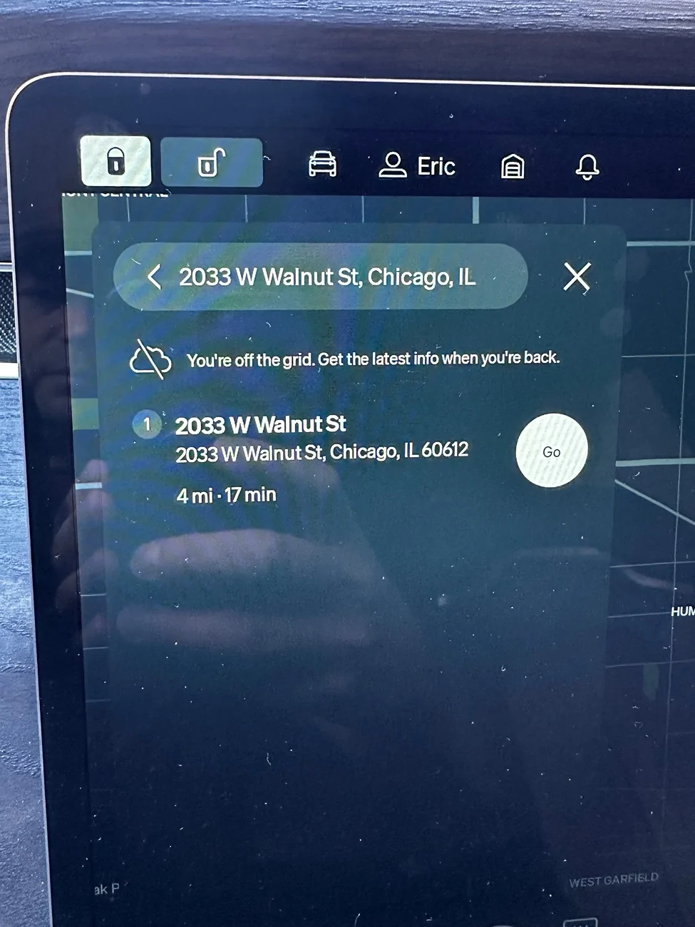

Twice now I have pulled out of my garage and input my destination in the Navigation (while waiting for the garage door to close) to find that my gps location was incorrect.
The first time it was 1 block off and remained that way for the first 5-7 minutes of my drive. The navigation kept updating as though I was a block away.
The second time it happened I had no signal at all at first (photo attached). So I did a hard reset. After the reset I regained connectivity but my location was off by 4 blocks for the first 5 minutes or so of my drive (see second photo… red star was my actual location).
Has anyone else had this issue before? The service center said they can’t find anything wrong. They asked for permission to perform a long distance test drive (115 miles) but I’m not really sure what that will do.
I’m open if anyone has any suggestions or experience with this.
Rivian R1T R1S GPS position incorrect IMG_3845
Rivian R1T R1S GPS position incorrect IMG_3844
