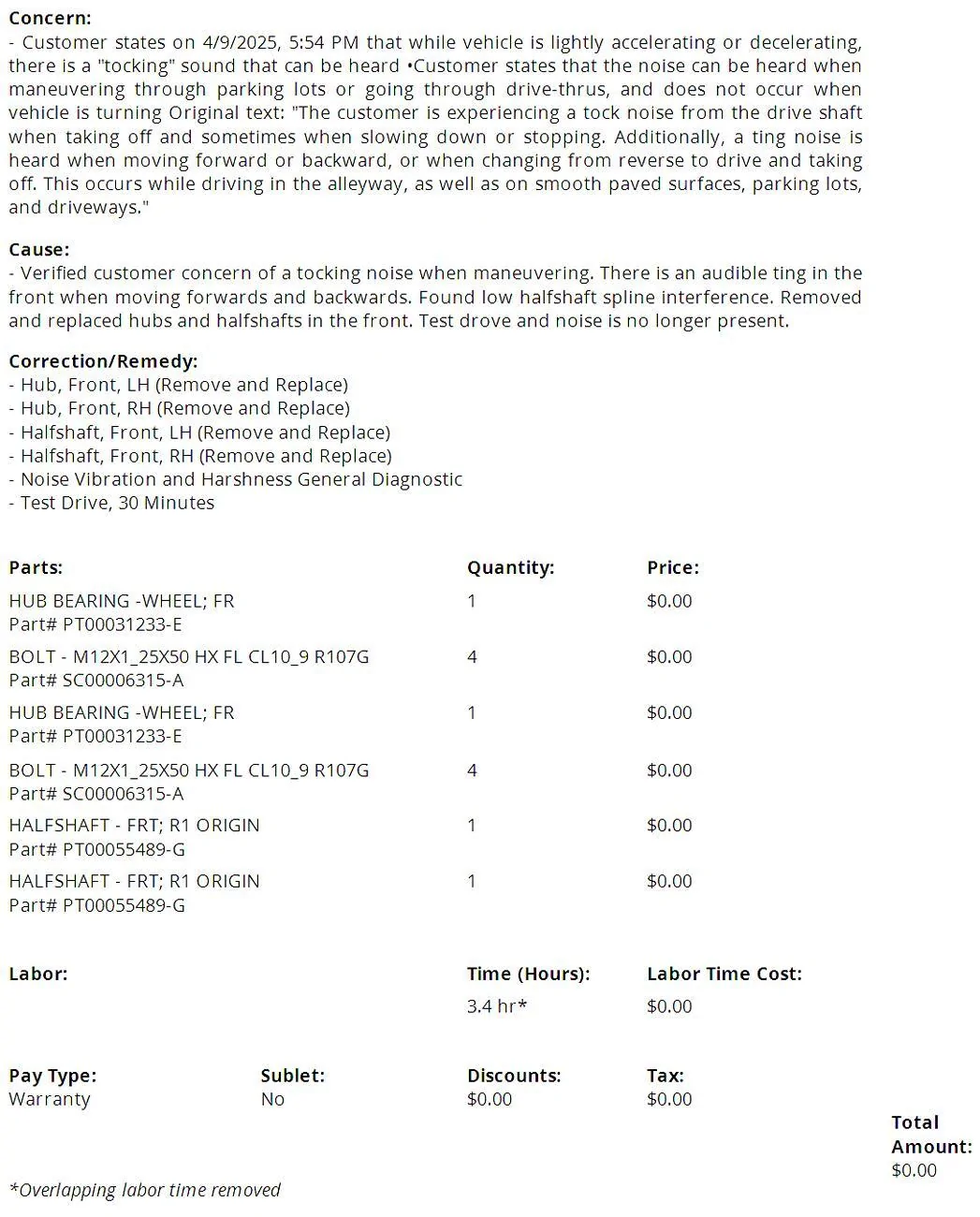

I just got new halfshaft for both sides and hubs for both sides.
It does sounds better overall and they also changed the Dampeners and jounce lines on both sides which also helped.

Our 2022 R1T got back from the shop this week. New half shafts and new hubs in the front. This seems to have addressed the gear-lash like feeling from the drivetrain. The service advisor explained that it was caused by slop developing in the half shaft splines and that the new half shafts are from a different manufacturer. I asked about getting the jounce lines replaced but they claimed that mine were good and that this was not related to the issue I was feeling.
so far the truck feels much more solid and predictable at very low speeds. Fingers crossed that it stays that way for a while 😉
Well that is interesting...different manufacturer for the halfshafts. Is this new, or did we already know about it?
We have documented different part numbers for the halfshafts G1/G2 and different motor configs, but I am unaware of new manufacturer.

Ok, if this is not new I can say that the new manufacturer is not any better than the old. I have a new Gen2 Tri and the halfshafts are just as bad as in my old Gen1. In fact, the Gen2 went bad much faster than my Gen1.

We know it's a different interface than the Gen 1 Bosch motors (origin drivetrain), but I didn't realize the manufacturer had changed.
My Gen 1 quad had it's half shafts and hub assemblies replaced in November, granted I'm not launching it like I did when I took delivery, but thus far, not a single issue. Orignials, i started to notice play within a month or so of ownership, obviously not as pronounced by the time I had them replaced, but anyone paying attention to them could tell something was off.
