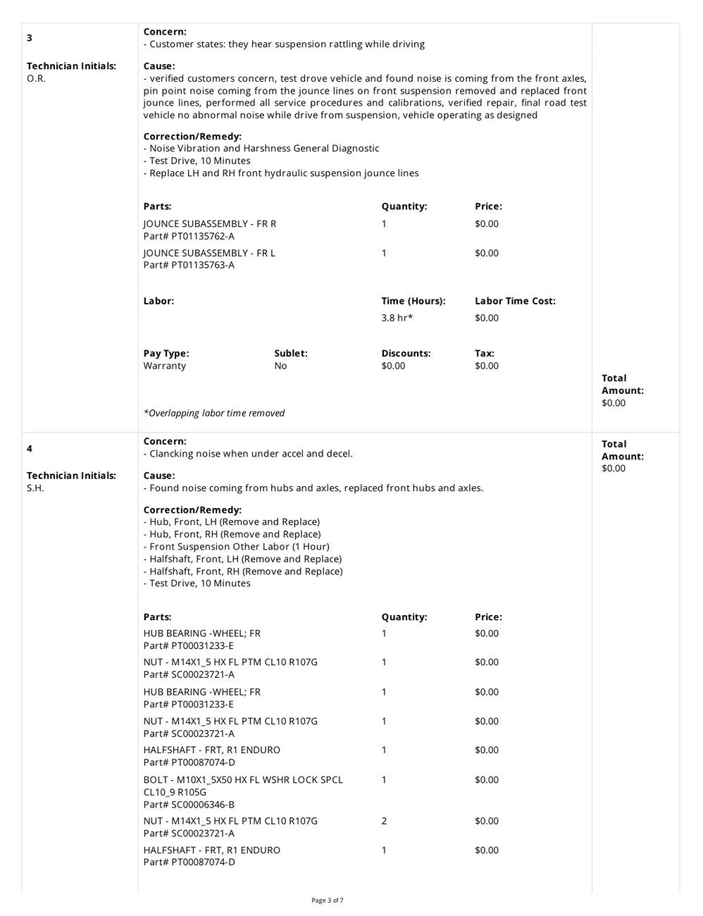

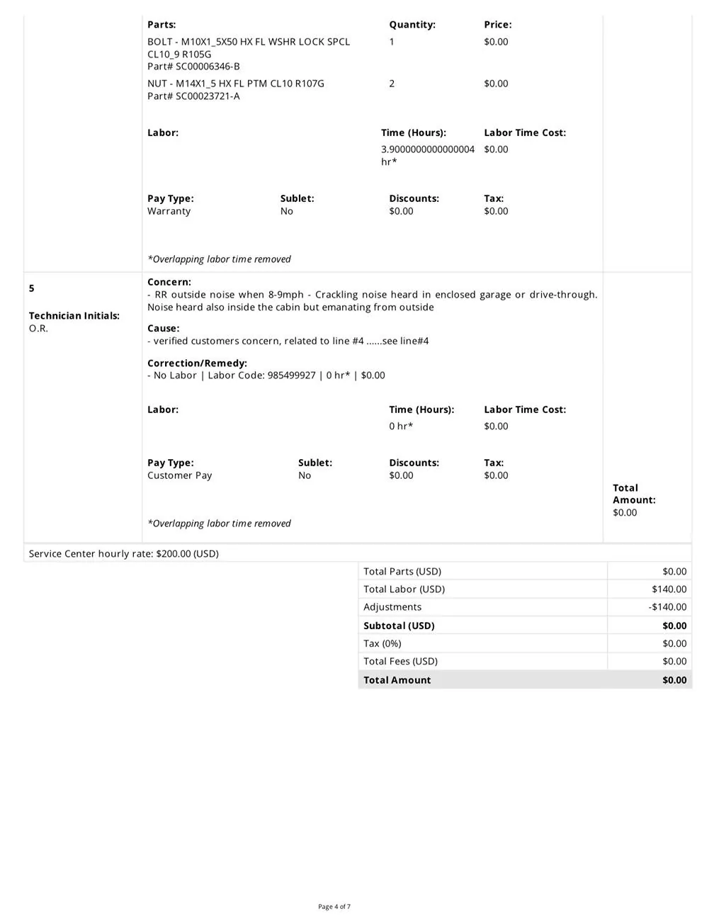

I seemed to have found the thread of other rivian owners annoyed at their cars sounding like a POS. Between June and July I leased a 24' quad S and a 24' dual T. I couldn't stand the clanking, dry rolling bearing sounds from my truck so I took in. I've attached the invoices detailing what they replaced. They said I had gen 1 control arms etc.. and they replaced it with current suspension bits. After 2k miles the truck still makes all sorts of noice at low speed and hauling ass. I decided to live with it till lease term. Once its over I'm not getting another one. I'm not gna play the game of taking it into service throughout the 24mo term. On the other hand, my wife's quad S front motors just started to pulsate at a consistent frequency under accel so there you have it. I have two problematic cars with a 24mo term that I need to live with. Her appointment now isn't till Feb 2025.
Rivian R1T R1S Master Thread: Suspension Sounds - What is and isn't normal? IMG_0960
Rivian R1T R1S Master Thread: Suspension Sounds - What is and isn't normal? IMG_0959
