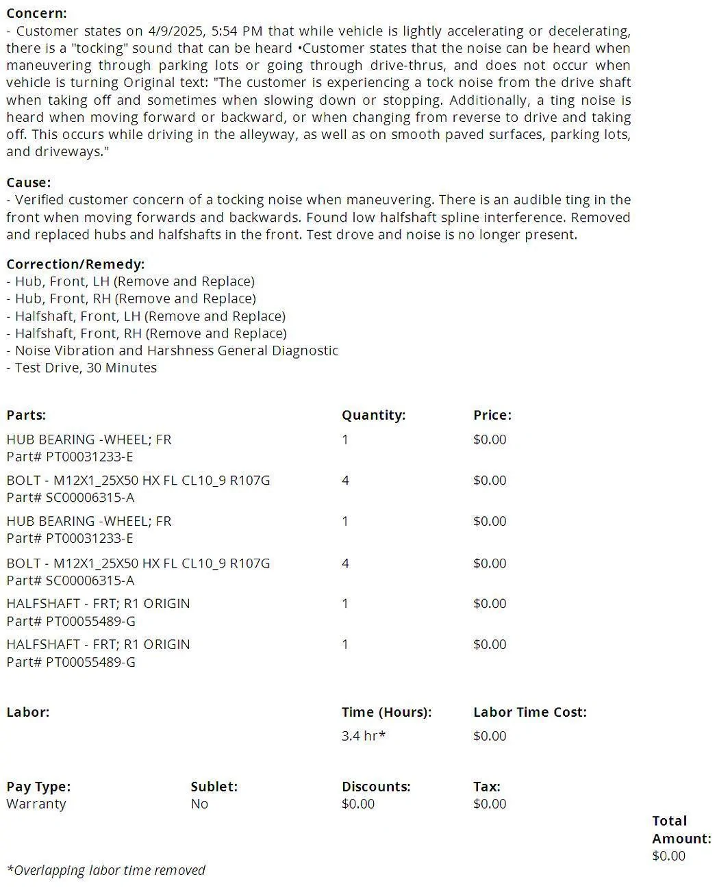

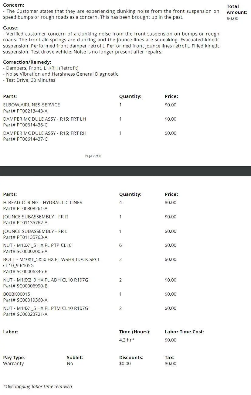

All my clunking, ting, squeak and tock from the front-end have been resolved after my most recent trip to the service center.
I just got new dampener for both sides / retrofit, new jounce lines / retrofit, new halfshafts and hubs
The suspension does sounds better with no clunks based on the 100 or so miles I have driven over the last 30 hours.
I am currently at ~ 28,000 miles on my Quad Motor June 2023 build R1S.
I appreciate Rivian and my local service center taking care of this concern.
The vehicle suspension is much quieter compared to when I dropped it off.
I am satisfied with the steps Rivian took to resolve my concerns and the effort they have put in to make the vehicle better than when I took delivery on June 2023 (RCA / TSB campaigns).
