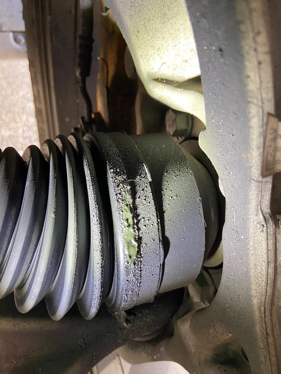

OK, I found grease leaking from the CV boot/joint area. its only on the front left wheel, other 3 wheels are dry. the clicking i've been hearing coming from the front left of the vehicle is likely related to this. i have a service appt in mid Sept and ive added this detail. seems like i may need the CV boot repaired or the CV joint replaced.
UPDATE: Rivian service replaced both half-shafts and the click/creak sound is gone. not sure why they replaced the right side since i didn't submit a ticket for that but maybe they found an issue there too.
