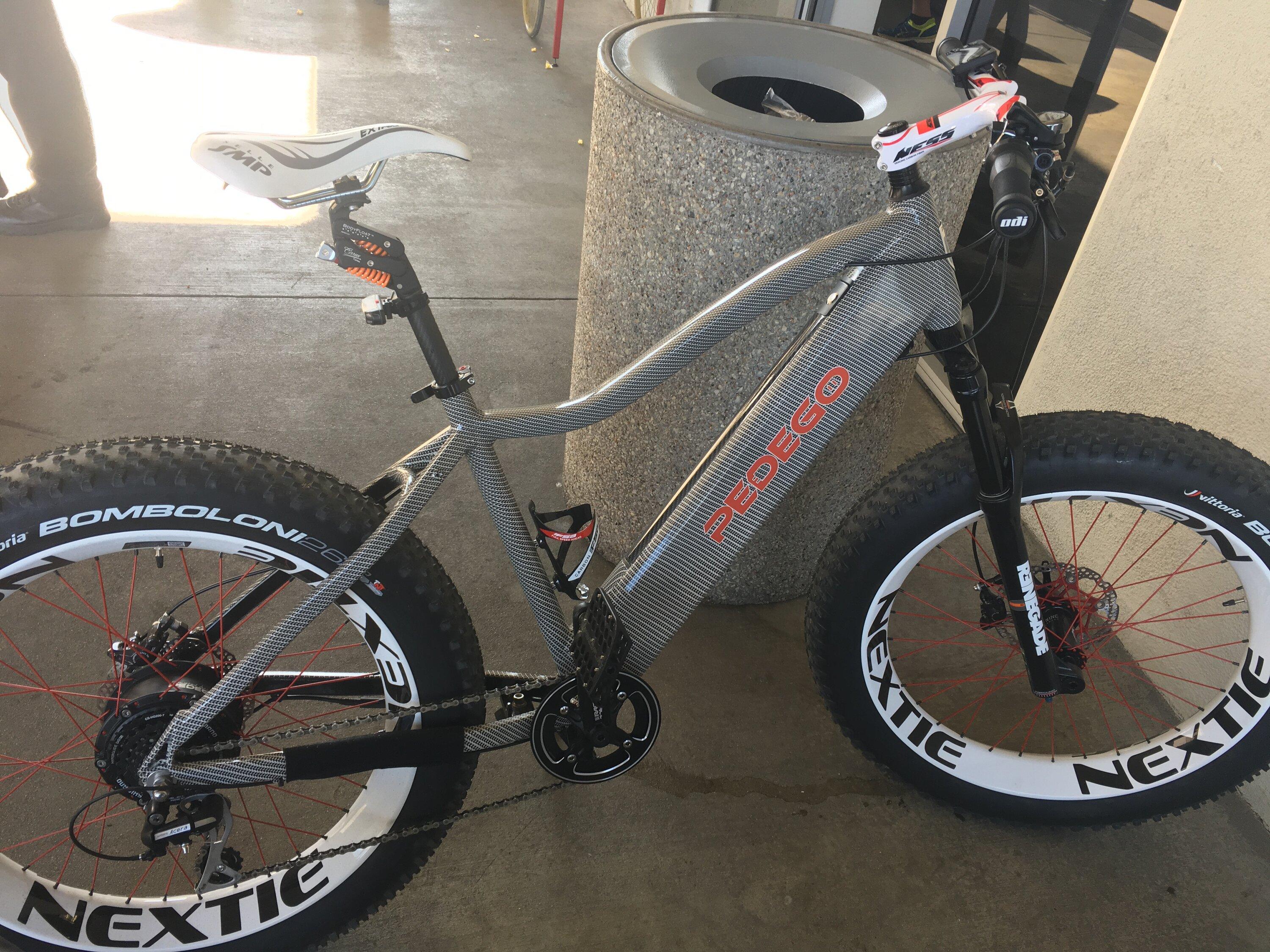

hydro dip all in carbon fiber finish, then UV clear coat .
shown is a Pedego bike in hydro dip
White / silver

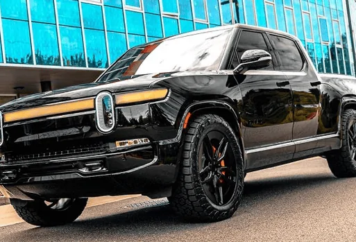

Rivian R1T R1S Has anyone painted their lower trims yet? EF19F04B-A506-4E24-823D-EB190558EAF4

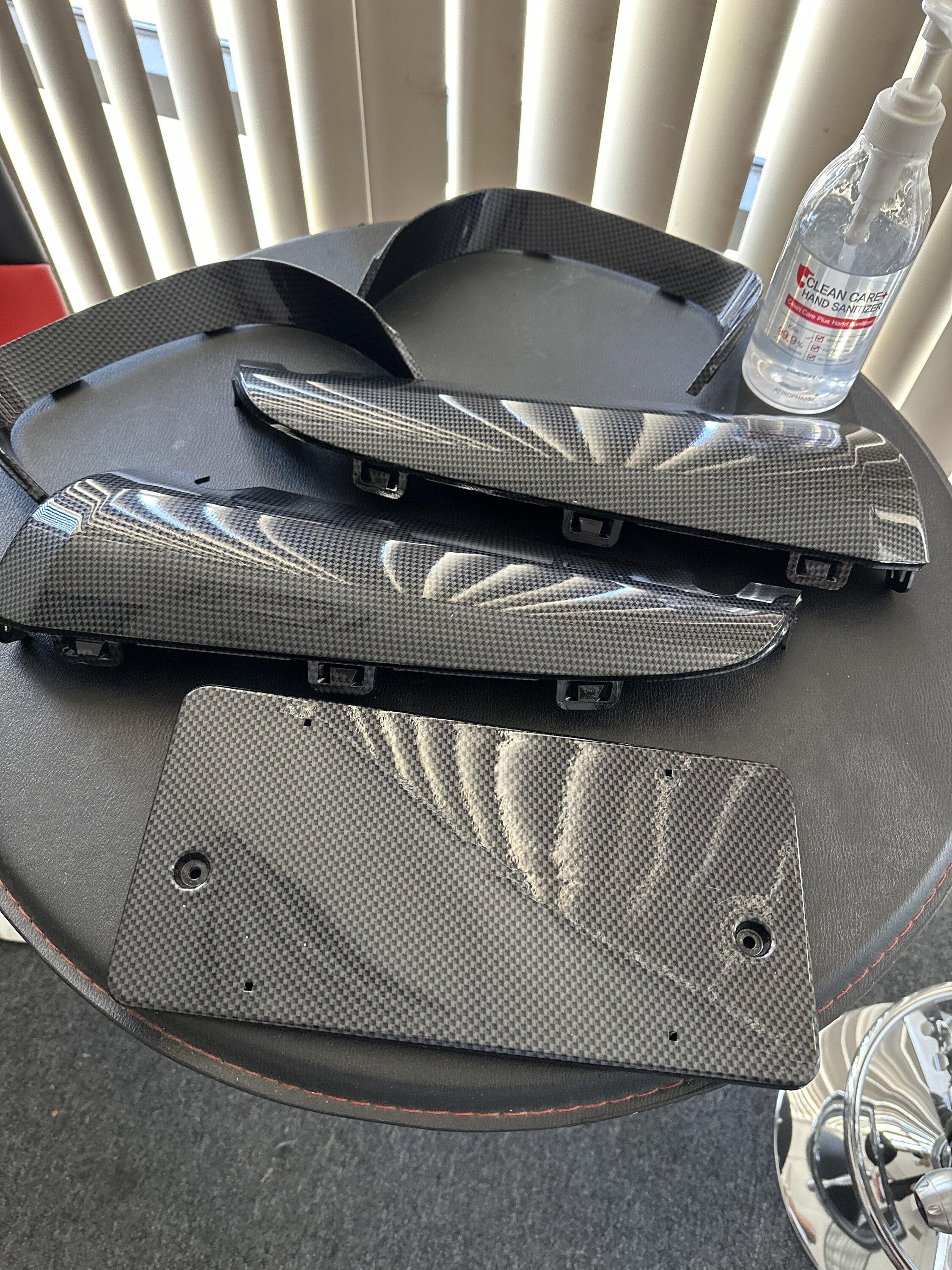

Just finished some Porsche lower trim
5 pieces
275.00
Rivian is next to dip and clear
I have been doing this for Sema builds since 2016
Rivian R1T R1S Has anyone painted their lower trims yet? 70724814659__502E1A6A-D5CA-486B-912F-5F1B0376C5CE
