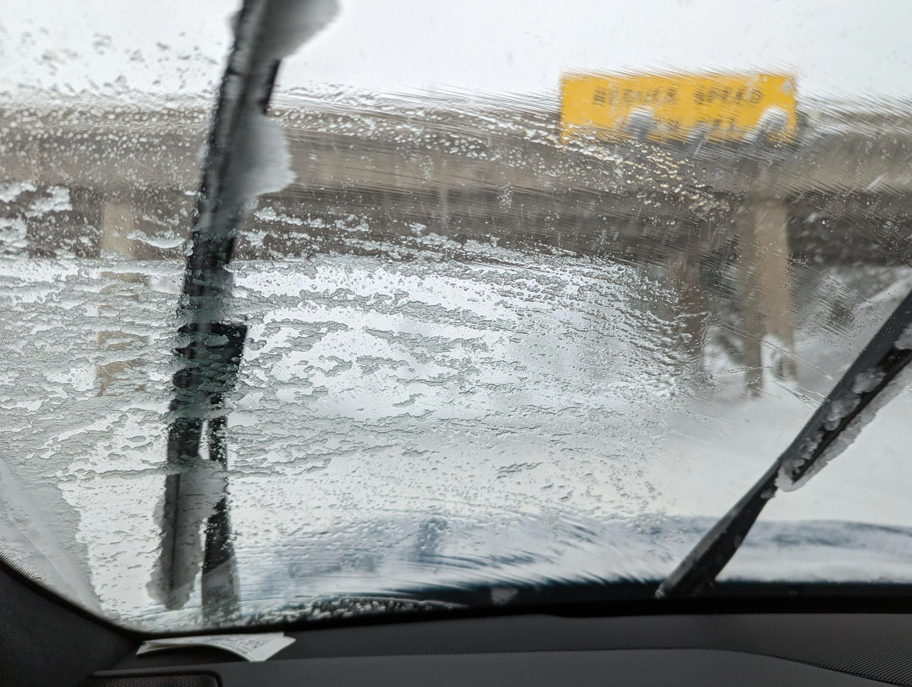

I will say that the combination out the gate of the OEM wiper blades (utter garbage) and the windshield defrost (often blows cold air) make a combo that renders the driver's side wiper dangerously useless (the ice build up on the left side of the windshield helps to freeze the wiper blade).

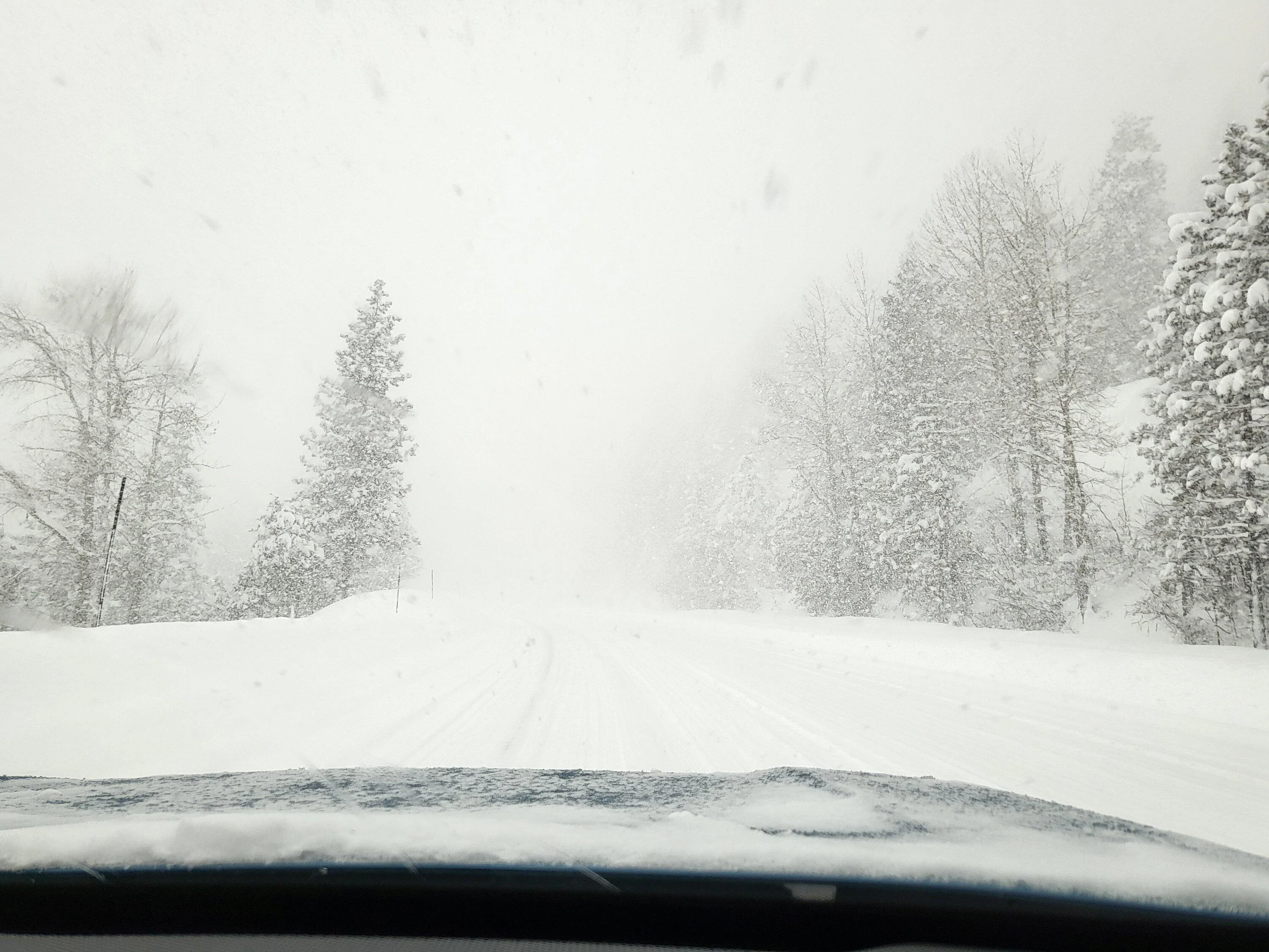

We made the trek home over Donner Summit on Friday during the 3 hour window that it was open, most of our driving in white out conditions. The driver's side wiper was so bad that I literally could not see out the windshield and spent most of the trip leaning to the passenger side to see. I continually turned on the defrost and it continually blew cold air. We finally figured out that we needed to leave the defrost off, set the heater to about 75 and only keep the dash vent turned on.
I've driven in these conditions many times, never had an issue with the iced blades like I did on the Rivian. Chatted with someone at the RAN charger who had the same problem as well.

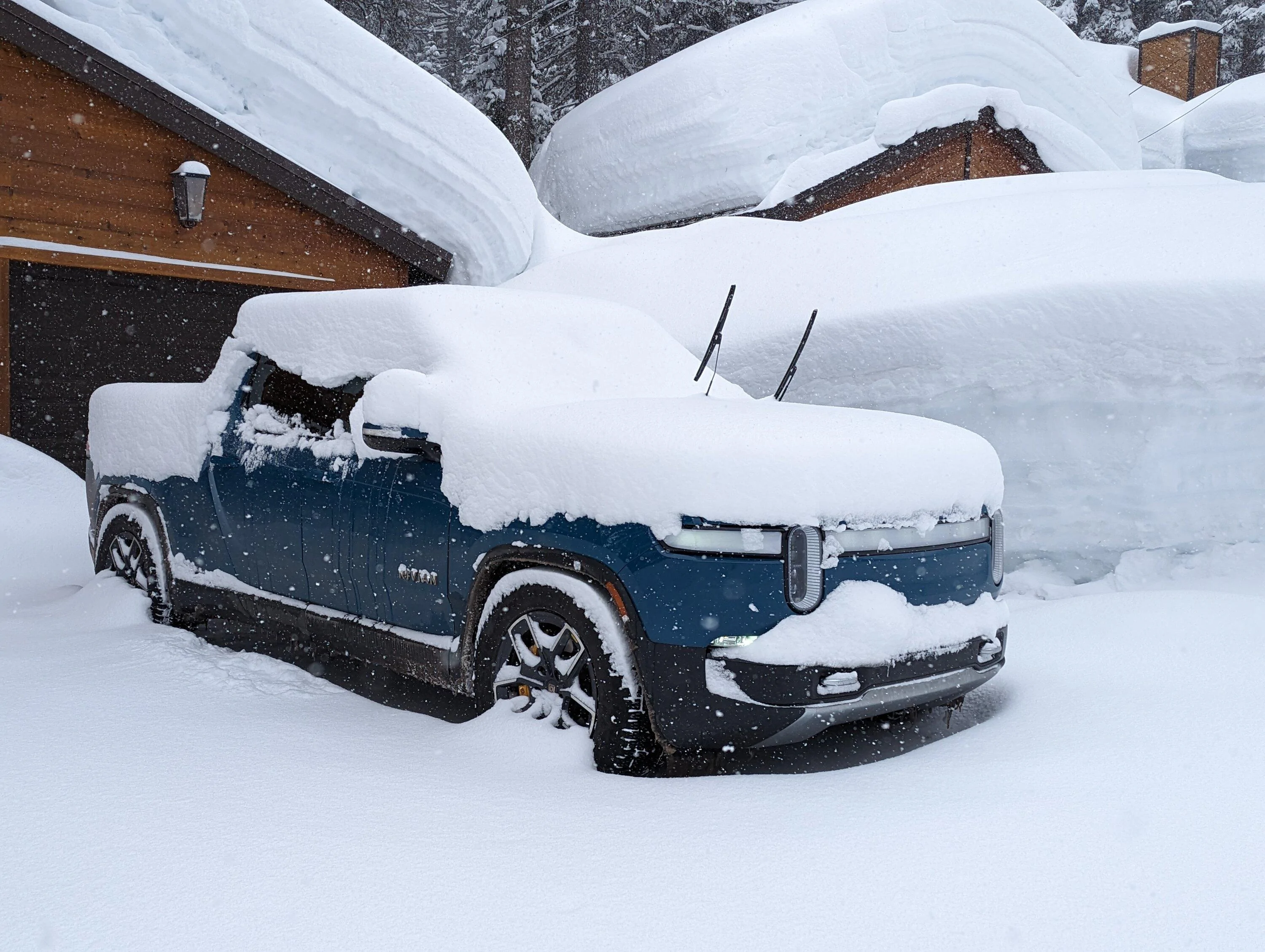

As for the other questions—we parked outside (didn't fit in the garage) and we managed to get all the doors open, but the frunk froze shut and there was no way to get it open. The slats of the tonneau cover are a wonderland for catching water that freezes, so we considered it frozen shut as well.

The parking sitch

Somewhere on I80, I think near Cisco Grove

Just an icy, streaky mess.

I'm in upstate NY and well versed in these conditions. This winter has been abnormally mild but I typically combat this with copious amounts of deicer washer fluid and occasionally I will kick up the washer fluid a bit by adding an additional 1/2 bottle of 70% rubbing alcohol ( a whole bottle makes the fumes a bit harsh).
In general I agree that many EV's try to over automate the HVAC system. It would be better if we had the option to manually select the exact function of the heating element, A/C compressor, fan speed outside air damper, vent controls...

It's pretty common to be driving in a good snowstorm and have the wiper blades freeze up with snow and Ice. It's happened on numerous cars I've owned and driven every winter in the Sierra's to Tahoe. If you don't have a heated windshield (heated pad where the wipers rest) you will get build-up on the wiper blades when the snow is flying. There's a simple cure when this situation happens:
  1. pull over,
  2. put the Wipers into "blade change position,
  3. get out of the car, lift the wiper blade off the window 2-3 inches then release to let them spring back on to the window. In many instances this will break up the ice off the blade
  4. Repeat 2-3 times to until the ice is removed from the blade. You may have to manually break it up. Repeat for the other blade.
I almost had to do this yesterday afternoon driving down from Echo Summit (7400') in my ICE car. I presume I'll have to do this in the Rivian when I [eventually] get it.
To carry off what @Trandall mentioned above, this is a time-tested method that's been in use for 100+ years.

I typically roll the driver window down and pull the wiper up off the windshield while still driving if traffic isn't heavy. Something on the Rivian wipers is a little sharp though, wouldn't recommend doing it this way.
