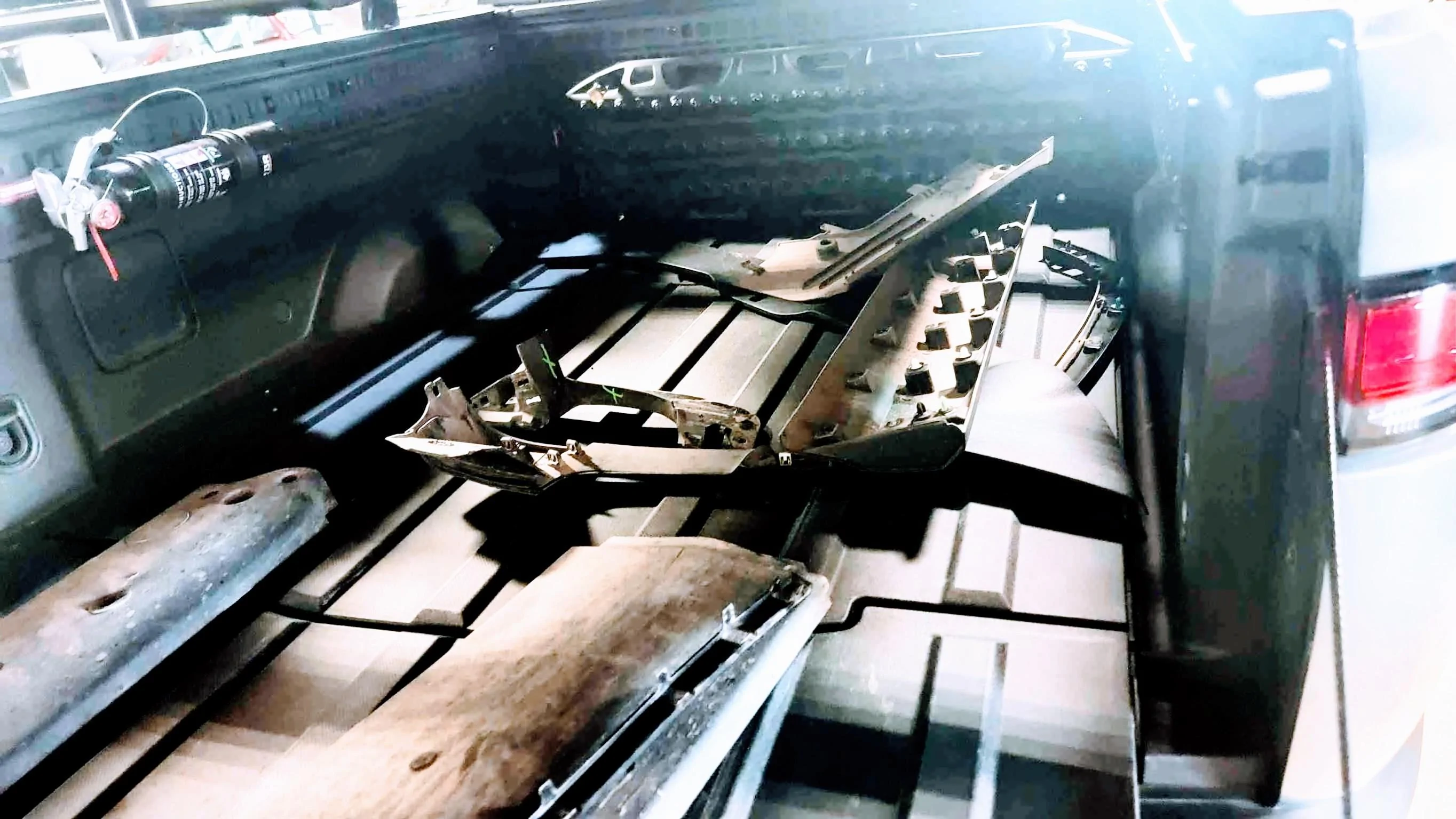

On another part of the trail we smashed the front bumper pretty badly by misjudging a ledge. Can you believe the "skid plate" under the front is plastic? There is a substantial composite skid plate under the battery but the ends are pretty vulnerable. I had to constantly remind myself to baby the truck. That one lapse of concentration will be costly. (And it would have been nothing but it little paint scratch on my old Jeep.)
Yes! This⬆ The plastic that is on every edge of this truck kills me. I've munched, crunched, or tore off just about every plastic piece minus the plastic rear bumper cover.
Here's a picture with my bed full of busted plastic trim pieces after off-roading. ?
