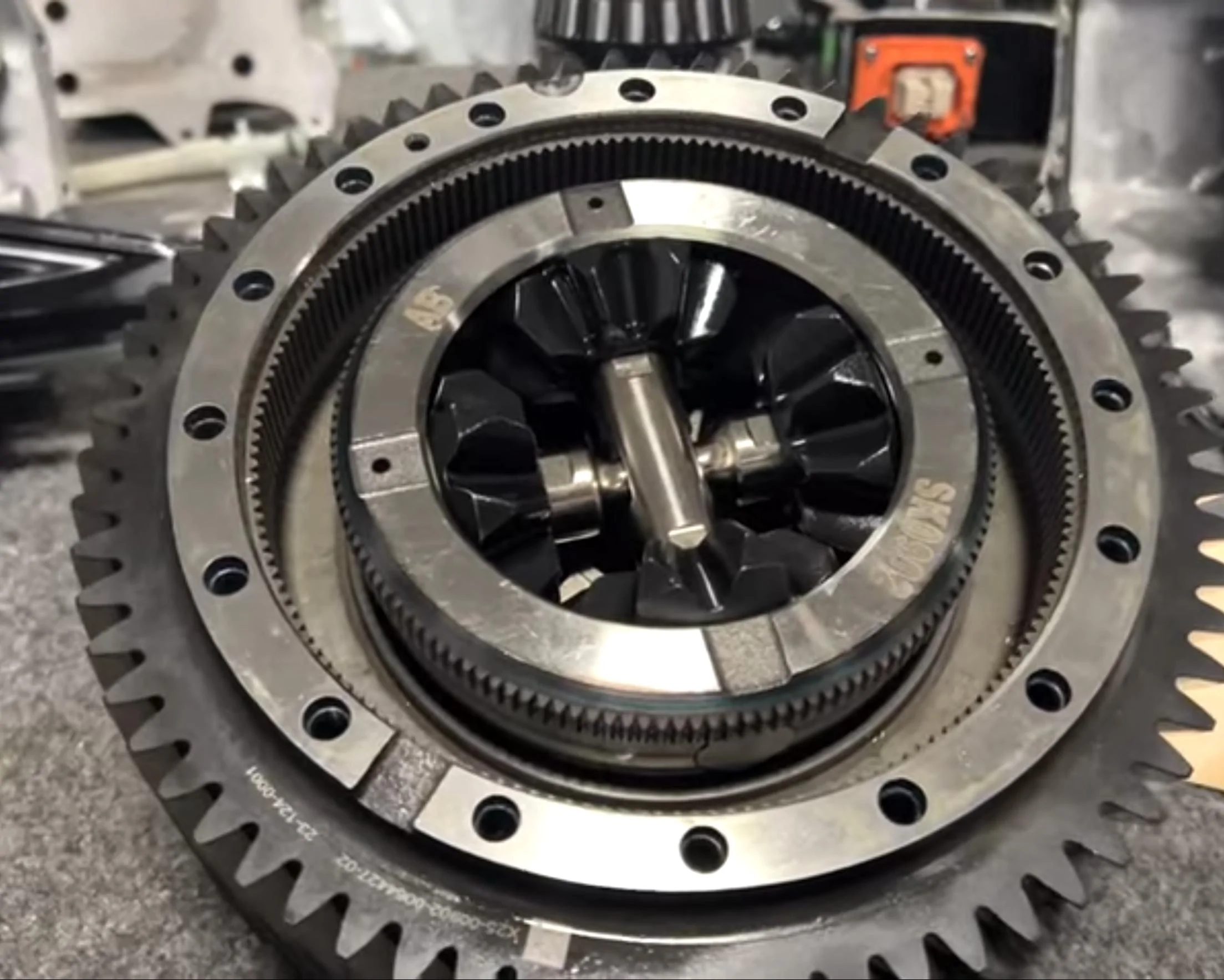

That zero rpm stall really complicates crawling for electric motors. They just don't do well applying metered power smoothly and end up with to much or too little.
I ordered a dual motor which will have less of an issue with that and will be investigating locking differentials. Which is to say I worked with ARB engineering to sort out applications and test products but I don't see how to engineer an air locker for a differential inside a planetary housing. I haven't seen it personally though so there might be a way depending on the case. Otherwise an automatic type if internals can fit.

The motors are already geared 10:1. They aren't direct drive 1:1
