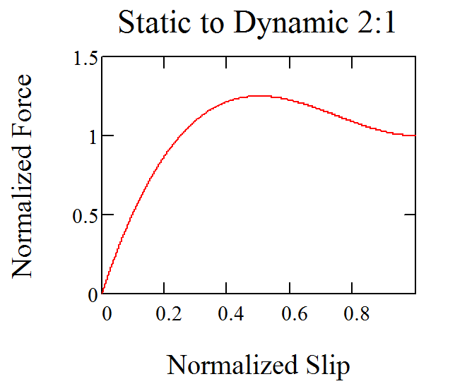

I see the idea of wheel slip being bad thrown around a lot. When in reality, excessive wheel slip is the reaper of death. Leads to a lot of lateral vehicle movement. No wheel slip provides confidence and sure-footedness.
It is well known in higher levels of racing, that a cornering vehicle has more grip than a vehicle on a straightaway. This is due to static friction being highest just before the tire slips. See (https://physics.stackexchange.com/q...hat before the,maximal use of static friction.) (Rough explanation in the answers section)
Rivian R1T R1S Hell's Gate in my R1T o0kIQ
or a more reasonable
Rivian R1T R1S Hell's Gate in my R1T 8I7bQ
Note that as the slip goes towards full slip the plot levels off at one to indicate that the force levels off at full slipping force once the tire starts fully slipping. Also note that before the tire is fully slipping part of the tire is not slipping and thus providing the higher coefficient of static friction. Thus, the real reason that tires provide more cornering power while partially slipping. This allows a maximal use of static friction. Thus, while a tire has contact with the ground, you want traction control to target the very edge before a tire slips.
Rivian targets this optimal friction point with its software. This is why we hear short-duration tire chirps when the wheel is still in contact with the ground. The computers are trying to maintain the highest friction level just before slipping and dial it back after the wheel speed sensors detect an increase in speed above a certain threshold. You can see in the original video, that when the wheel is in contact with the gound, we hear the short-duration chirps, followed by the motor control dialing back the power once the wheel slips.
