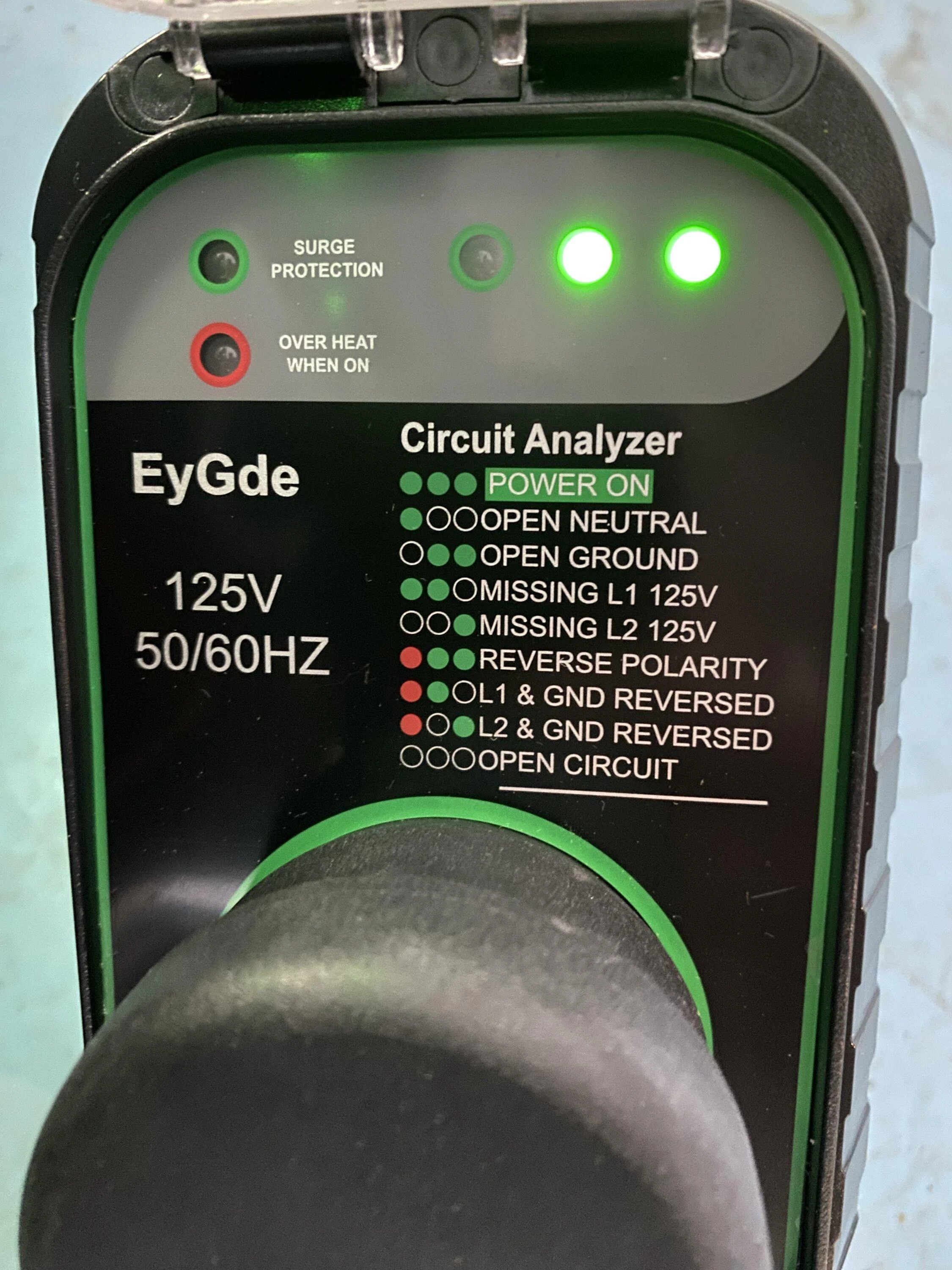

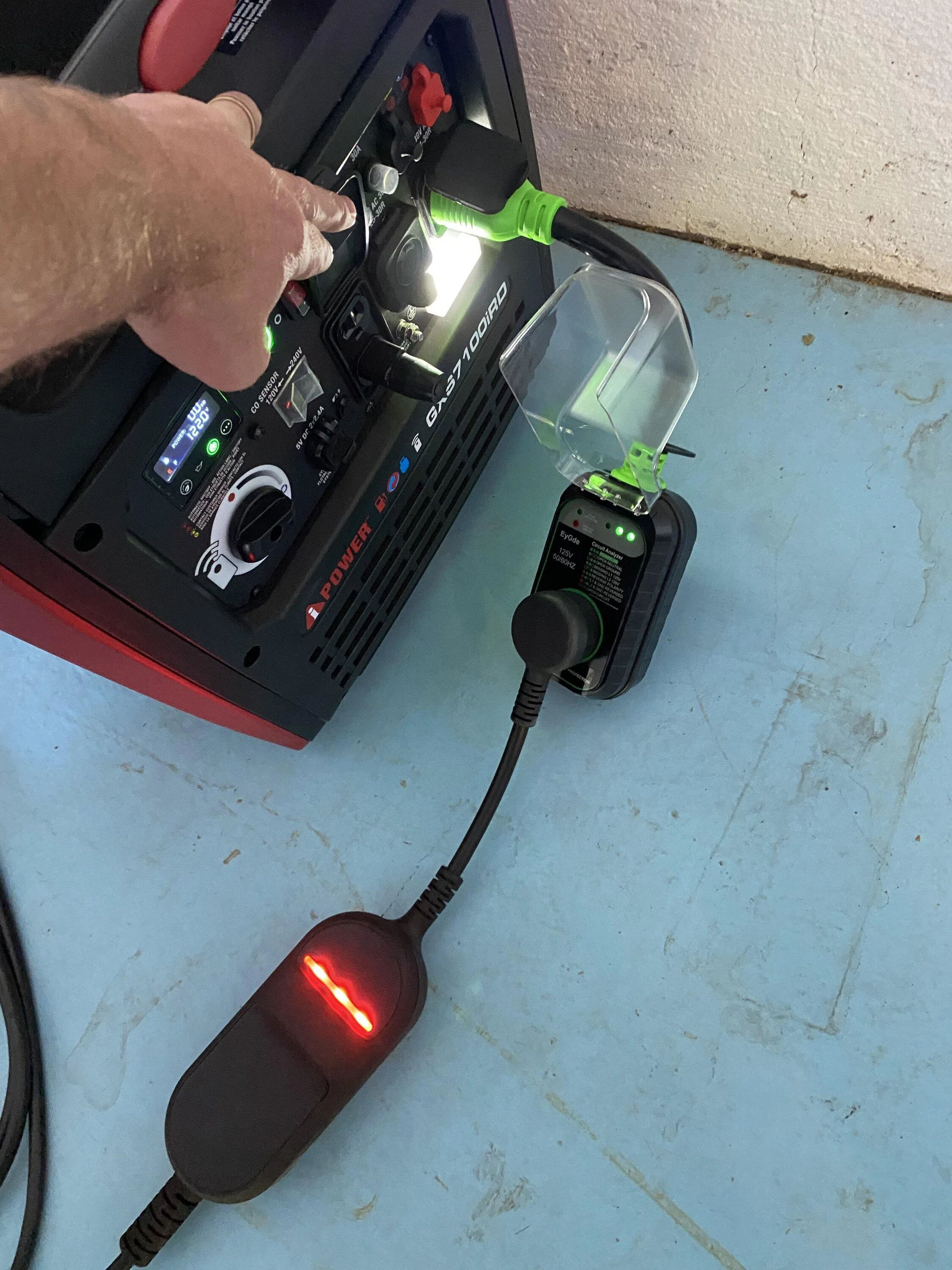

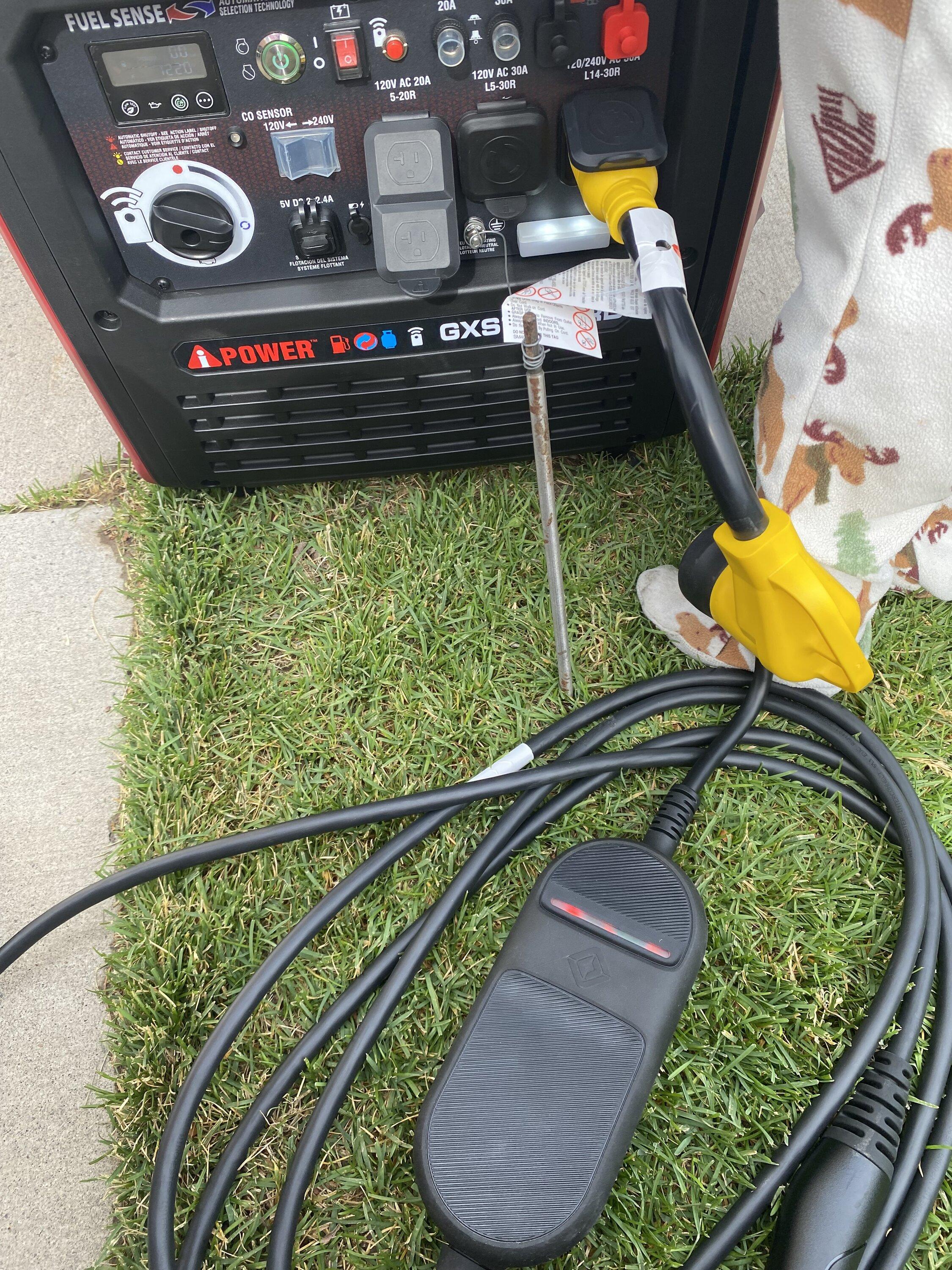

Yes. I’ve used a normal plug and it charges fine. Just not with the generator plugs. Good idea. I’ll ask rivian if that’s possible.So we do not miss anything the vehicle will charge when you plug into household power correct just not with the generator?
looking at your generator specs it claims less than 3% total harmonic distortion. Not bad for a generator.
wondering if Rivian can review the error log for your vehicle and help with any specific issues the vehicles does not like
again keeping in mind small generators do not typically do well charging EV’s
