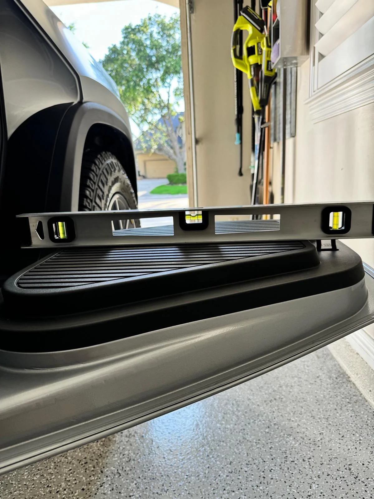

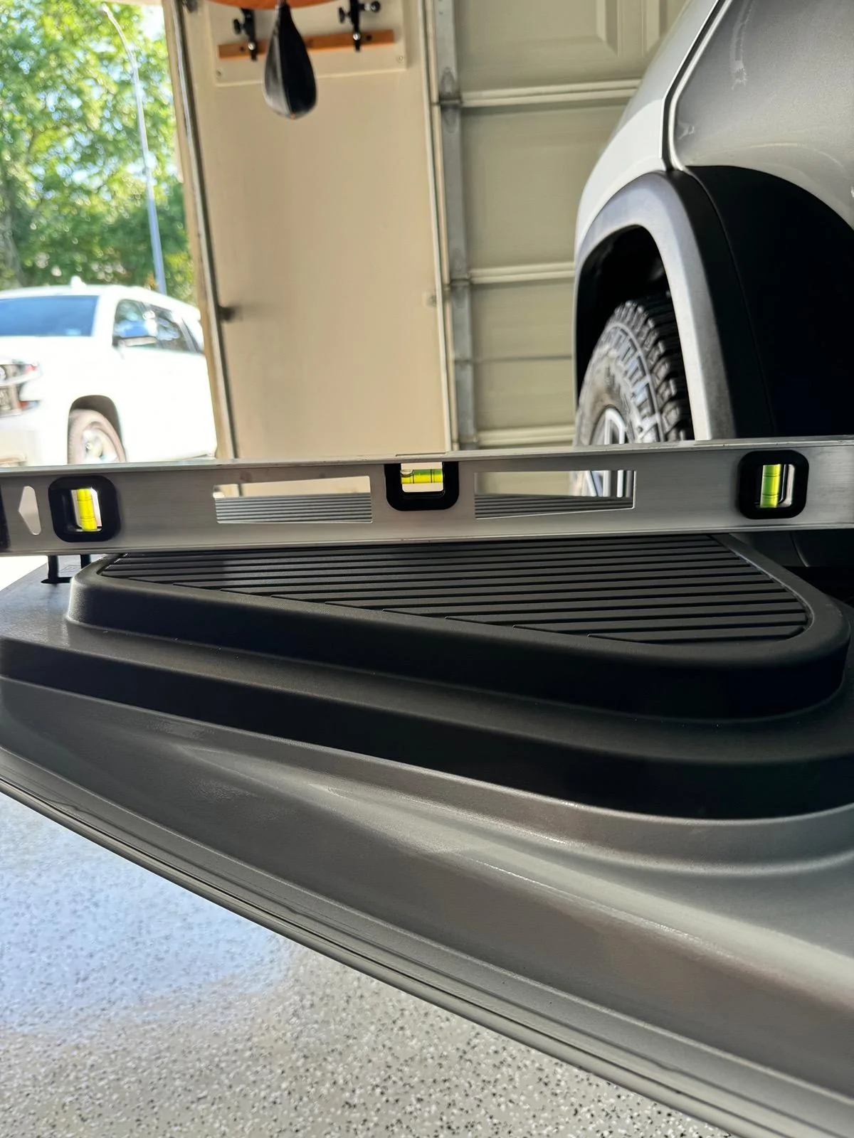

I'm just curious... Are you having issues with both sides or just one? Mine is only the passenger gear door. As you can see below, it's just not level and starts hitting the door about mid way out. And like you said, shimming one side then creates the issue on the other side.... and shimming too much decreases overall clearance at the top...
Interesting, both sides scraped and passenger side was definitely the greater offender, but not that bad. With the washers, driver side is good now, but it somehow made passenger side worse.
Again, I've got tinkering instructions and will follow-up later.

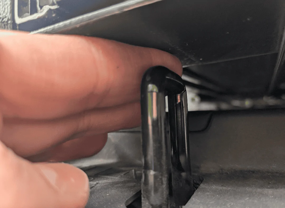

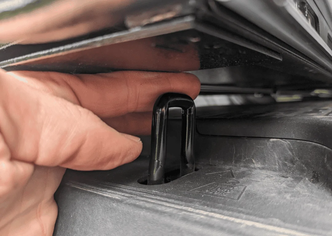

@harkco SOLUTION FOUND!
@EV Sportline engineers tested putting washers between the slides, bottom bolts only. (Does this make sense? There are 4 connecting the slides, put it between the slide plates and only the bottom 2).
THERE'S SO MUCH ROOM FOR ACTIVITIES!
Rivian R1T R1S Help with EV Sportline Sled Install 1000010672
Rivian R1T R1S Help with EV Sportline Sled Install 1000010673

How many washers between each slide? Also, are you still shimming up the end as well? If so, how much? I need about an inch more of clearance. My slide won’t even get halfway over the door.
Yikes, is it just your passenger door still being stubborn? I check the level on both of mine, they tilt slightly up, bubble still between the lines but leaning out. Nothing like yours, bubble all the way out.
I put one washer between each slide screw. I left the shimmy washers (2 under each screw one side, 1 under each screw the other side) for now, but will likely remove them. The middle washers did WAY more than shimmies.
