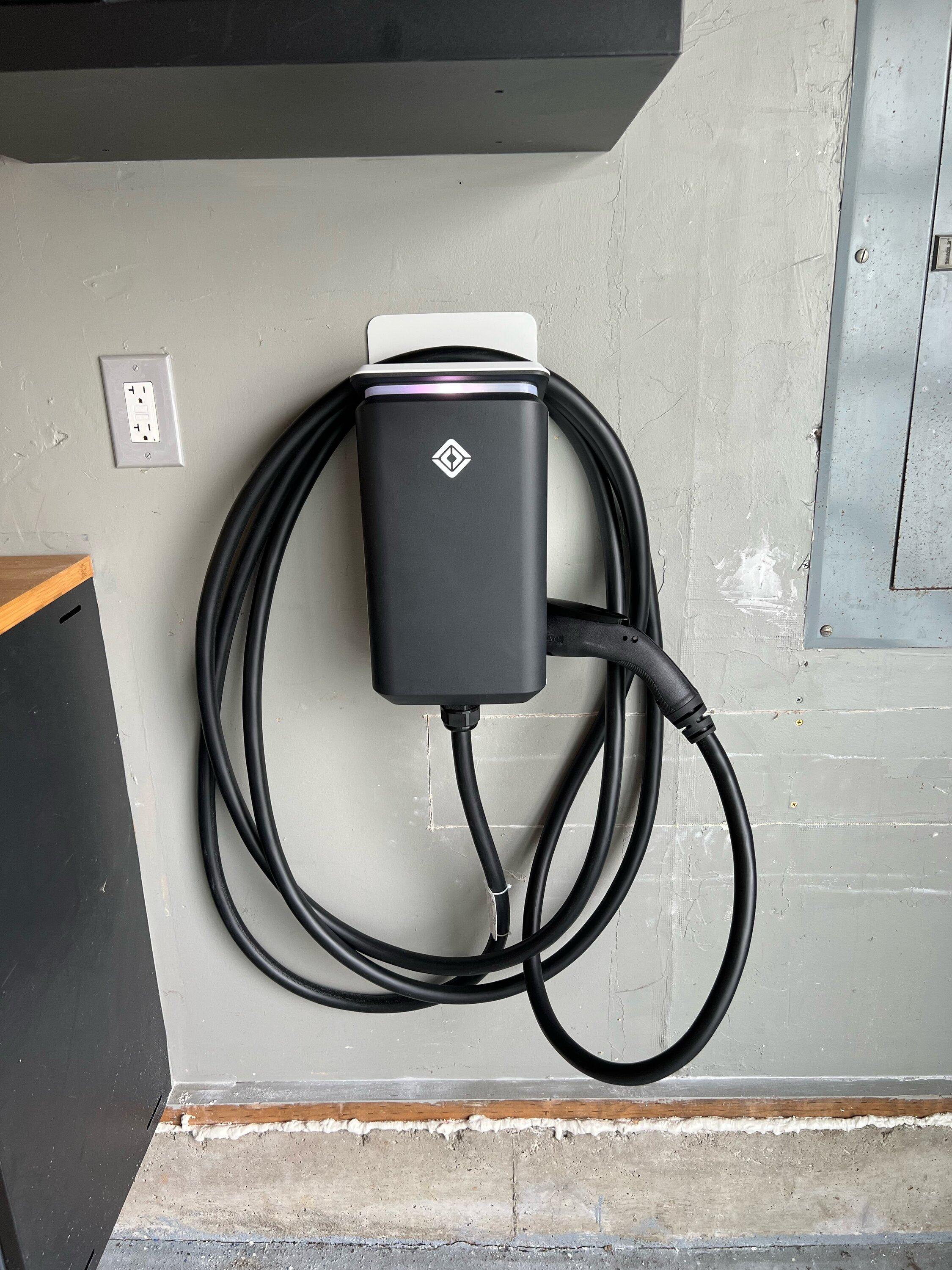

Well, yes but no.^ your 60amp rated circuit is allowed to supply 48 continuous amps, which happens to be the exact amperage the Rivian Wall Charger supplies. So, regardless of being connected via a direct run from your main panel/split breaker or from a sub-panel.. as long as the EVSE can get 48amps.. you'll charge at ~25 m/hr.
Since power = volts x current, you would be down approximately 1.5 kW @ 208V (or down roughly 3 mi/hr if we insist on factoring in driving efficiency which is highly variable).
240V x 48A = 11.5 kW
208V x 48A = 10.0 kW
That's not a huge difference but similar to the difference between 48A vs 40A charging at 240V. If there is a significant installation cost advantage to the split-breaker vs sub-panel, one should seriously weigh whether it's worth paying more to save a few minutes of charging over night.
