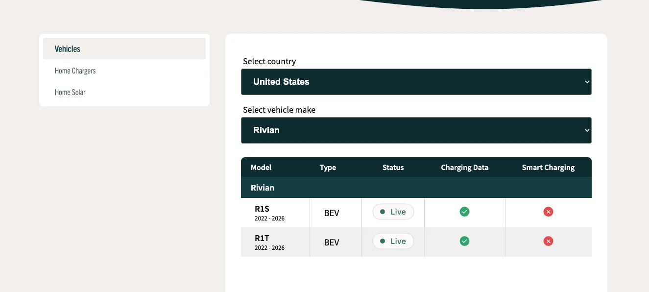

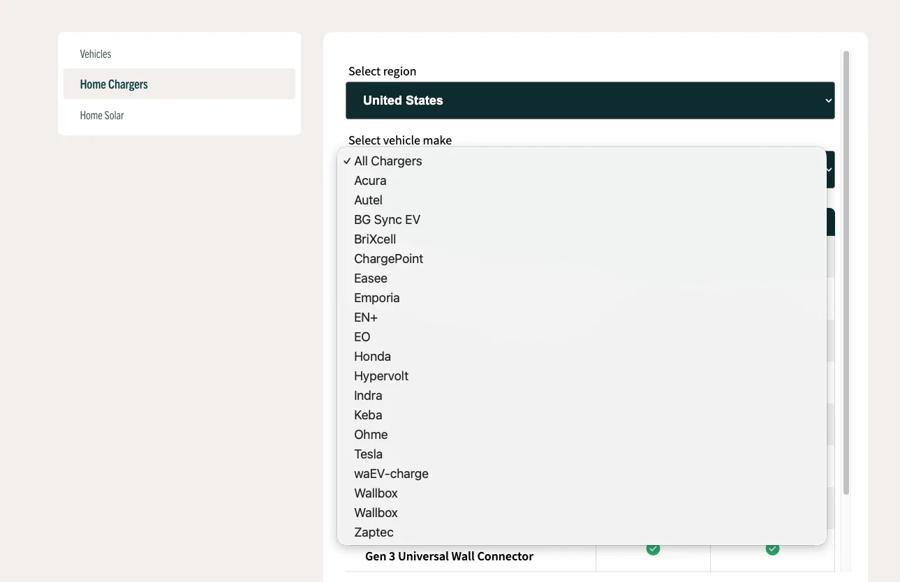

It 100% depends on your electric utility. In MA my electric company requires you enroll both the EVSE and your car to get the discounts and rebates.
You'll note that the Rivian R1 is on the list of supported EVs, but their EVSE isn't.

Depends on the utility company. In MD and specifically BGE, you have to have either a certain brand of vehicle or have one of 3 EVSE that they approved to qualify for the TOU rates for your EV.
