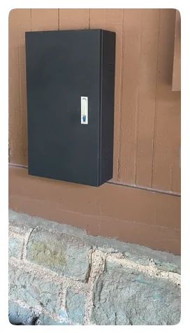

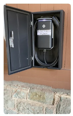

Here is what I did as my concerns were mostly about protection from weather, ease of access, and to block the green charging light at night.
Later, the box was painted to match the siding and it almost becomes invisabile.
Rivian R1T R1S Home Wall Charger CleanShot 2026-06-20 at 11.33.32@2x
Rivian R1T R1S Home Wall Charger CleanShot 2026-06-20 at 11.33.06@2x
