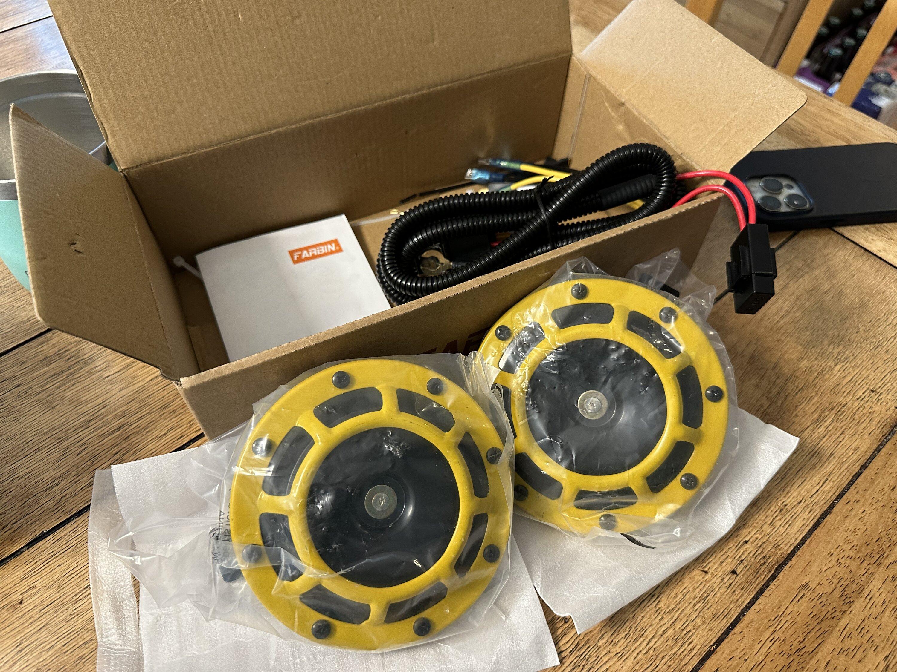

One month ownership - first honk - felt like I was apologizing.
New super tones ordered. It was actually worse than my ‘12 Leaf - which my wife and I joked for the decade we owned it.
Polar
Feb 16, 2022
1,123
2,074
C40, LE CY R1S
I’m ready - they’ll hear me now!

Here is my post video in this thread as well - It was a quick project indeed, just took my time and will revisit later, I’m going to add the factory horn back into the mix and add the 12V back to the frunk as the wire is still in the harness in the frunk.

I noticed that in your video as well.
My OEM horn is completely(for now) disconnected - I’m only using the two aftermarket horns which are coming on at the same time. So I cannot (yet) give you an observation as to the delay between the two.
I may hook the OEM back up eventually as I like how it still projects directly out the front.

The process @Nuclianba and I did is pretty simple - he just tapped into the existing wiring to add an additional horn. While I am using the OEM wiring as a relay trigger to active the relay hooked up to two new horns and 12V power.
The hardest part of the whole thing for me was locating the new horns. The wiring was straight forward.
again - pointing to style; I now sound like a Subaru… so louder; YES - style; questionable ?
