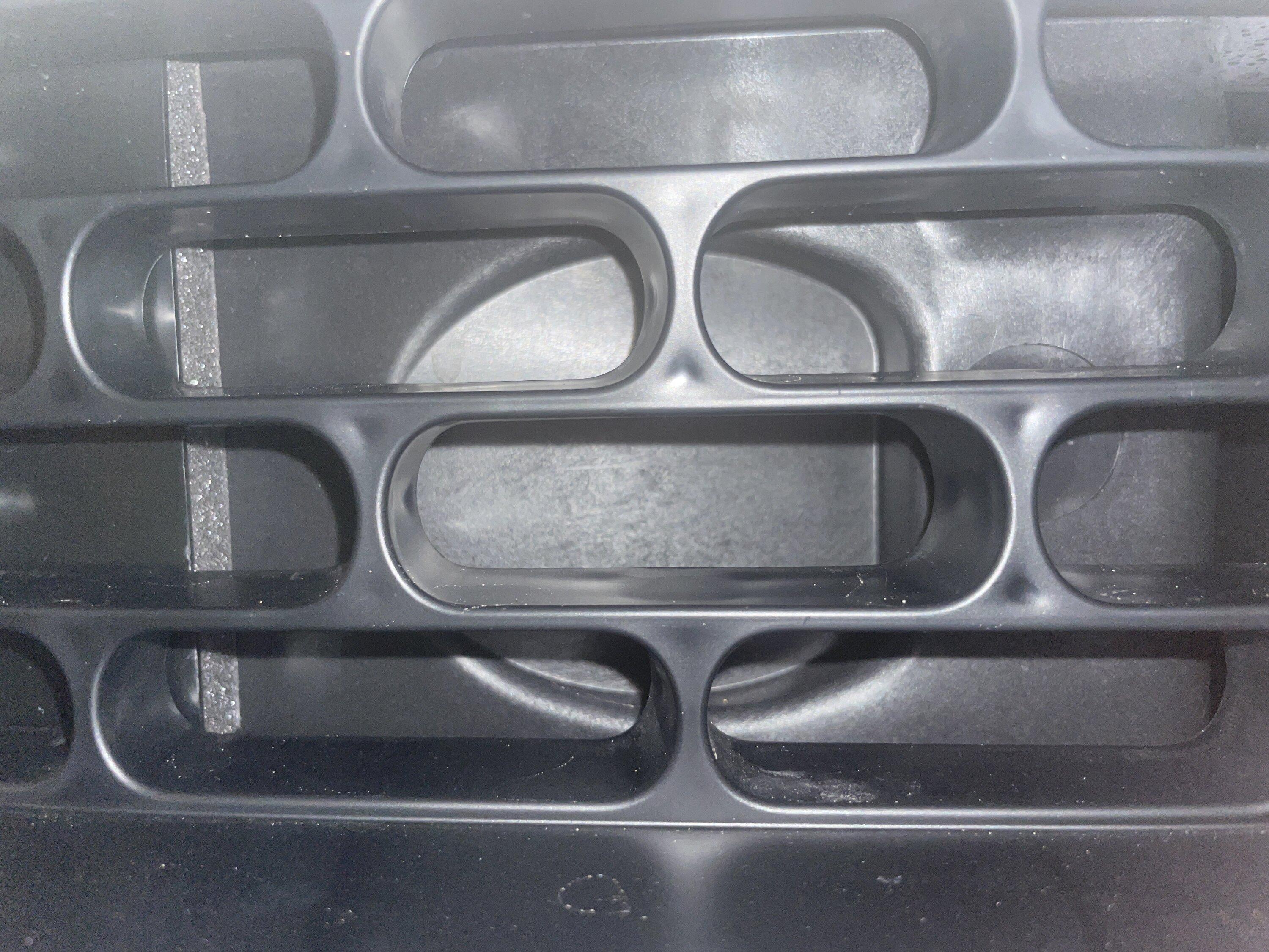

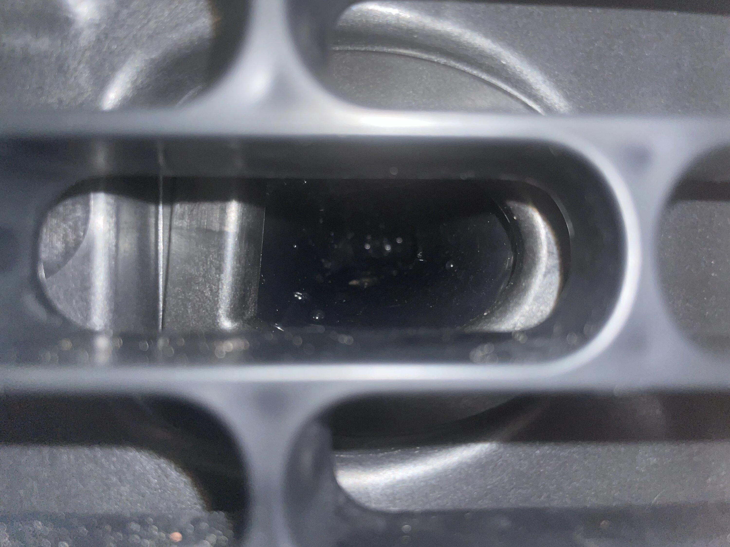

I just had Rivian Mobile Service out for the same problem (Feb+ 2023 R1S). There was a production line change at some point (he didn’t know exactly when but I got the sense it was in 2023) that removed the passenger side horn completely. An older Rivian has a two-tone sound, and the newer ones a single tone. That said all Rivian‘s are prone to horn water intrusion more than most vehicles, since the horns open up forward facing through the front grill.
I suspect this is why the owners manual recommends using the horn after wading through water. The mobile service tech also recommended doing it after car washes, etc.
Driver side pic with droplets. Pass side pic with blank.

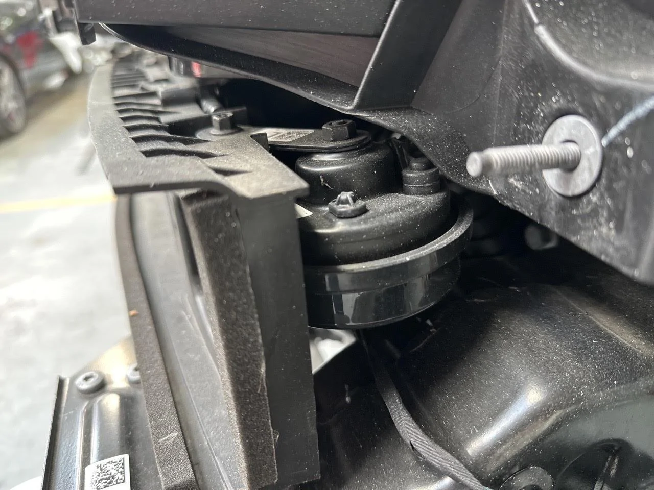

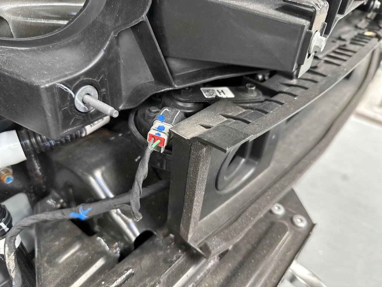

Ok, so I happened to have the front end apart while having some body work done. It appears from my shop worker that the factory horns are pretty tight behind the air intake ducting. There's no room for anything larger in the factory position. ?
Ouch! Well, thanks for the picture. That's very helpful!
