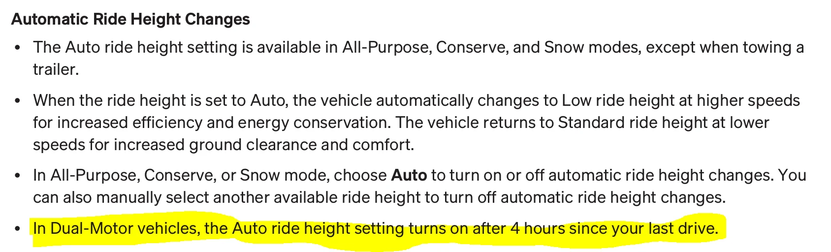

Interesting, thanks. I tested this today in my R1T and it definitely stays in the ride height setting until I change it. For years I kept it on the middle setting until there was complete reset by Rivian service to fix a cell modem connectivity issue. The service guy left it in Auto and for the past 6 months I've left it there so I don't have to think about it when I get on a highway.
Oh, it'll change back to auto. There is a delay, so you won't have to do it EVERY time, but I think it's like a 6-8 hr. reset.
Edit: It's 4 hours:
