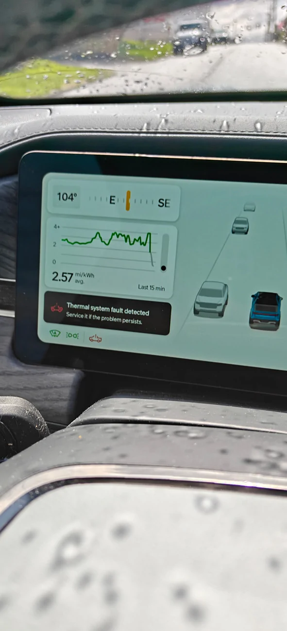

About a month ago, I started hearing a faint "High to low" moaning from within my R1T-Dual Large that would disappear when I turned off the HVAC. I figured it was time to change the cabin filter and left it at that. A week or so ago, I began getting a catastrophic error on my drivers console. "Coolant Fault Error - Seek Immediate Repair". It happened twice over the course of two mornings. On the first occurrence, I thought "This is way out of the blue, just an OS Glitch, reboot." In both cases was on a first start in the morning and a hard-reboot cleared the error (and generated the fault logs). After the second occurrence, I contacted Rivian Service (on 4/9), and that afternoon, the Canton Service Center (closest to me) requested I bring the R1T in and gave me a drop-off appointment for the morning of 4/10. The customer parking lot as PACKED; R1T's, R1S's and Amazon delivery vans everywhere! It was HOPPING!!!
I got there, the technician, Lance, listened to the sound (I was not imagining it!), he opened up the cowling in the frunk and the noise escalated. They took the R1T in for the repair and I was given a loaner for the duration.
The coolant degas bottle and related connections had come loose and/or broke. From what the intake representative told me, the coolant part in question may have had a defect in it from the part manufacturer.

Sadly, the same problem resurfaced this week, and I am taking my Rivian R1T back to the Canton service center again on Friday morning. About a week ago, I began getting that high-to-low moaning sound, though not as loud as the first time. I needed to use the garage for a carpentry project and backed the R1T out into the driveway, to discover a large puddle of viscous liquid on the floor. Shortly after, I began to get the catastrophic failure warnings on the dash.
Same problem as before. Felt confident that it was fixed correctly the first time.
Unfortunately, the confidence and trust are fading. Let's hope second time is a charm.

Yes; that was the repair they did this time last month, but the same problem has returned. Started getting the warning lights, again, yesterday and today.
