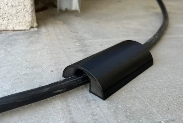

I pass my charging cable under the garage door. It just so happens there's a tiny gap there where the floor is lower on that side, so the weatherstripping is looser there and the door itself doesn't drop onto the cable.
Even with the seal, that spot was flagged by pest control as a potential rodent entry point.
I like the idea of the printed passthrough, maybe you can re-print it with a smaller-diameter tunnel?

I've been closing my garage door on my (hardwired wall-mounted, 25 ft) cables for years. My garage door does have a pretty thick and flexible bottom bumper/insulation strip, though. I wouldn't do it with a garage door that the metal door gets close to the ground.
I imagine that you could reach out to anyone printing them on Etsy and give them the diameter you want and they'd do it for you.
UNDOR Garage | Garage door cable protectors for EVs, garden hoses, RV
