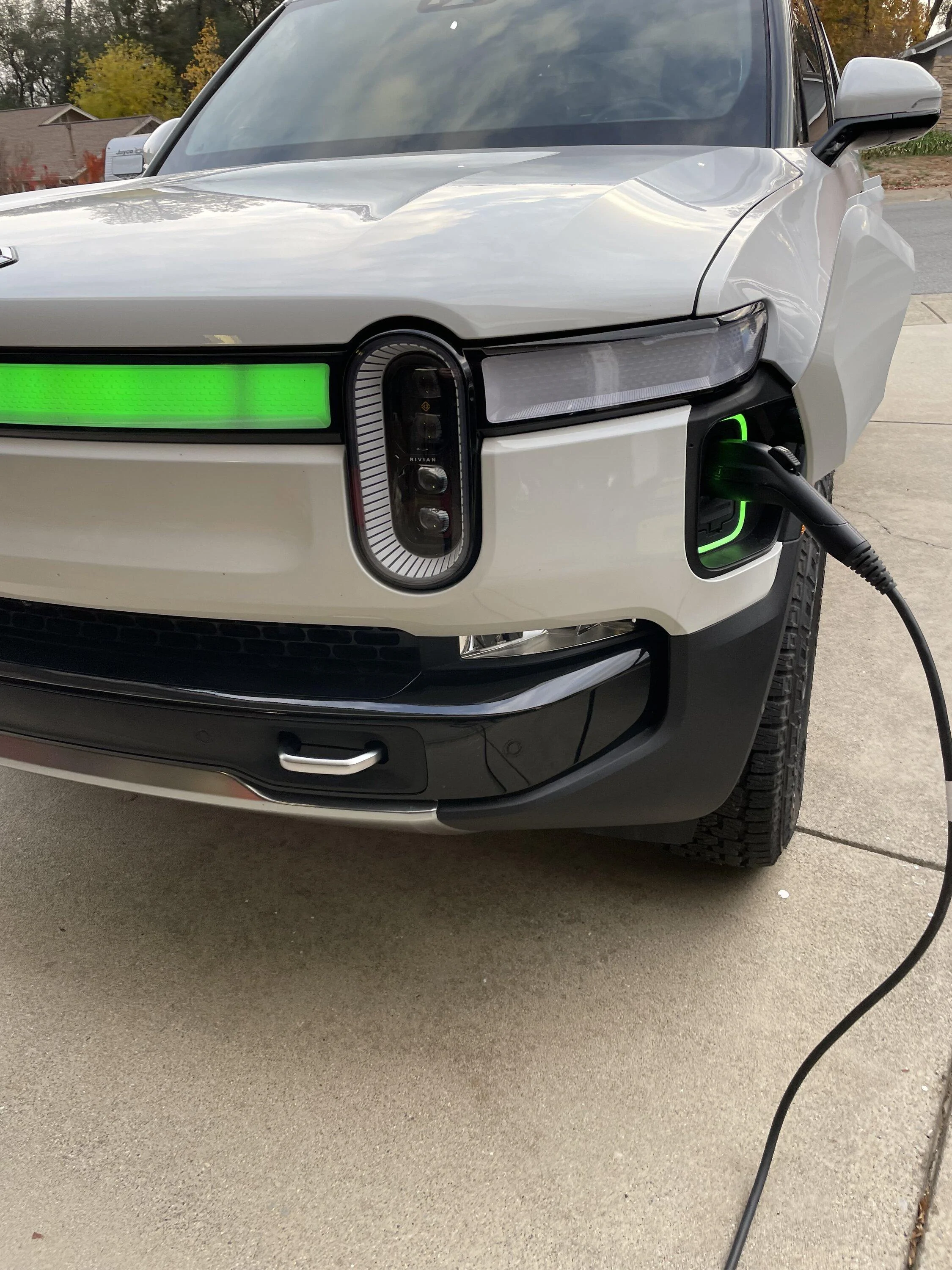

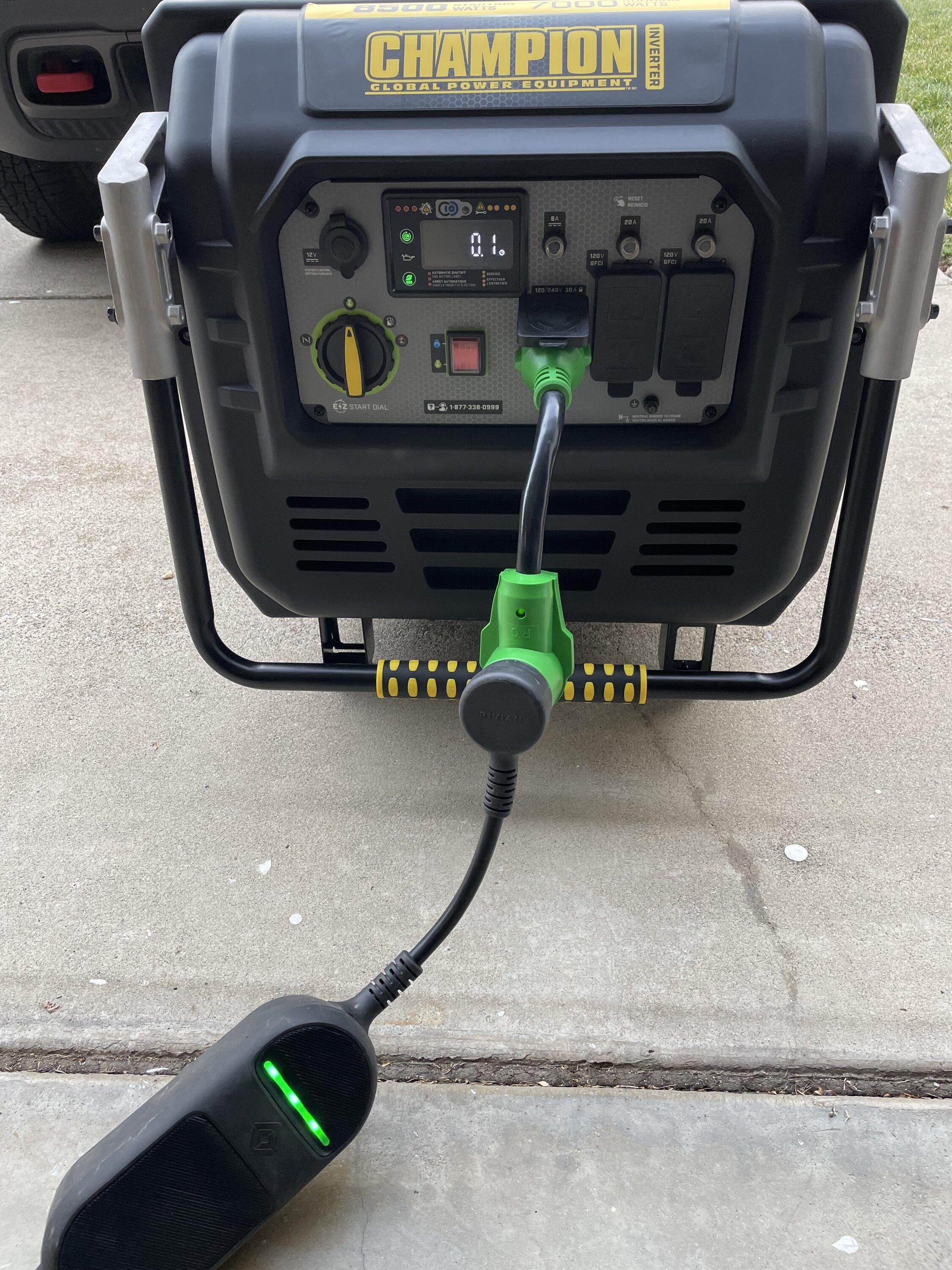

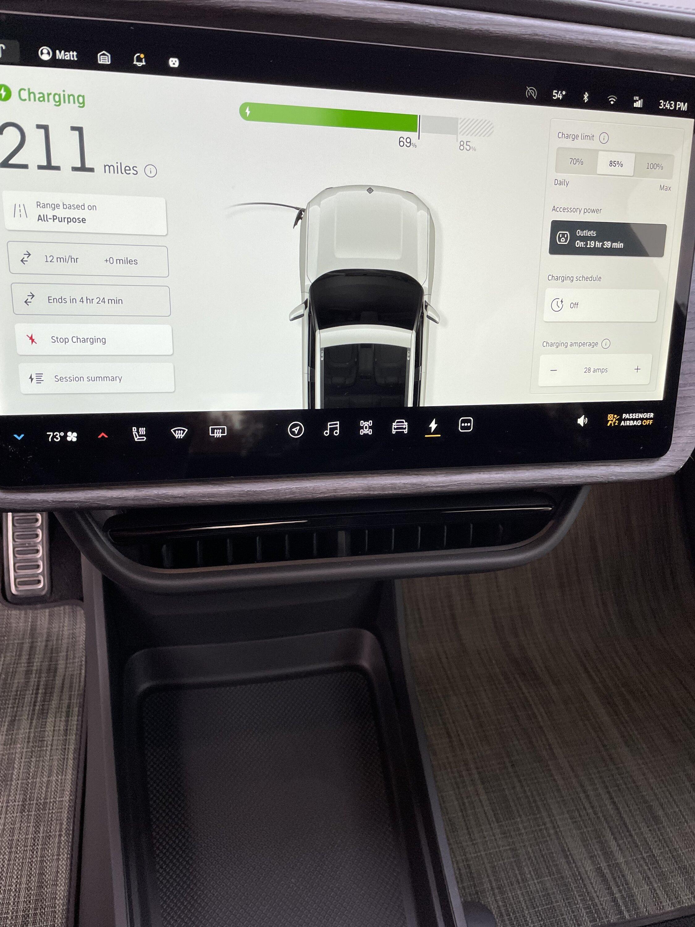

Ok, I did further research and got some feedback from Rivian (finally) on some of the limitations and basic needs of the mobile charger.
The truck does need a clean sign wave from an inverter. So, a clean wave and a true 240v socket is a must for the mobile charger to work in with the 1450 NEMA. It does NOT have to be a 50amp circuit (even though Rivian wants that) a 30amp circuit will do fine. Also, I could not find an inverter made with a true dedicated 50amp circuit; they don't exist.
I recently purchased a Champion 8500 watt inverter ( 7kw running) which is properly grounded to the frame. The 1450 NEMA mentioned by @miasm works well and I was able to charge my R1T at 28amps on the 240v mobile charger. It gave me 12-13 miles per hour rate of charge.
Also, the Champion 8500 is built to compete with the Honda 7000Ie. I will say (so far) the Champion has 1500 more peak watts and 500 more running watts than the Honda and....it is just as quiet!! I have run both the Honda and the Champion and the Champion is as quiet with more power. AND.... it is 2400 bucks (I got mine for 1400 on Black Friday), made in the USA and warranted for 3 years with great Customer support. I recommend it....unless you want to blow 6 grand on a Honda
Pics to follow...

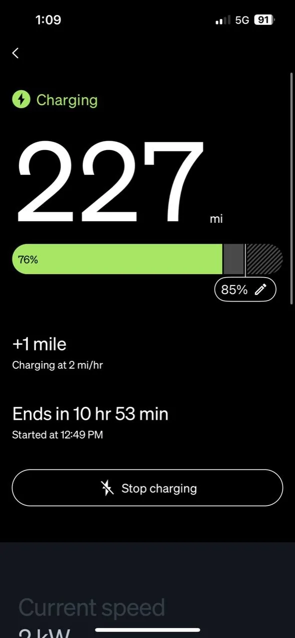

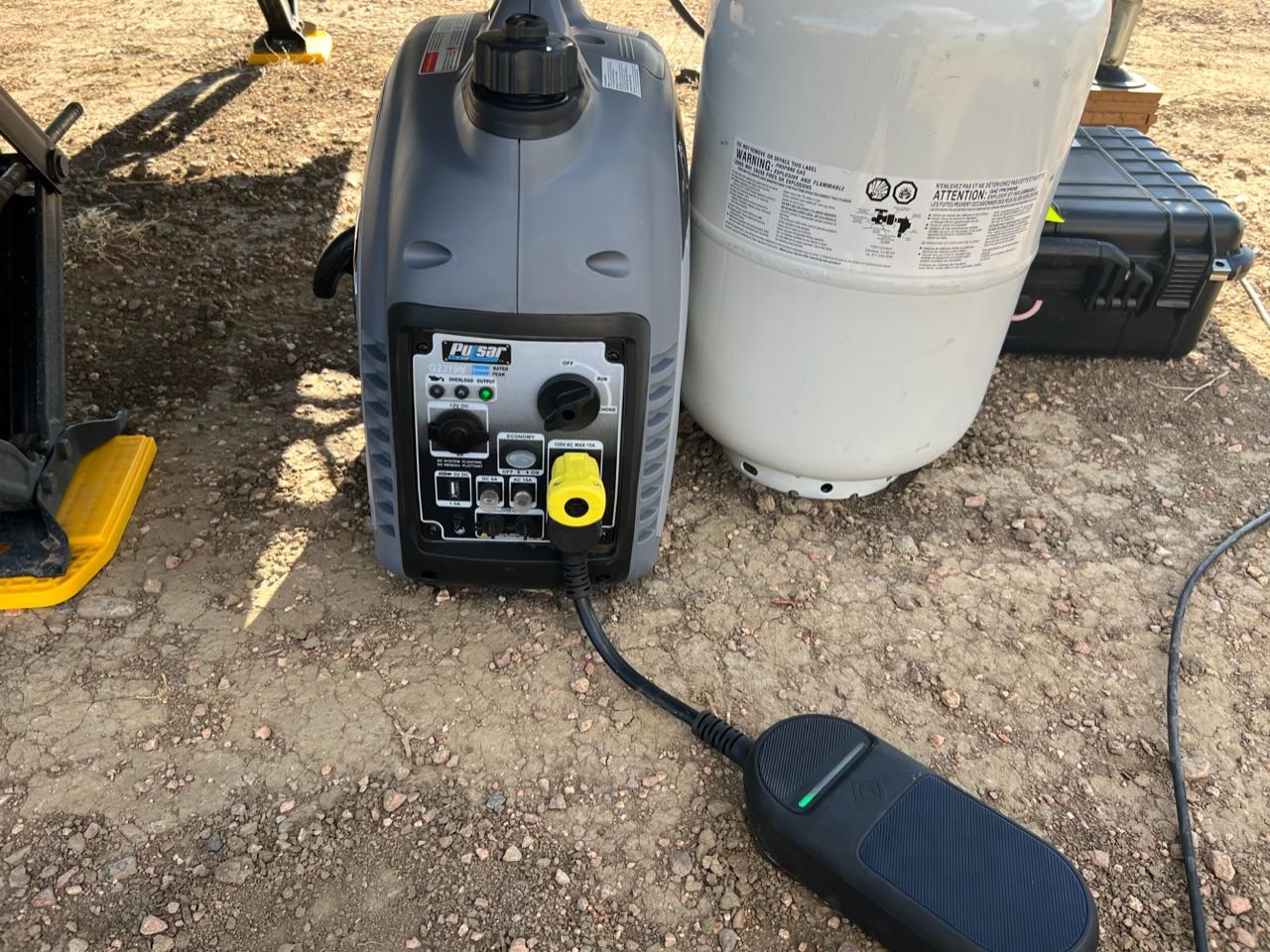

My $300 Pulsar 2300 will charge the Rivian at 120v/12amps or 1.44kw. Very slow level one charging but given enough time and gas it would work. I had to make a neutral ground bonding plug since the generator has a floating ground like most portables. Without it the portable charger detects the floating ground and won’t charge.
