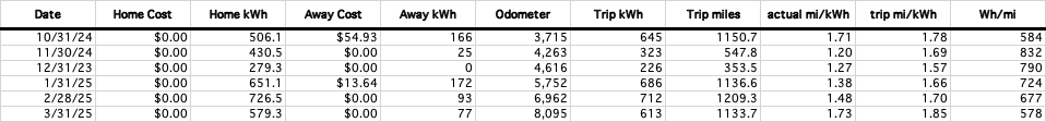

Your trip meters don't tell the whole story. Like Tesla, they don't seem to account for vampire drain when the vehicle is off or charging inefficiencies. I have a power/energy monitor on my home EVSE and track all charging sessions away from home as well.
Based off the trip meter on the vehicle, my efficiency is 1.72 mi/kWh, but based off the actual electricity pulled from the grid to recharge the battery, it's 1.49 mi/kWh. Most driving is at 70+ mph and I have all-terrain tires on the R1T, so I have pretty poor efficiency overall, but just pointing out the difference between the two numbers.
As mentioned, Tesla does the same. On my Model 3, with 120,030 miles, the trip meter reports an efficiency of 3.72 mi/kWh vs an actual efficiency of 3.11 mi/kWh.
If one is tracking driving efficiency, I don’t think actual power pulled from the grid during a recharge is relevant. Especially when cold, the initial power coming in goes to cabin and motor conditioning (heating), not to the HV battery. I have watched mine spend the first 12+ minutes of a charging session doing this, before it ever starts sending electrons to the battery. This can be tracked on the in-car display. Therefore, take the home energy bill with a grain of salt. It will always show more energy than actually ends up in the HVB. Because of this, factoring in energy used during a charge session will skew any actual driving efficiency calculations.

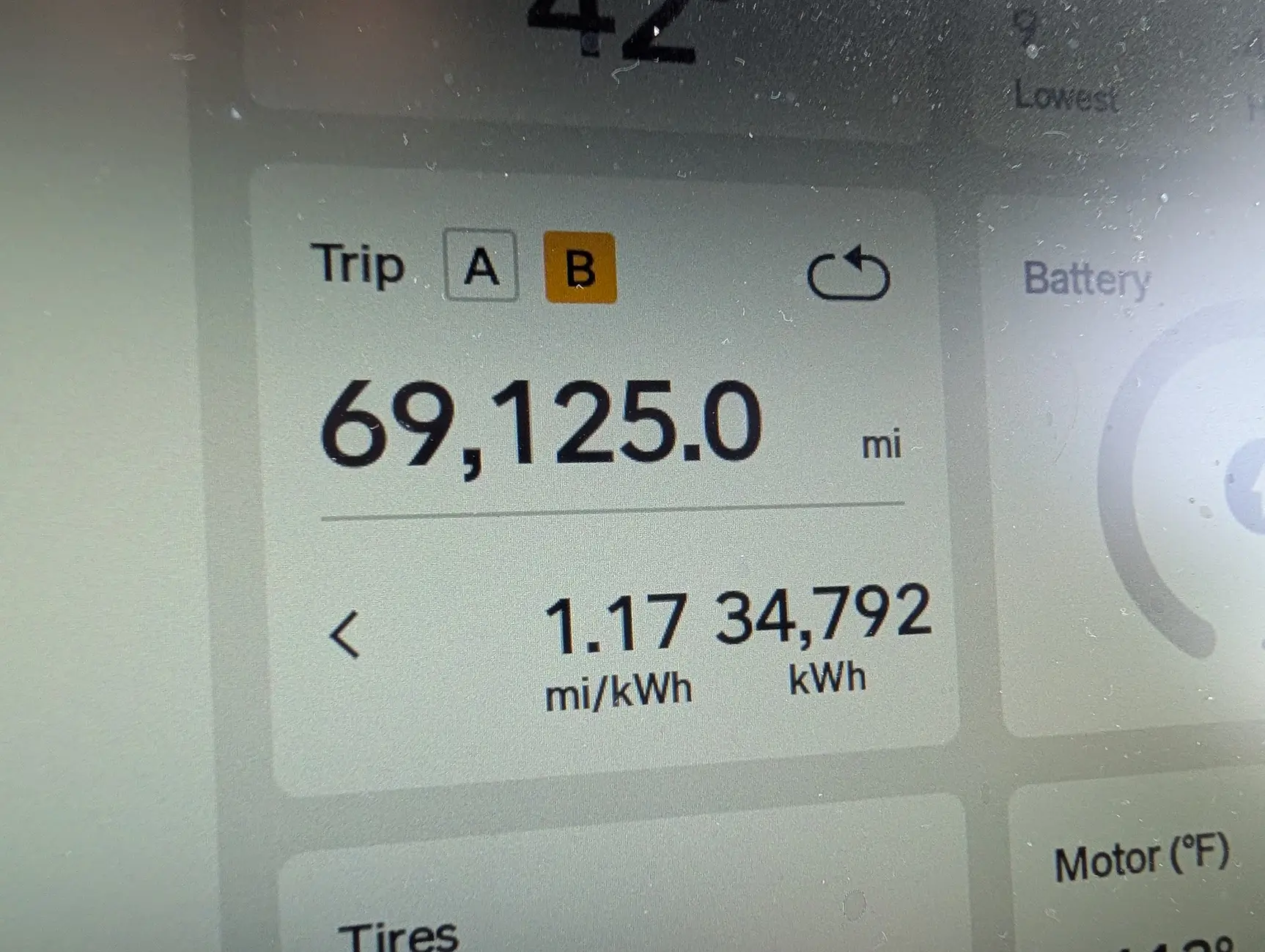

I do not understand my lifetime efficiency numbers. I have 61,918 on my 22 R1T. It shows I have used 29,852 KWH and my lifetime efficiency is 1.37 according to trip B on the truck. IF you divide the two numbers I get 2.07. This seems somewhat accurate based on what I see while driving. summer is quite a bit higher and living in MN the winters are cold and windy so it is a lot lower. Can someone help me understand the math? I am usually good with these type of things.

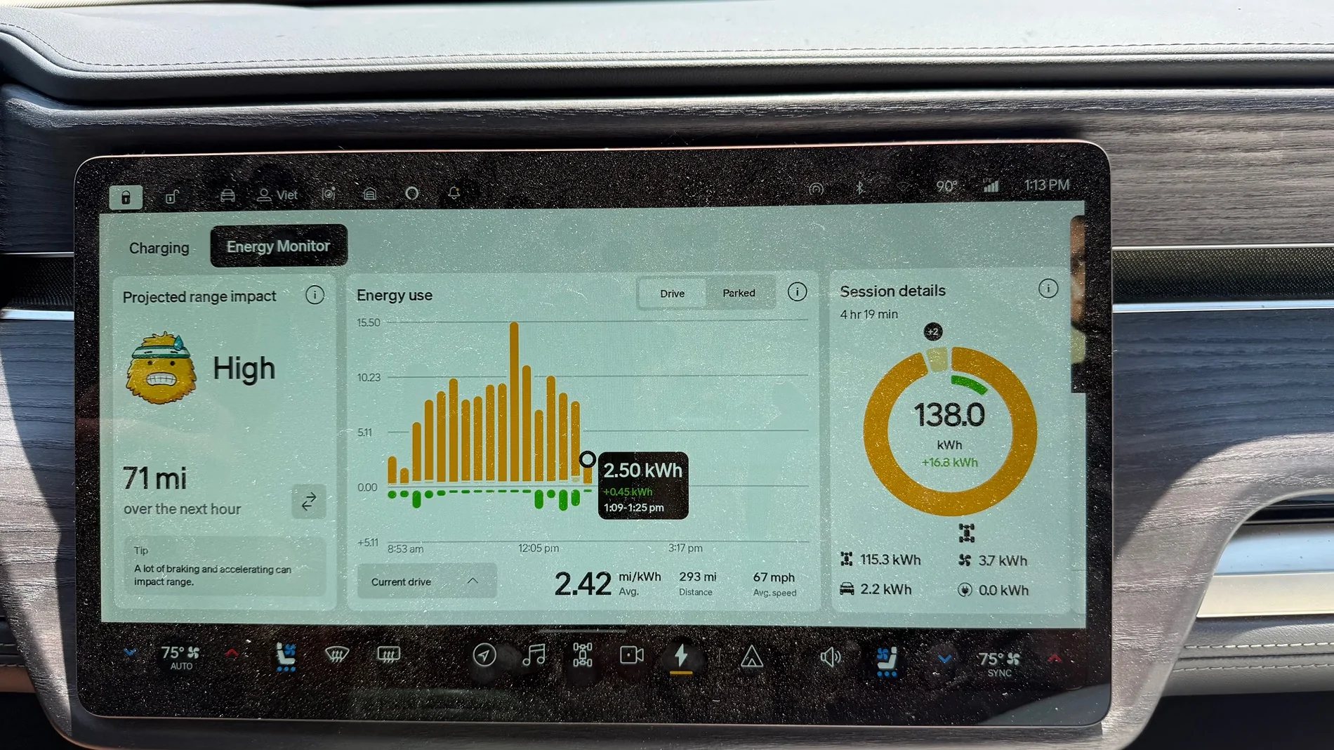

First long trip on my max pack r1t from LA to Camp Edison. Got about 2.42 mi/kwh over 293 miles. Pretty impressed with the range.
