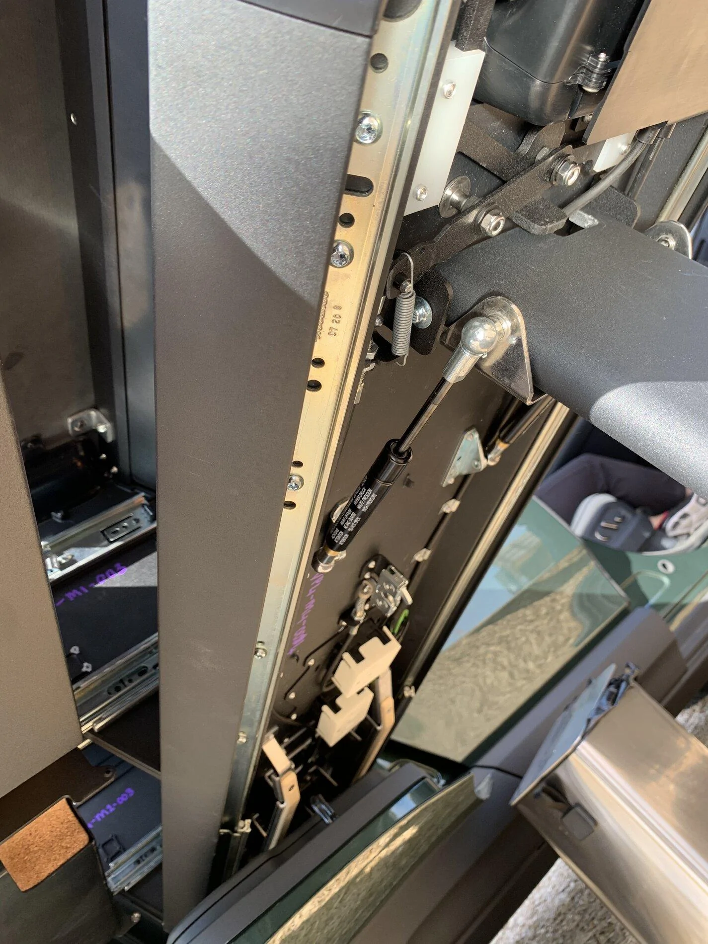

I saw a photo today (which for the life of me I can't find again! :swear:) which showed the inside of the gear tunnel with the camp kitchen fully extended. This showed the power cables were coming from in the middle of the floor of the gear tunnel instead of the 12V/120V plugs. I wonder if this is a separate circuit with a different limit?
I saw that too, in the first Mile thread I think?
Specifically it looks like the Gear Shuttle plugs into both the 12V DC plug and 120V outlet in the Gear Tunnel. Presumably the induction stove is 12V and the Gear Shuttle outlets share the 120V circuit?

Specifically it looks like the Gear Shuttle plugs into two 12V DC plugs and that's what powers the AC on the shuttle (and presumably what powers the inductive burners as well). I'd guess that's a different circuit than the AC outlets?
The cable going "into the floor" is actually just into the bottom of the gear shuttle. The cable must be protected and captive so it can safely slide in/out with the kitchen and not abrade on anything. You see similar systems in industrial applications and CNC or 3D printers.
If you look closely at the side you'll see the gear shuttle plugs into both the 12V and 120V outlets (one near each gear tunnel door). I would assume the 120V is used by the stove, and then perhaps the LED lighting is run off the 12V.

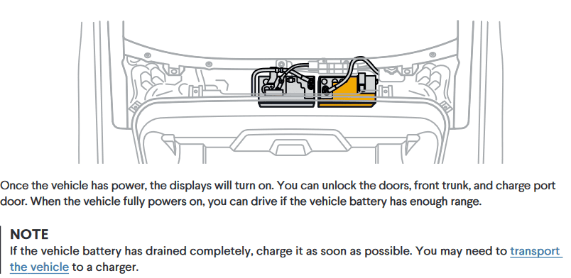

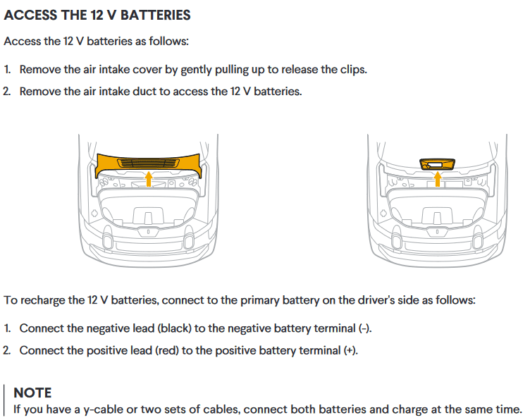

Actually, we do know, now, since the Owners Manual is posted on Rivian.com. They 120V outlets are limited to 1500W.
The manual also states that there are two 12V batteries between the frunk and cab. I don’t recall it specifying the chemistry type. I would assume they are at least AGM, but they could be lithium.
Rivian R1T R1S Max output from the 110v plugs in the bed 1632774899439
Rivian R1T R1S Max output from the 110v plugs in the bed 1632775047905
The "y-cable" and "primary battery" to me says that one is a starting battery and the other is an entirely separated secondary system, and that one is what powers all of the onboard accessories. But if they aren't at the same voltage it's not a great idea to use a y-cable on them.
