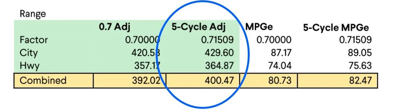

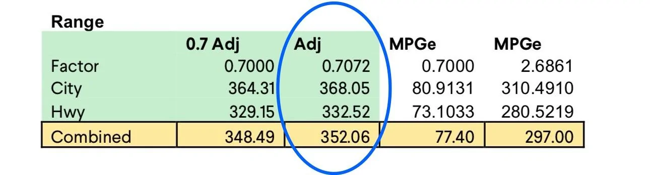

We already knew the usable capacity from the EPA docs. I did a video on that.
So it's 11 kwh (like the EPA docs say) usable. I say it still might be worth it for some. This test still doesn't tell us the value, which I have said will be on longer road trips in the form of public charging time savings.
11kwh is 11kwh lower efficiency lower the additional range. Higher the efficiency the higher the difference.
The large and max pack have the same highway efficiency... And it doesn't appear that the charging time is better in any meaningful way. As far as I can tell the only potential benefits beyond the 11kwh are in conditions similar to the city test cycle.
