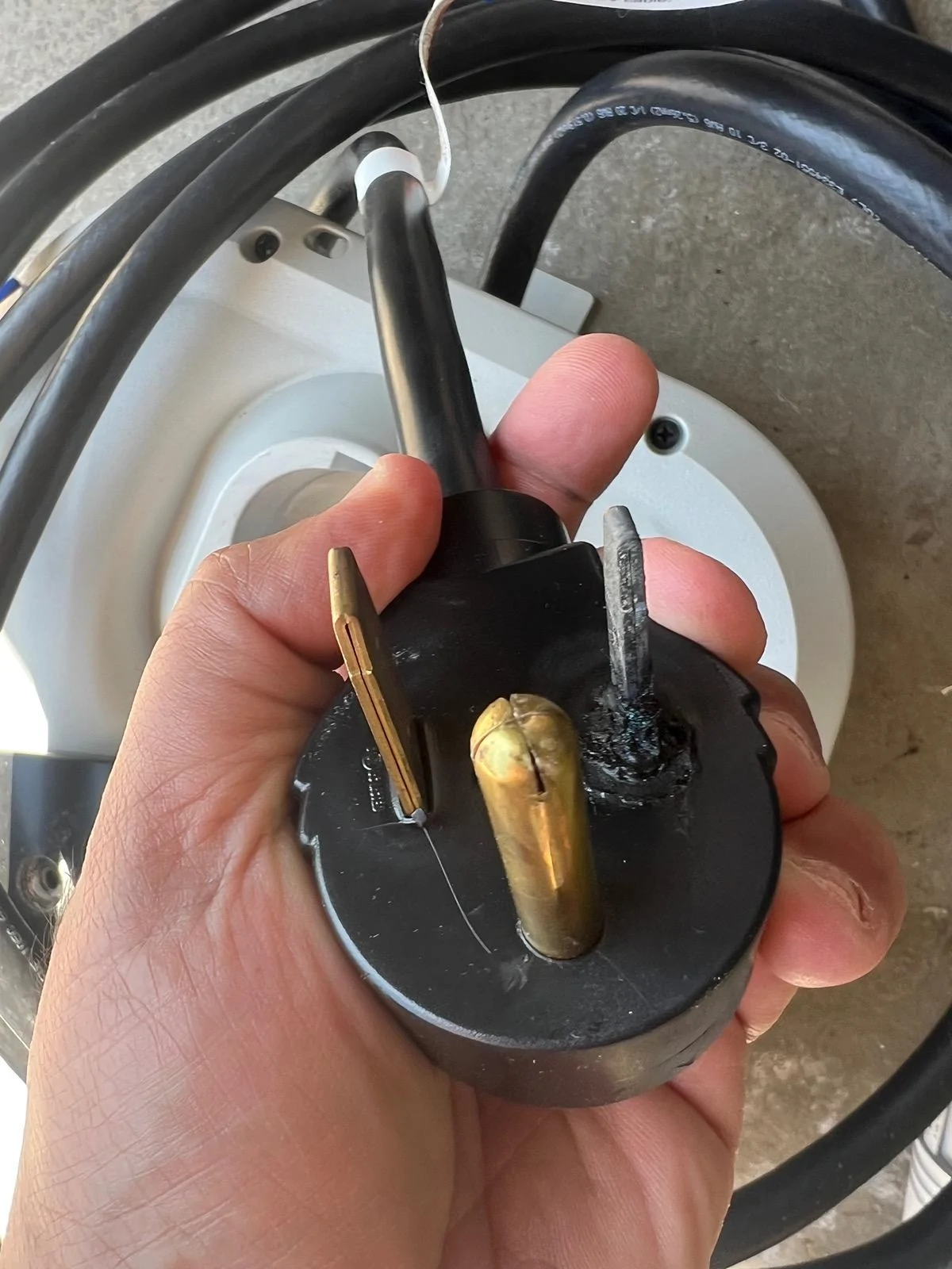

Is this salvageable?
Might be if you remove the pigtail and hardwire it. #8 wire is generally 40A ampacity. If he left it in place, you should swap to a 40a breaker from the 50a.
I already upgraded to a Charfgepoint Homeflex and changed to a #6. Just wondering what do do with the old charger.
recycle it

Professional
You could replace the plug with a new one. Maybe you have a friend that has done something like this that can assist.
Yes,
had the same issue due to a cheap outlet installed by a certified EV installer company. Anyway, they came back, replaced the outlet with a Hubble one, and provided a new cord for ChargePoint. Not an issue, they have many spare cords as many installations these days are hardwired (preferred), but they order ChargePoint units with plugs. I also called ChargePoint and they were willing to replace the whole unit (still under warranty). But I choose to replace the plug only.
