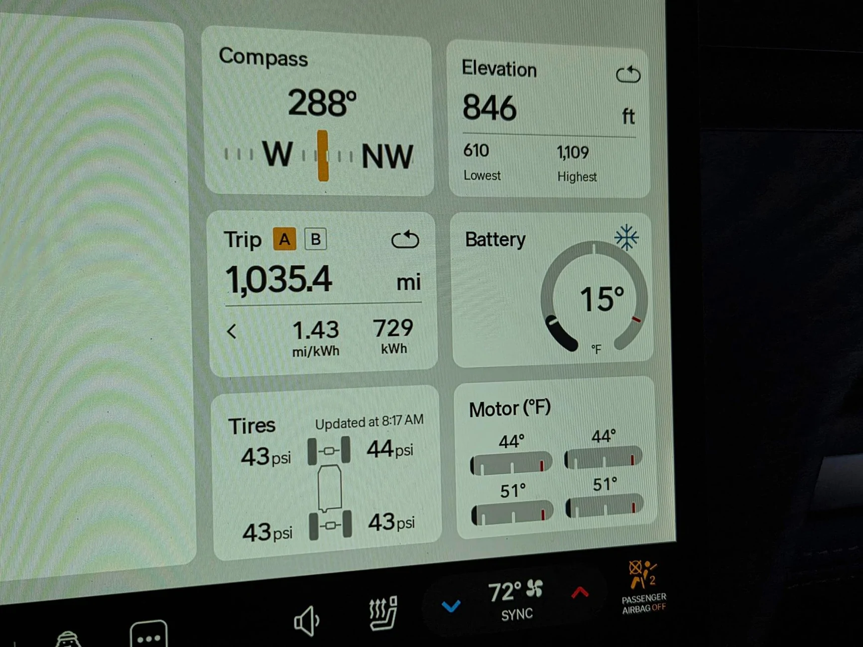

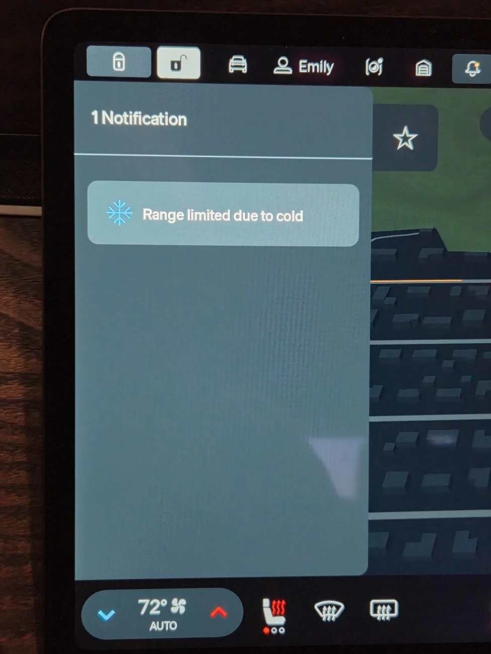

I agree, battery temp seems to be the most important factor when it comes to efficiency. When I leave for work in the morning (truck is in a garage, plugged in and preconditioning each morning before i leave) I consistently use between 1-2% to get to work. If it's warm (above 60F or so) I'll use the same to get home. However when cold it'll be double that. This past Monday our high was 3 but it felt much much colder due to high winds. I left the truck unplugged all day to see and it used 3% just heating the cabin for around 30 minutes for my scheduled departure time and another 11% to get home. The battery was 15 degrees, and I had the "range limited by cold" message.
