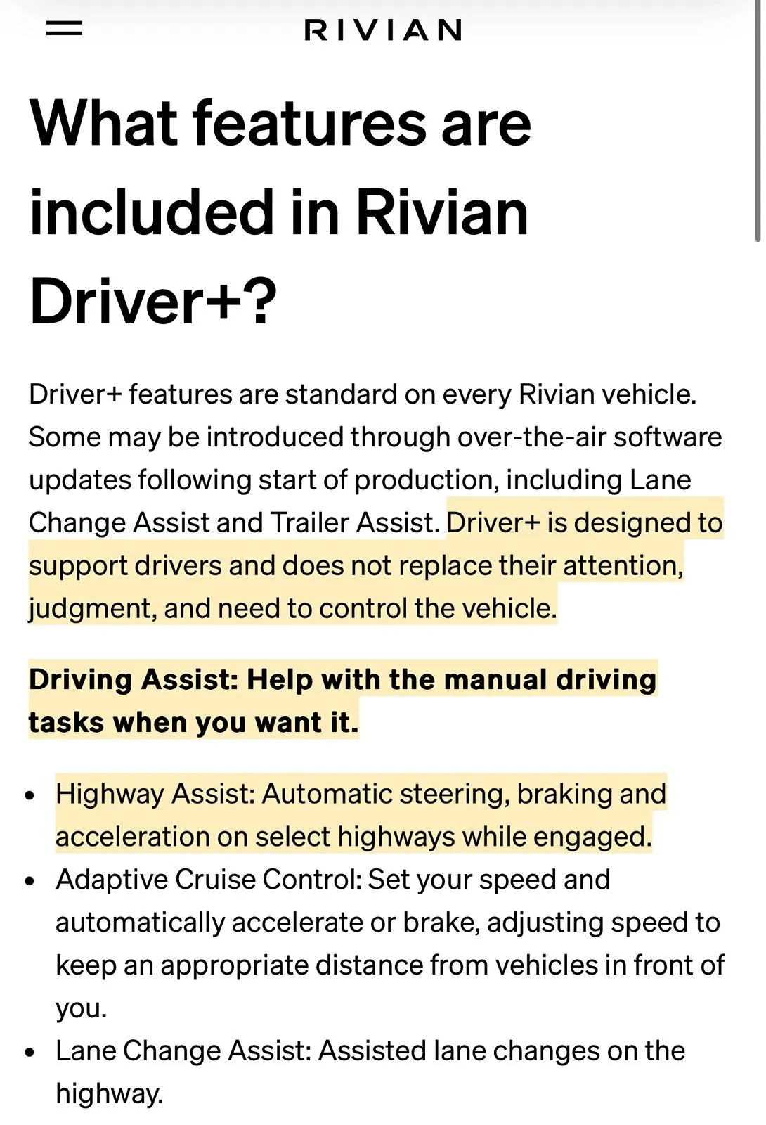

Edit: @VSG Not sure what you were trying to differentiate. Per Rivians website, Driver+ is the overarching system. Highway assist is a sub category within the system.
That's correct - Driver+ includes lots of different things. Some you can turn off, some you can't turn off, like Forward Collision Warning and others. You are ALWAYS using Driver+.
Highway Assist is the feature that many people seem to equate with Driver+, but in reality it is only one (small) part of Driver+. Highway Assist is only available on some ... highways. Not everywhere. And you have to explicitly turn it on when you want to use it (down press twice on the right stalk when available).
If you are using Highway Assist, then SAY you are using Highway Assist. If you say you are using "Driver+" then well of course you are, but it is ambiguous to just say Driver+ since that is ALWAYS ON.
If you can't properly name the feature you're using, it makes your problem report ambiguous and less credible. The Highway Assist feature may have some problems in some use cases, but overall Driver+ is seamless and effective.

Absolutely not semantics. Highway Assist is a specific function. Calling everything "Driver+" is not only lazy but it indicates you don't know what you're doing.
While the Original Poster in this thread made it abundantly clear from context that he was using HA (hands off, etc.), your post did NOT. You just said Driver+ and didn't mention hands-free or anything like that. For all we know you could have been using cruise control (ACC) which would have been completely consistent with what your post describes. This is what you said:
I was using Driver+ and was approaching a sudden slow down on the freeway. Initially my R1S started to slow down, but then suddenly it took off like I had fully pressed the accelerator (I did not) as if there were no cars stopped in front of me, I had to slam on the breaks with all my might. I managed to stop, but because of my sudden acceleration and sudden breaking 3 cars behind me collided. None of this would have happened if I hadn’t been using Driver+.
There is no indication here that you were using Highway Assist. So were you or were you not? Did you have unexpected behavior with ACC or with HA?
